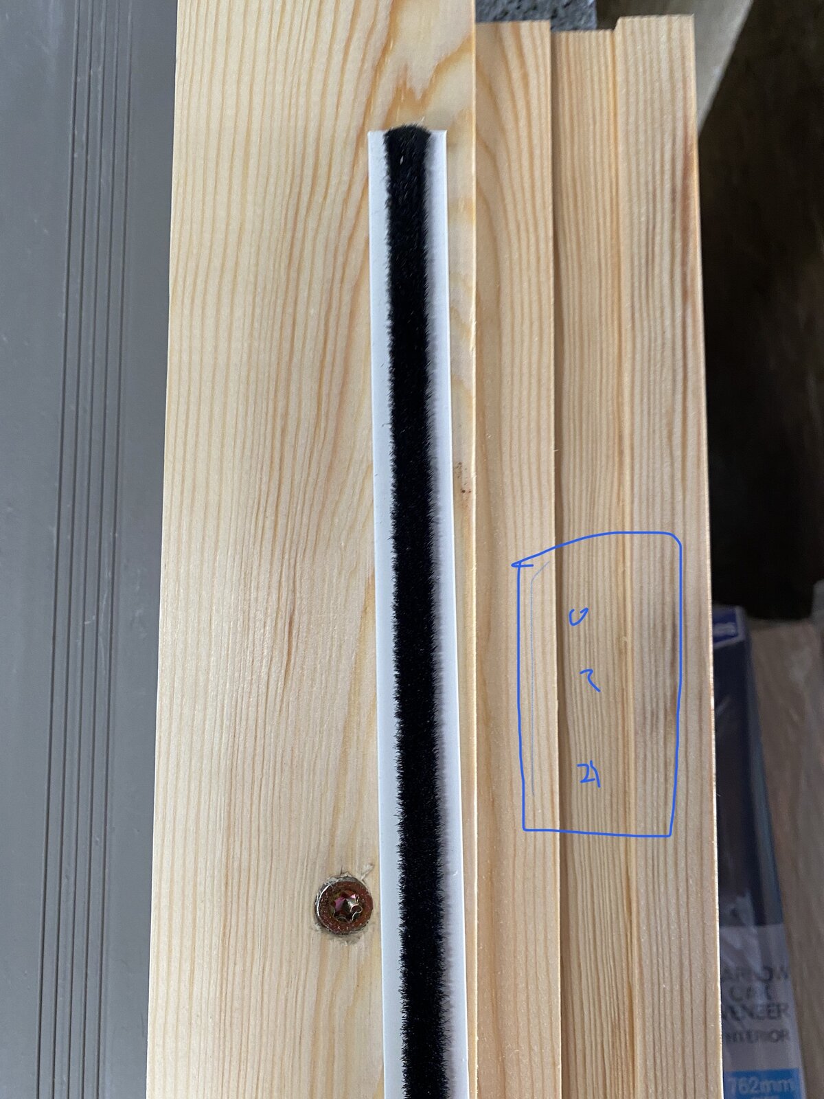

Hey all,
Fitting my first fire door today.
As per the picture, it’s got an intumescent strip and smoke seal.
My question is about the hinges. Normally I’d rebate them, but won’t this interfere with the strip?
Ive got fire hinges, but they don’t have their own intumescent stuff.
Should I just plonk the hinge on without rebating it?

you rebate them, and put an intumescent pad under each leaf of each hinge.
you can also get intumescent pads and wrappers for mortice locks and other door furniture.

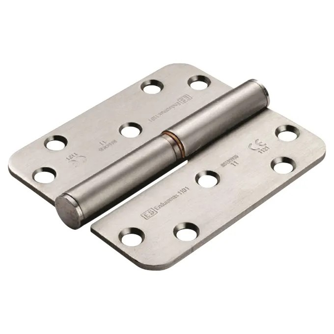

have you bought the hinges yet? I favour lift-offs, as it is very wearisome taking a heavy door off and refitting it.

...have you bought the hinges yet? I favour lift-offs, as it is very wearisome taking a heavy door off and refitting it.
Fire door hinges are normally bearing types these days, so I very much doubt you'll find lift off fire rated hinges (or at least I've never seen them specified)
OP - the intumescent requirements are partly down to the rating. Is this a 30 minute, 60 minute or 120 minute opening?
Intumescent pads for the hinges require the hinge recesses to be about 1mm deeper to accommodate them.

Thanks. I had to get bearing hinges as I couldn’t find lift offs. It’s an FD 30 door between the garage and the house in my extension.

I have them almost exclusively.
Also branded as Eclipse, Union, Royde & Tucker, etc
Though I suspect they all come from the same factory.
Prices vary.
Example
https://www.ironmongerydirect.co.uk...hinge-100x88x3mm-right-hand-satin-zinc-139999
I prefer them in stainless, or the difficult to find PVD finish.
Mine have a phosphor-bronze bearing (not balls) and swing like silk.
Here we go again, I've never got an answer to this even off supposed 'experts' and manufacturers .... what is the point of an intumescent pad behind a hinge - the whole point of intumescent material is to expand and seal gaps?
Just cut the strip to the hinge.
You might as well ask what the point of wrapping lock bodies in intumescent "paper". It is not only to fill gaps but also, because the intumescent compound is an insulator, to reduce transmission of heat through metal components. That was the official line I was given on a fire safety training course a few years ago as being "current thinking" at the time. So whilst I don't like them (they makesesting the hinges into recesses more awkward), I do fit them.
BTW the tutor was a serving fire officer, so Iexpect he knew his stuff. Also, if you are in room where the intumescent strips have done their job in the door, you are probably dead, because they only work at very high temperatures - their function is to slow the spread of fire, enabling people to escape.
