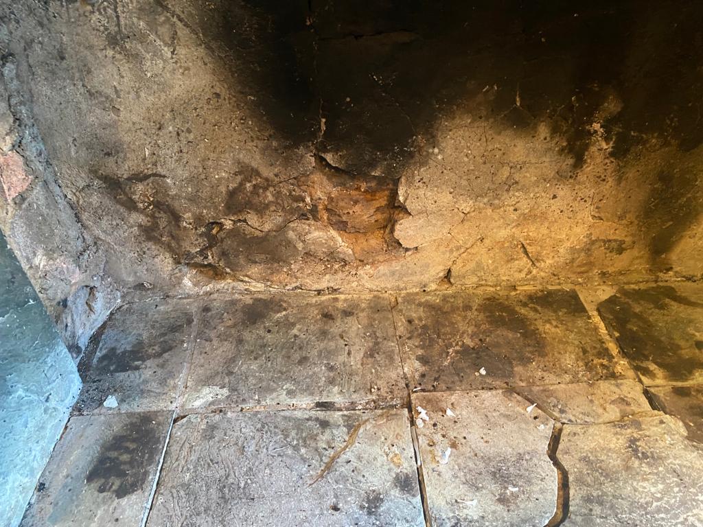

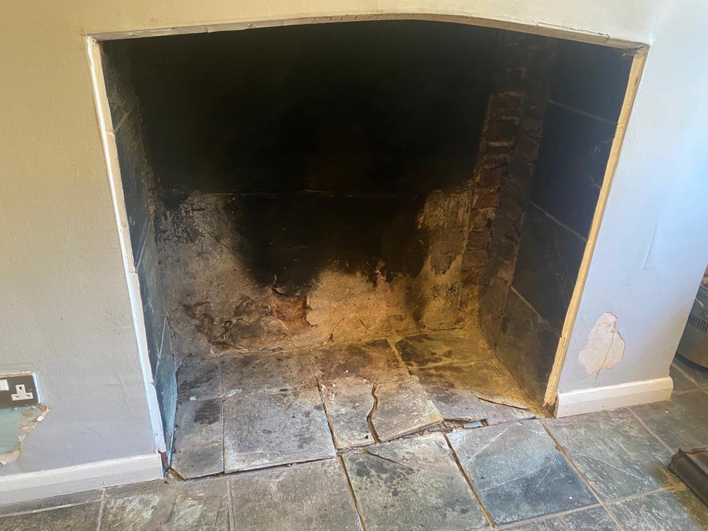

Hi all,
I wondering what options do I have to make my fireplace look good? The slate tiles are cracked and the back the fireplace seems have a layer of cement ( and cracked) with some tiles on the side.
I am happy to keep the brick look inside the fireplace but I am wondering if the bricks are in too poor a condition to make good. The other option I can think of is plastering the whole opening so it is clean and tidy. What options do I have and which one would be easier or cheaper to do ?
Many thanks

That opening is crying out for a new wood burning stove.
Maybe try and use the tiles on the wall to replace the hearth tiles.
Then clean up all the brick work. You need need to quick aggressively sand or grind all the cement and dirt off the brick work and then repoint but it would probably all scrub up nicely. Failing that, yes you could plaster it out on three sides as a diy job.
Had the same problem a few years ago so I got some fire proof cement from one of those shops to replaster the back and then fitted a colourful marble surround and hearth. Not cheap of course but looks an absolute treat when finished.
Thank you! That is very helpful advice! I guess even if I want to plaster all the sides, I still need to get all the cement and tiles off the side so I might as take them off and see if I can make them look good first ?
