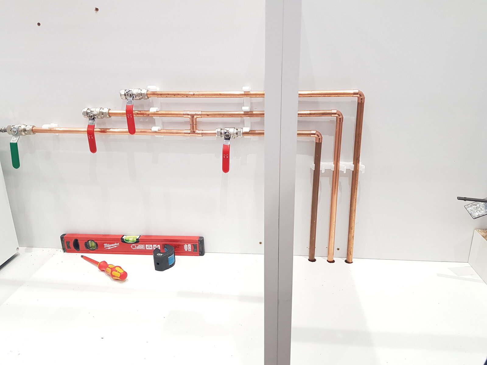

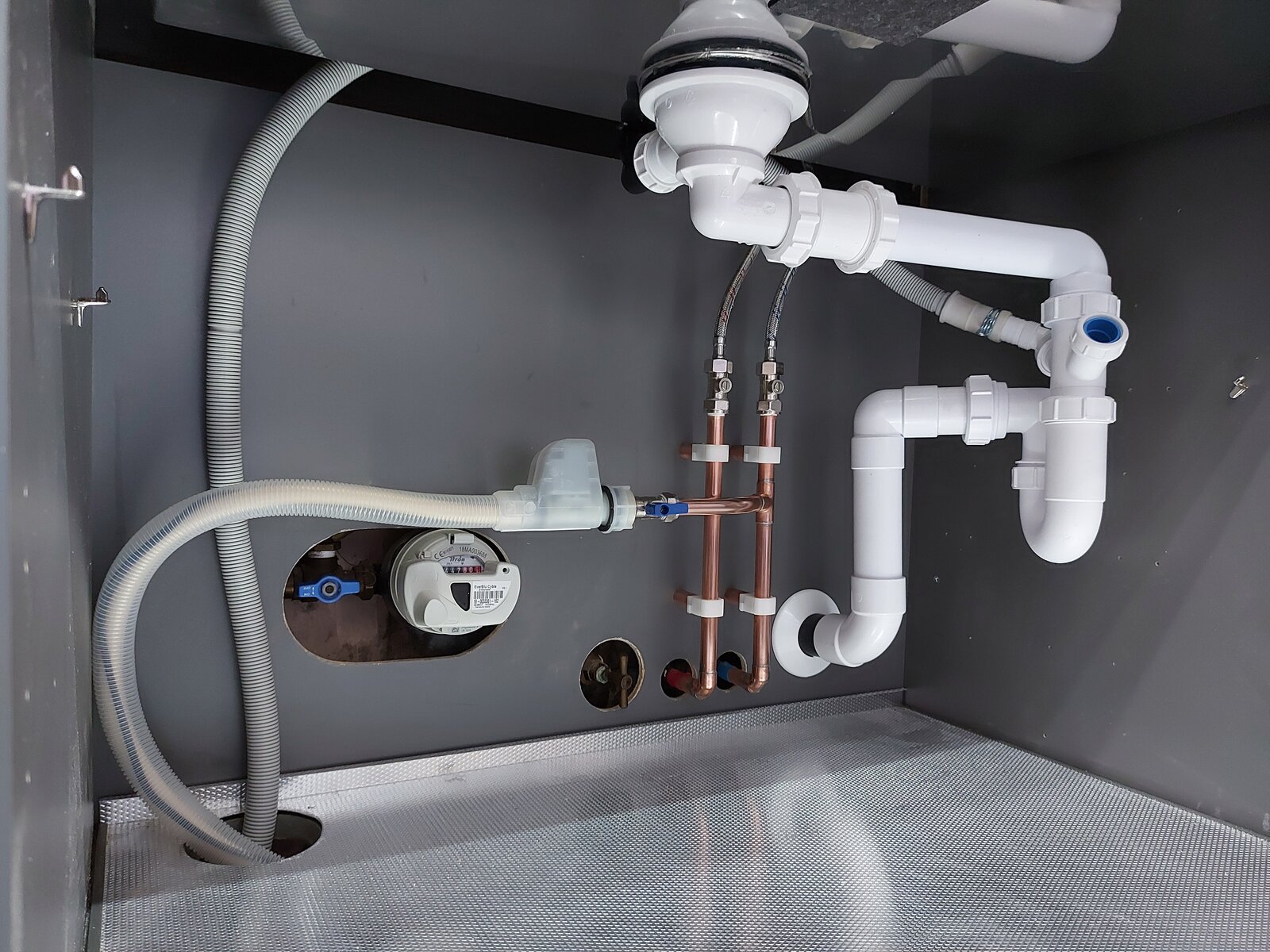

I like to bring in all pipework low down into units, usually aiming for hot and cold to be directly below where taps will be.
I did such a nice job, brought the pipework up in the corner unit,
and then found that the pullout unit for the corner needed to go right where those pipes came up. Had to cut them out and bring them up in the sink unit.

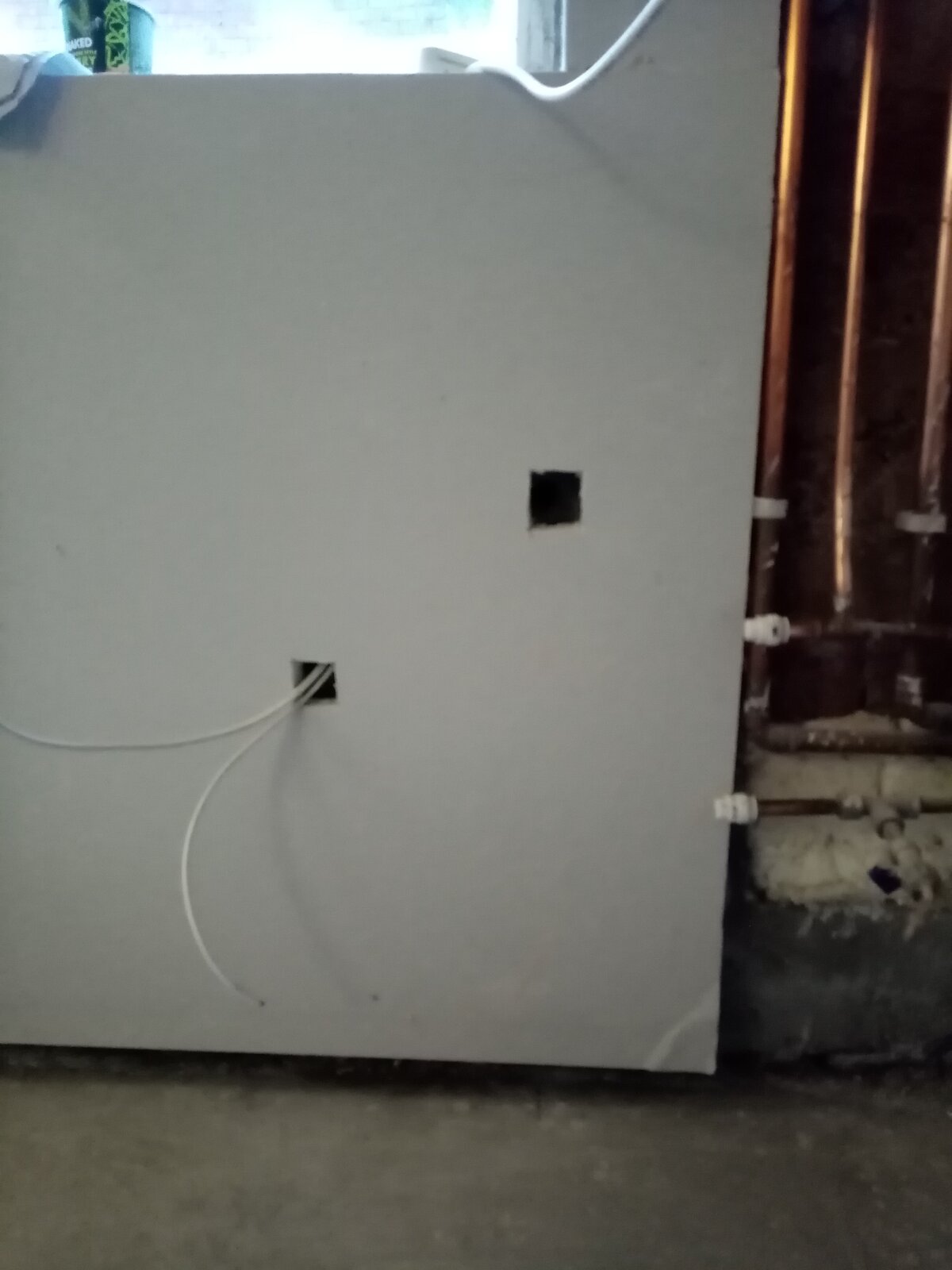

Hi, thanks for the replies
Currently, the cold feed is 30cm above current floor level, and hot feed is 50cm above floor (as can be seen in pic with stop ends on)
The edge of the sink cabinet will be just to the right of the cable coming out of the wall
Is it best to just keep them at this level and bring them across to where the sink unit will be and pop an elbow on and cap them off for time being?
Just extend cold feed across and bend hot feed down until at the same height (hot on left and cold on right). Bend pipe or use elbows to bring pipework into base unit and fit isolating valves. Carry on when kitchen is fitted.
Depends on where you want to place any shelf in the unit.
Move them along and bring the cold up to meet the hot and then put and elbow on them both and add more pipe so there is tail on each pointing out towards the room with a cap on each. Then as the unit is being moved back, cut a hole where the pipes will fit through, do the same for the sink waste. Fit the carcase then cut and elbow the supplies up with an ISO on each ready for the sink, adding any tee's for appliances or outside tap etc.
