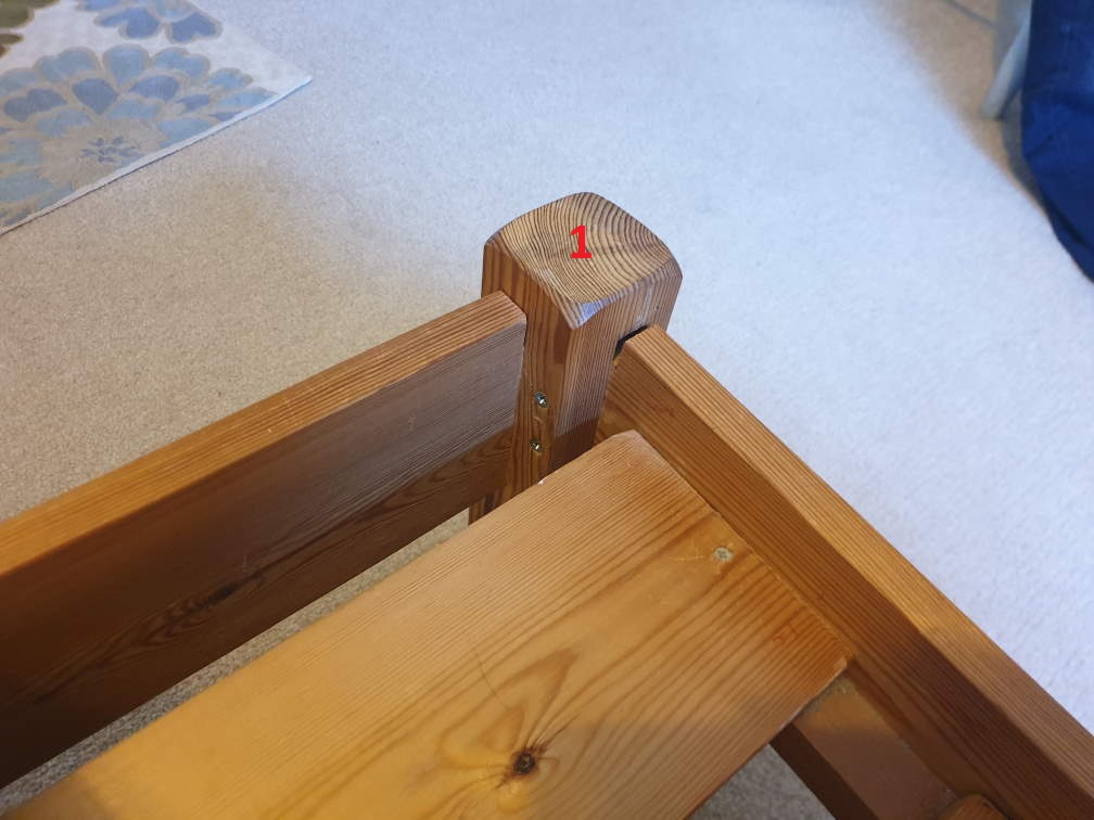

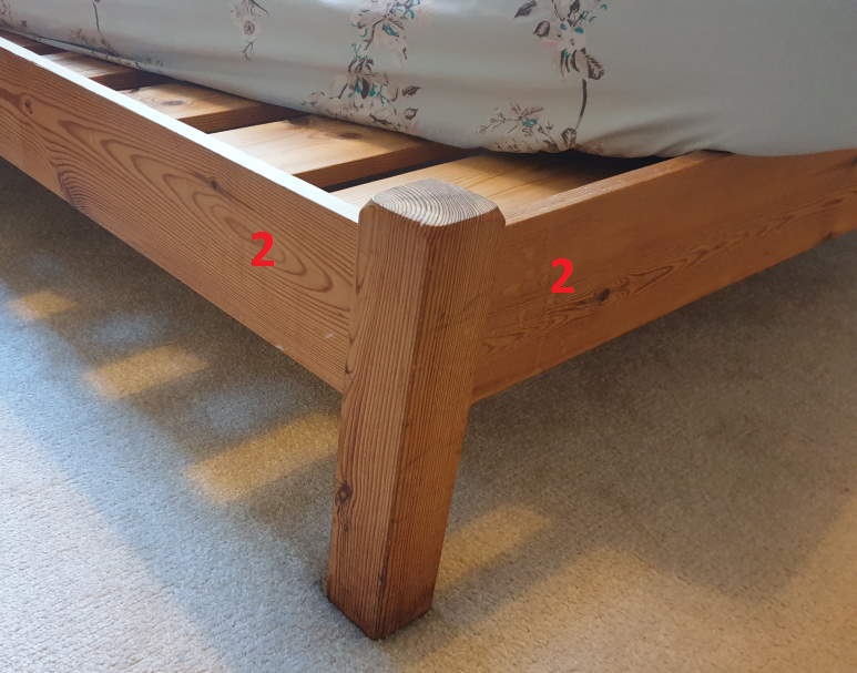

Here's a couple of pictures of the existing bed. Don't worry about the red numbers. The two side pieces, and the headboard cross-members etc, simply go into slots in the legs, which fit the cross-section of the planks, and are about 2" deep. Then the cross-pieces are presumably glued in place - the long side pieces go into the slots in the top and bottom legs, then are secured by a few big screws that go in diagonally....
That looks like a mortise and tenon joint and I have to admit that I'd got the (wrong) impression that you needed to cut a long groove :whistle:
Now I know what it us you are trying to do I reckon I know how your man made it - he like as not used a square chisel mortiser (or even chopped it out by hand). Frankly, the best way to get something like that cut is to find a local joinery shop - the sort of place that makes replacement wooden windows or repairs sash windows - and ask them to chop out the mortises for you (you'd need to mark out for them, first, though).
Failing that, as square chisel mortisers are a bit expensive, I think the next best thing is to beg, borrow or heaven forbid buy (!) a small pillar drill or a portable electric drill and drill press and use that to bore out the majority of the waste, finishing the holes square into the corners using a fairly wide chisel (32 to 40mm) driven with a mallet or a hammer. To keep your chisel cuts plumb you can always clamp a square piece of planed timber to the face of the leg and use that as a guide if it helps
