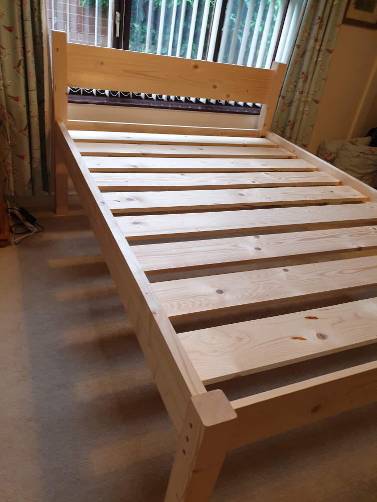

{update} OK swapped one set around, and sadly not much better. If I position the bracket with the pins at the end of the side member, well, the tapered slot of the other half does kind of draw it in to the post, but not nearly enough to make it all tight and wobble-free.
So it looks like you have to try and experiment with how far back from the end you have to mount that bit... seems a bit crap, to be honest.
Yes. The left hand piece of your bracket needs to be set back from the end of the rail by the thickness of the right hand side of the bracket, plus an allowance for the "buttons". Normally the manufacturer's web site will have a drawing which states the set back distance

Ah, the joys of (a) not knowing what you're doing; (b) buying things on eBay, which are devoid of instructions.
I've just finished re-doing them all, and it all seems quite solid now - the fixing screws aren't that long, so I wonder if they'll work loose in time.
If I were doing it all again, I'd do it differently, I think. But for now, a new bed for £100's worth of wood and a lot of grief seems like not too bad a deal.

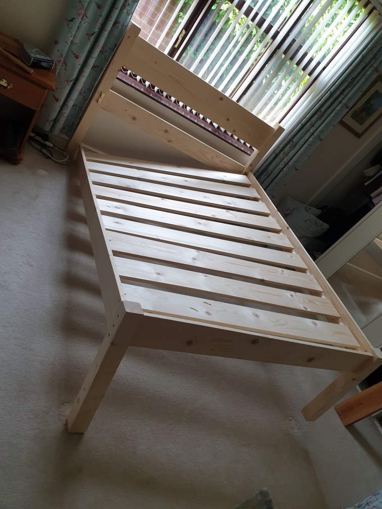

Well, you were right there; when I sat on the edge of the bed, the bracket pulled its screws out of the leg, and the whole thing collapsed.
After all that, and so many days of hair tearing and effort, I am gutted.
Back to the f'ing drawing board. I accept that I started this job without understanding the challenges involved, so have nobody to blame but myself, but those brackets are really **** - I don't see any way they could ever have been trusted, with such short screws. And longer screws would have gone right through the bed sides.
God knows what I'm going to do now - have dismantled the old bed and moved this one into the bedroom, so will just have to put it all back I guess.

OK, didn't have the balls to start again with a different system, eg cross dowel bolts etc.
So back down to the timber yard and got some of what I should have used first time, ie 32mm PAR rather than 19mm. This of course is (a) much more solid (as Freddie Mercury observed, it was somewhat weedy before), and (b) will also take a decent length of fixing screw for the brackets.
All assembled now - solid as the Rock of Gibraltar.
As regards seasonal movement etc, erm... LA LA LA, I'M NOT LISTENING :p
