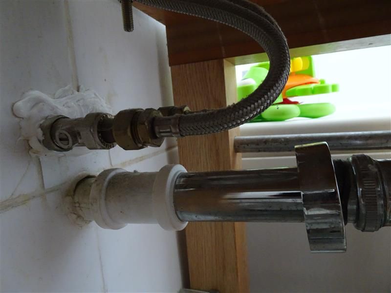

We are currently changing our basin and tap, and have purchased a Grohe Tap which is ready to be fitted.
Currently we have a mixer tap installed with flexible pipe connection and a chrome waste and trap. (Some pictures are below of our current install and also the grohe fitting)
Ive borrowed a vernier and the waste pipe nut has a diamater of 44.61mm, the pipe is 35mm going into the wall.

1) to fit the grohe flexible tap connection pipe which appears to be smaller than 15cm isolation valve connection. What adapter do we need for our fixings? I would like it to be as simple as possible. (link to screwfix or ebay would be useful)

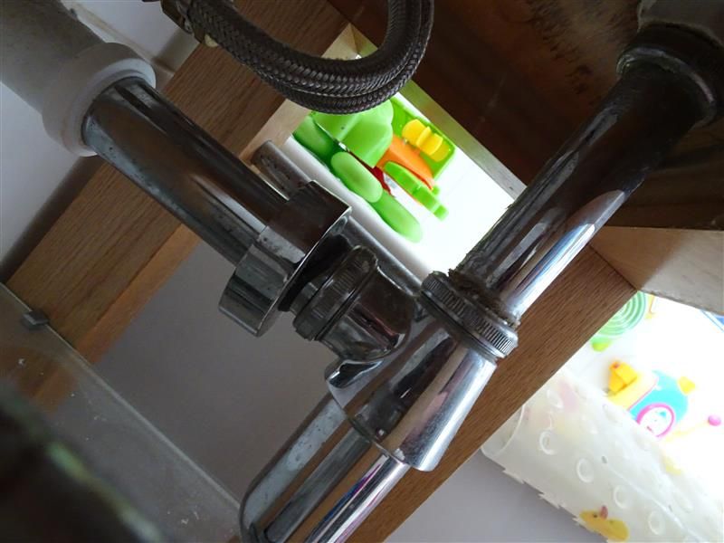

2) Could you advice which waste trap and pipe parts I would need to purchase? (again links to screwfix would be useful)

You need a 15mmx 3/8" MI adapter. 15mm replaces the capnuts, and 3/8 to tap flexy
Can you not use the existing trap
I would prefer not to as it leaks a little bit. The new one is going to be hidden so it can be a super efficient white one, just need to know which sizes to buy.
Go to merchants or Toolstation and get one and quarter inch McAlpine trap, preferably one with adjustable height
AA10 is one such trap
A10AV is for long runs (trap has an air vent to stop it gurgling)
A10 is basic version of above.
Replace the push fit with McAlpine 1.25" coupler.
