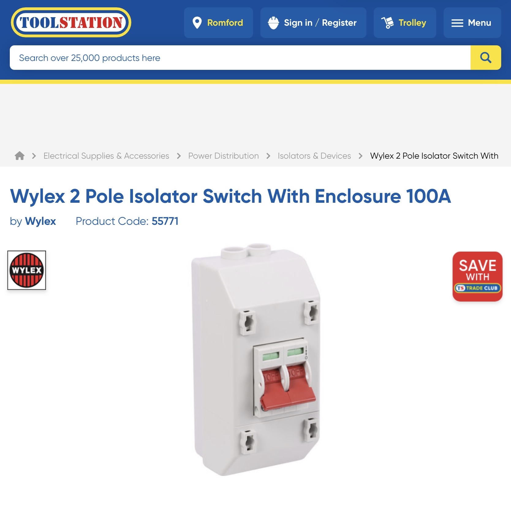

We've recently changed providers to British Gas. They have said our current smart meters are due for replacement. I’m thinking of having my consumer unit replaced in the future so I’d like to fit an isolator between the meter and the consumer unit. I’ve seen on here some posts where people have provided an isolator and the meter installer has fitted that when the meter is being replaced.
Would this isolated be okay?
I'm with British Gas and had smart meters fitted last year. When the meter fitter turned up I asked him if he could fit an isolator while he was changing the meter. No problem, he fetched an isolator from his van and fitted it. No cost to me.
It is a matter for the supplier of electricity so you must conform to their rules.
Ask them if they fit an isolator as standard in new supplies or if they fit one if requested and if they charge or include it in the price. Most of them probably charge if you request one on an existing supply . Some may charge or not charge if requested at the time of supply (or other such associated works) and you might or might not be successful if you ask the metering fitter at time of the meter being fitted.
Looks like a plastic enclosure. Is that allowed? I.e. does the rule about consumer units being metal for fire safety also apply to this? I guess it doesn't, right?
Suppliers rules mioght differ from ours - plastic consumer units are actually allowed, the rules (BS 7671) does not forbid plastic consumer units. therere are several options and yes one easy option is metal consumer units, unfortunately a lot of people seem to be ignoring the possible dangers of metal consumer units or mitigation against those problems.
Unfortunately some manufacturers did not act as they should have when making plastic consumer units, if they all had hsave complied with what they should have we might not have the potential problems we have today London Fire Brigade (probably quite correctly) voiced some concerns with the consumer units in circulation and the IET acted upon that (whether rightly or wrongly or best solution or not we could orobably argue both ways)
The one that BG fitted for me was plastic. It's an isolator, not a consumer unit. The meter is plastic, the wires are insulated with plastic, every other accessory on the system is plastic.
Yep, that's the very product that most suppliers seem to use.
However, a couple of meter changes ack, I bought one of those and asked the meter changer if he could install it. He said that he would be happy to install an isolator free-of-charge, but that he "couldn't" ("wasn't allowed to") use the one I had bought - so he went out and got an identical isolator from his van and fitted it!
