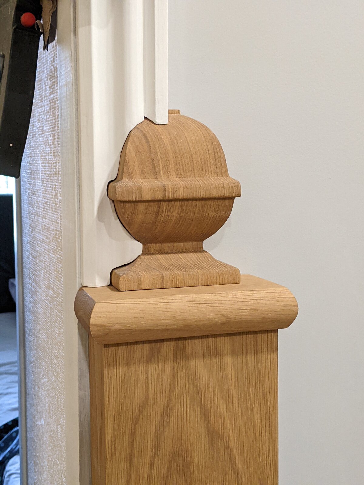

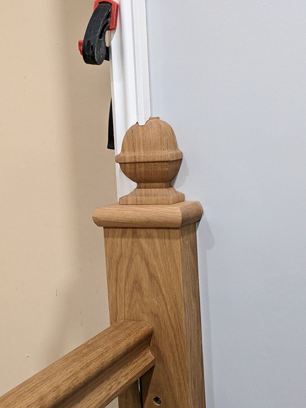

The finial should be left off, just take the architrave down to the cap, it would look a lot better.
If I removed that finial then I think I'd need to remove them all to match, but it would mean a lot of money's worth of oak finials and caps wasted, and I'd need to buy new caps as the existing caps have been bored out for the finials to sit in. The caps are for chunky 115mm posts and the landing is a double 90mm post, so it will not be a cheap option.
I appreciate I'm in the minority, and it's not currently fashionable, but I like them and have always wanted to build my balustrade with fancy finials.
So far I think @mrrusty's solution of placing a plinth block behind the finial is what I want to go for. I prefer it in oak (I already have spare offcuts) and it will be easier to maintain when it comes to painting the white woodwork.
Should the top of the plinth block be bevelled to match the upper part of the cap?
