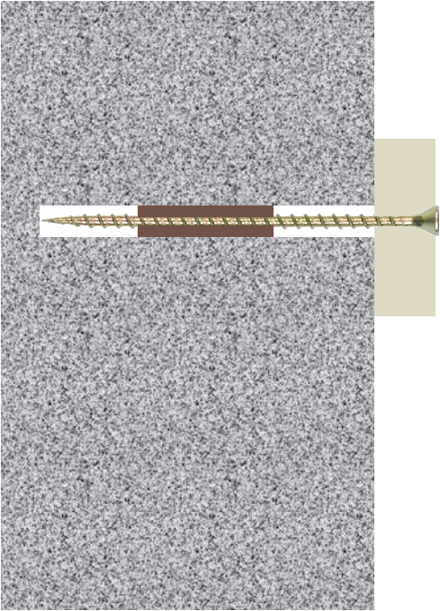

Need to fit two metal brackets to a wall to carry a double set of ladders which weigh 15kgs and are 3.5M in length, what fixings would you recommend?

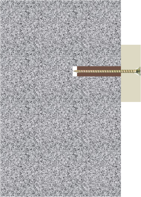

Even allowing for the thickness of the brackets Ive never seen brown wall plugs anywhere near long enough to take 80mm/100mm screws.
You can get longer plugs, quite possibly 100mm ones, but probably not also in such a relatively small diameter.
We await news of how the wall is built, but I doubt that more than 6x50mm screws would be needed for a bracket supporting 7.5Kg.

The plug provides pull out resistance and allows you to hard fix an item by pulling it furmly onto the surface of the wall. You aim for a snug fitting plug at about 1/4 to 3/4 of the depth of the hole. The length of the screw ensures that if the screw drops it will, by default, wedge itself in the hole, this resisting further pull-out. In a situation like this you need to aim to over engineer the screw rather than make it just big enough simply because it as the ladder is loaded and unloaded there will be a tendency to pull it outwards. You don't normally use more than a single plug per screw because it simply isn't necessary, the exception being where you are dealing with ropey masonry where additional techniques such as drilling 6.5mm holes (instead of 7mm) and adding 2nd or even (in rare instances) 3rd plugs down the hole - although should you need to do much of that you need to start looking at alternative fixing methods such as "thunderbolts" (concrete screws) or resin anchors.
Well, all I can say is that I have never, ever, seen this recommended:
Nor ever encountered wall plugs without a lip designed to stop you driving them in deeper than flush. Obviously with a drift you can drive them in, but they are designed to not have that done to them.

And if you dont have half of the screw with nothing but air around it its a lot less likely to drop.

I didnt suggest using more than one plug per screw. I said that brown wall plugs are not long enough to take 80/100mm screws.

Fine, but I see no point in only having half, or less, of the screw in the plug, and the rest of it in thin air. Once the screw is all the way through the plug, and the plug is fully expanded, the threads in thin air are going to do zilch.

I wasnt talking about the screws.
I was talking about 80/100mm long plugs.
Guys the wall is built of concrete blocks which are 8" thick and outside, the ladders weigh 15kgs.
