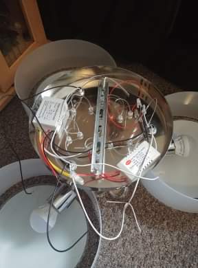

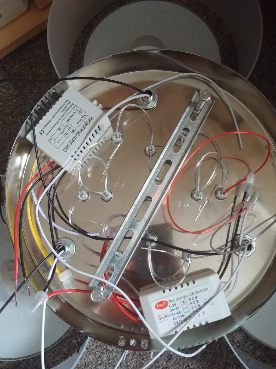

Hi there,
I'm looking for help please, I just recently bought a metal led lights for my living room, but upon looking at the led light wiring there isn't no were to put the earth. It's got 3 white wires and one red wire for the live to feed led light bulbs and the small leds on Base with 4 black wires being neutral. How can I fit this into loop circuit without the earth.
Any help would be appreciated.
Many thanks
Lee
Please post a picture of this light fitting and the wiring.
Where was this light fitting obtained?
Black white and red are not colours that should be found in any modern electrical item.

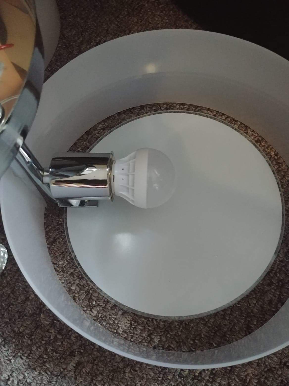

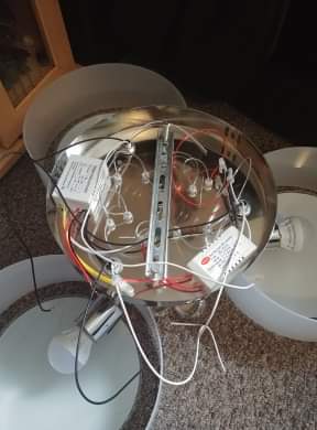

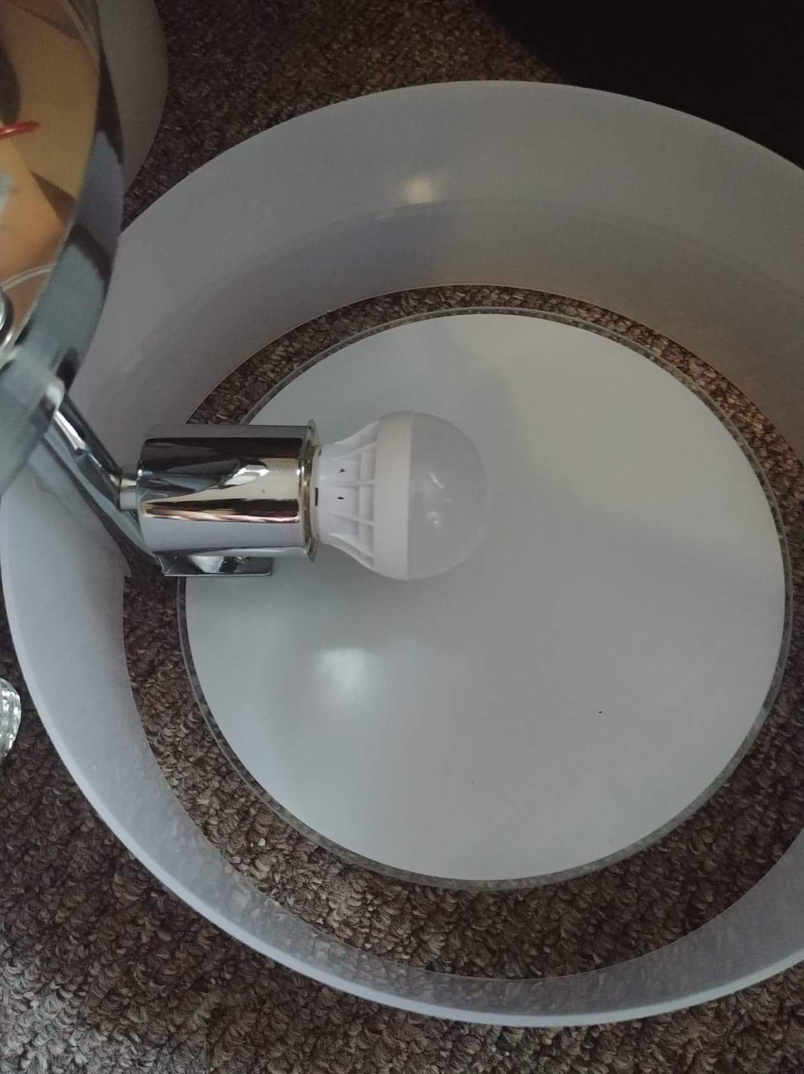

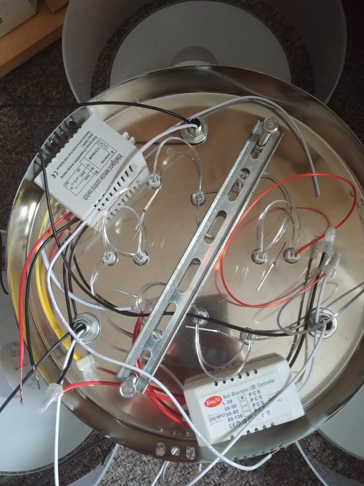

Hi there,
Here is the pictures of the light fitting, I got it off eBay.
The 3 white wire are live feed for the bulbs
The 1 red wire is the feed for the remote control switch
And 4 black being the neutral.
I did wire this up to a plug with a 5A fuse and a RCD in case but did not blow.
This is how i know what wires are what.
Many thanks
Lee

Does the fitting have a sticker stating Class 2 or a symbol like a square within a square
Impossible for that to be class II, given all the single insulated wires in there.
Single insulated wires of different voltages mixed together, no terminal block for connecting to the building wiring, no CE mark, no label stating manufacturer's details, no earth terminal.
Illegal, imported junk that should be returned to the seller for a full refund.
Hi there,
I am unsure what the yellow wire is, I brought this from a company in London but found out that it's Chinese with Chinese instructions
I did wire it up to a plug with 5A just using live wire and natural wire and it worked. But the thing is that there isn't a earth wire. Can I put an earth wire on the centre screw??
Many thanks
Lee
No, read the bottom paragraph of flameports post.
Also note the power supply init is for 220v operation. Not suitable for the UK or Europe.
I would send it back for a refund as already mentioned
Those two electronic modules are likely to be a fire risk if ( when ) they fail. Is your ceiling and the hole in it for cables fire proof ?
