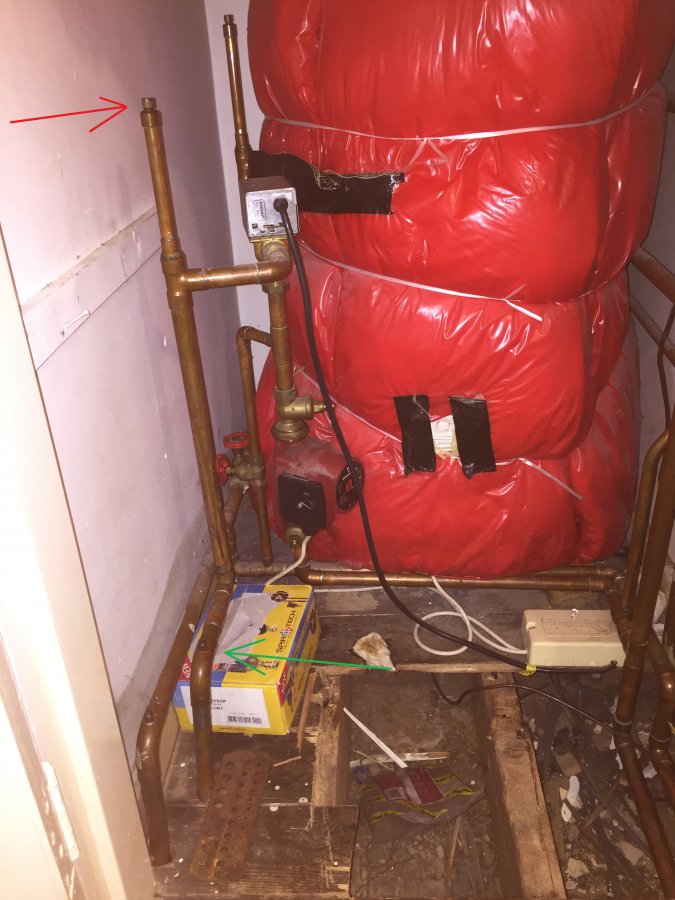

Hi
I can't open the 2 air release vents shown with the green and red arrows.
The red arrow one has no screw driver slot.
Any thoughts of how to get them to open.
the red arrow, you loosen the cap. It should undo with your fingers but you might need a gripping tool. Don't crush it.
The one behind the red arrow is no problem.......
but this one won't budge.....don't want to damage it........
It doesn't look like there's much point opening the green one as the pipe appears to head straight up to the red one...
Yes, was wondering that myself. I guess they must had some reason when they designed the system.
The water flows from the Red to the Green, don't know if that makes a difference.
