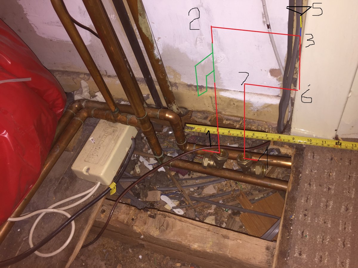

This is the design - perhaps you would be good enough to point out any faults or your constructive thoughts.
I have some compression fit elbows (22mm) and they will be fitted at the corners marked 1,2, 6,7 & 4
The return pipe would be cut at 1 & 4, hopefully i can get a pipe slice in there.
The Magnabooster will go in the bit marked in green (obviously it is not to scale).
Corner 3 - will be a 22mm T compression joint - reducing to 15mm on the vertical bit (ie the Blue bit).
- The Yellow bit will be a 15mm isolation valve ( http://www.wickes.co.uk/Wickes-Chrome-Plated-Isolating-Valve-15mm/p/420187), I guess this can be any isolation valve and that there isn't any thing special about it.
The Black bit at 5 is an Automatic Air release Valve (like this Bottle Air Vent - http://www.screwfix.com/p/bottle-ai...g&gclid=CK2P19HhssgCFQq3GwodU24KuA&kpid=34359)
As i mentioned it is extremely tight in there.
