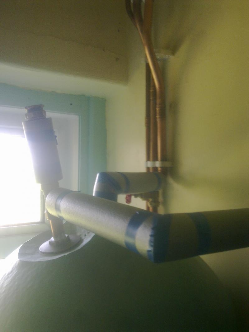

I want to fit a shower pump alongside the HWS tank, but I have found that the top outlet fitting is a male 22mm compression fitting thread (22mm or 7/8" ??) although the coil unions are 1" females?!?!.
Is there any way of adapting a conventional 1" or 3/4" thread Surrey/Warix flange onto the 22mm thread?
I would rather do this than have to drill the tank for an Essex flange if possible.
