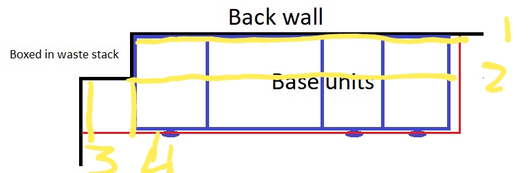

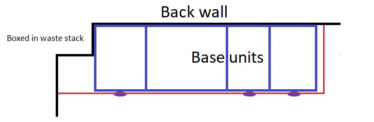

I need to fit a kitchen worktop into an awkward shaped 2 sided alcove with a boxed in waste stack in the back left corner.
I am familiar with scribing, but I cant quite workout how to scribe a worktop into an alcove. I have attached a plan pic of what im trying to do. Can anyone offer any tips on how to scribe it to the two walls and also around the boxing in - assume none of the walls are that straight and not at 90 degrees......
I'd just use a bit of cardboard and cut to the shape, then use a template.
Assuming you will have tiles, upstand or similar it doesn't have to be mm perfect. Even a bead of silicone will cover any small imperfections.

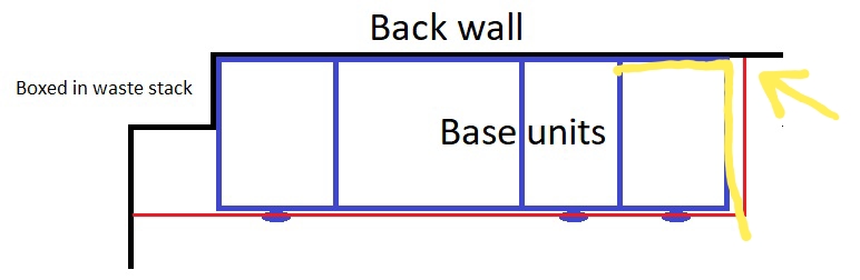

In any case, use a long square on right edge against the wall (yellow line).
Measure how much out the edge of the worktop is from right wall (yellow arrow) and mark it on your worktop.
Measure twice, then cut.

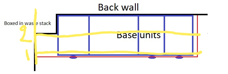

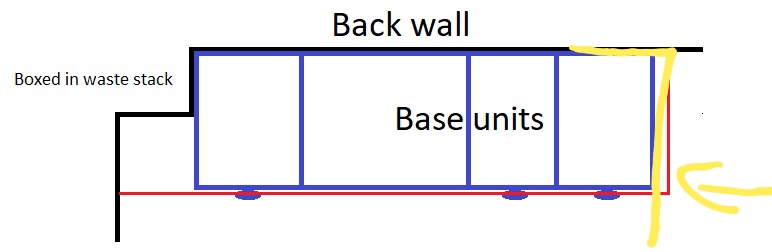

Now, with the left side.
Measure yellow lines 1 and 2, subtract 5mm from these measurements and mark it on your worktop.
Measure again and then cut.
Now the pipe box.
Measure yellow lines 1,2,3 and 4 one at the time, subtract 5mm and mark your worktop, one measurements at the time so not to get confused.
Measure all again and then cut.
If you've measured correctly your worktop will fit perfectly, leaving a 2.5mm gap right and left.
