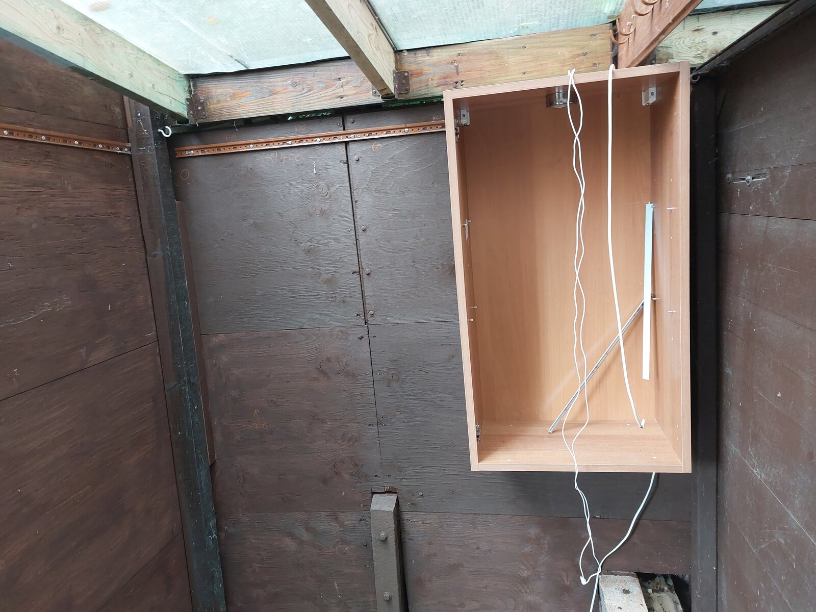

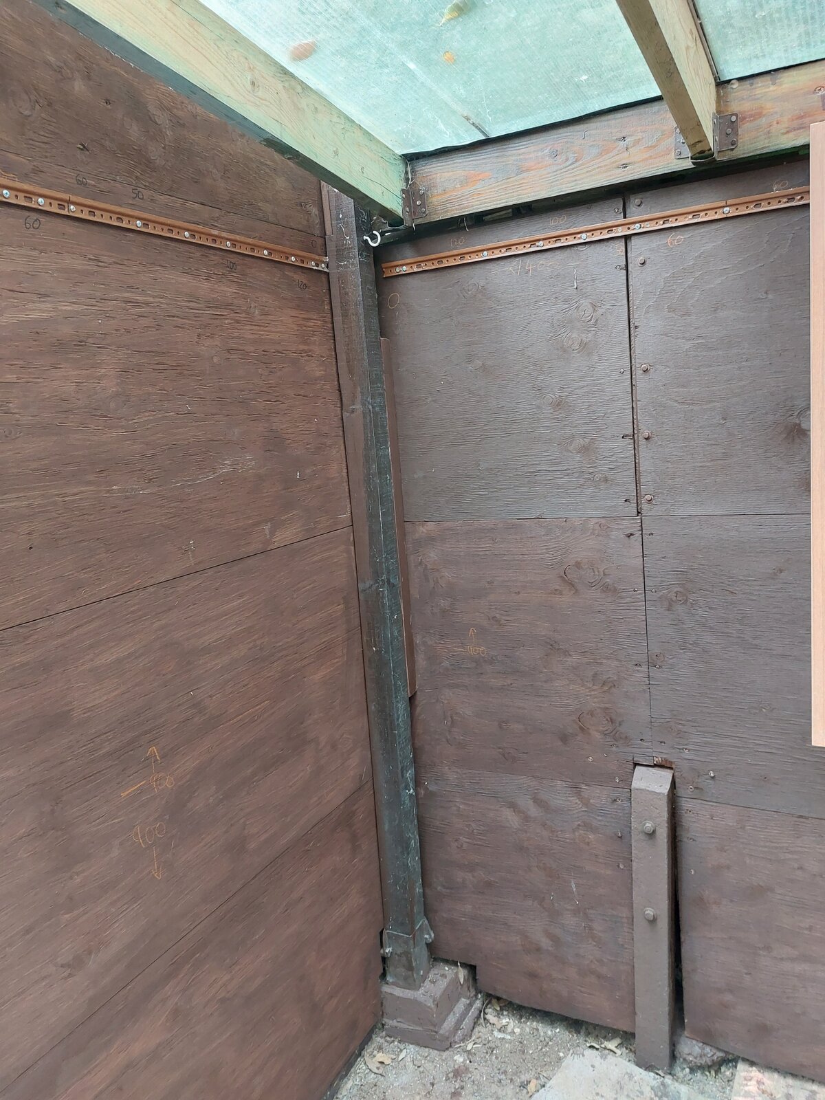

No, I pulled it up and built a shed with it
