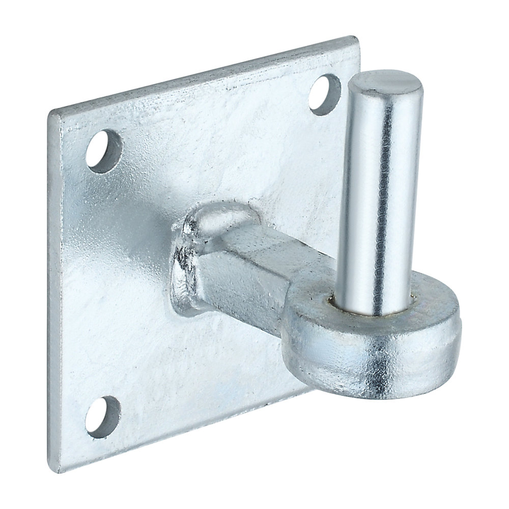

I'm looking to fix an outward opening gate to the inside face of a pillar (built from concrete blocks). I'm thinking of using 24"/30" hook and band hinges.
Can these hook plates be fixed into concrete block? I see most people fix them into timber gate posts but I want to avoid that to preserve the full width that's already there.
Does fixing the hook plate into masonry work using a wedge/sleeve anchor or why does everyone seem to fix them into timber?
Proximity of the holes on the hook plate can mean fixing into blocks is more difficult as holes are fairly close together.

@foxhole Yeah, I've been thinking about the narrow spacing in the supplied plates. I might get some of the 19mm hook plates visible in the attached image

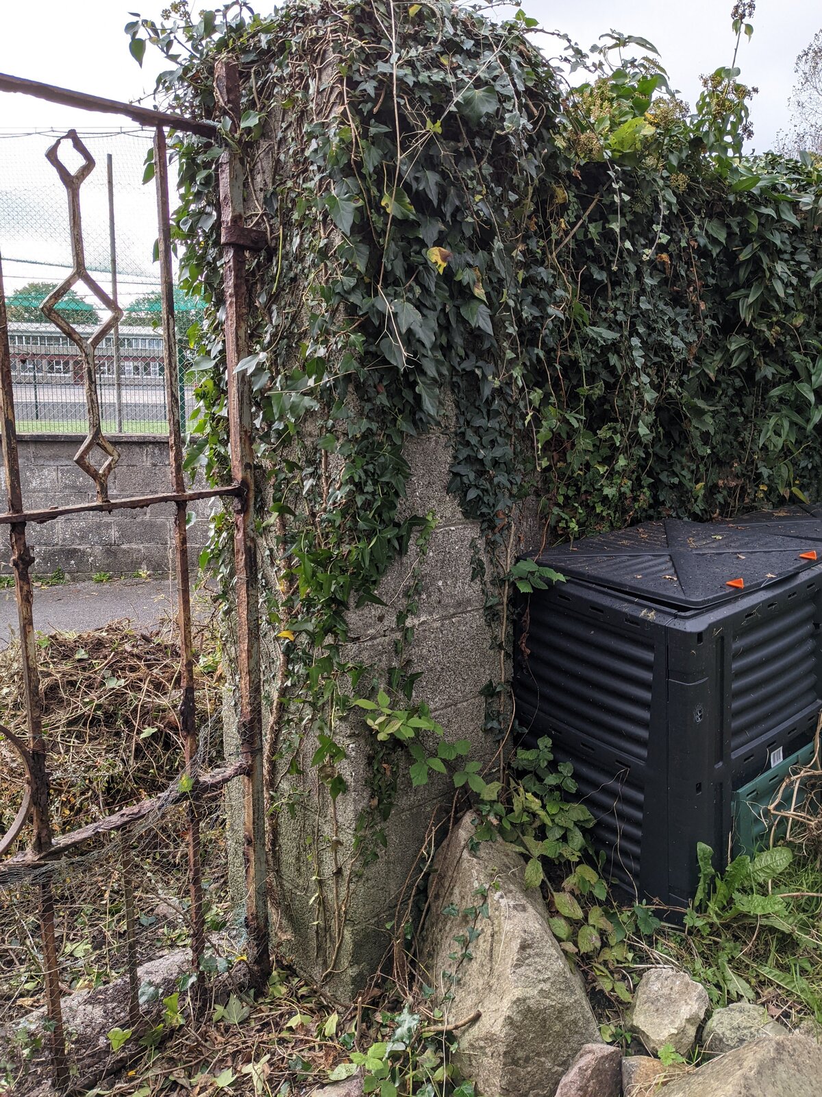

@JohnD Thanks for the tips. The pillars are 550mmx550mm (as seen in the attached image). Is it a possibility that the weight of a swinging gate could destabilise these? I'm just curious why you recommend the gatepost? Is the main benefit ease/speed of installation or is there something else I'm missing?

I think the pillars are piers attached to a wall, so the wall will stop them falling over. A blockwork pillar on its own would not support a gate for long.
I am sure that hinges screwed into a wooden post will stay tight longer as they have some resilience. Screws or bolts into brick or block are liable to shake loose. The post will damp the shock. you can also use a bolt or studding through brickwork, though that might not be possible in your case. A nut and washer will not shake loose.

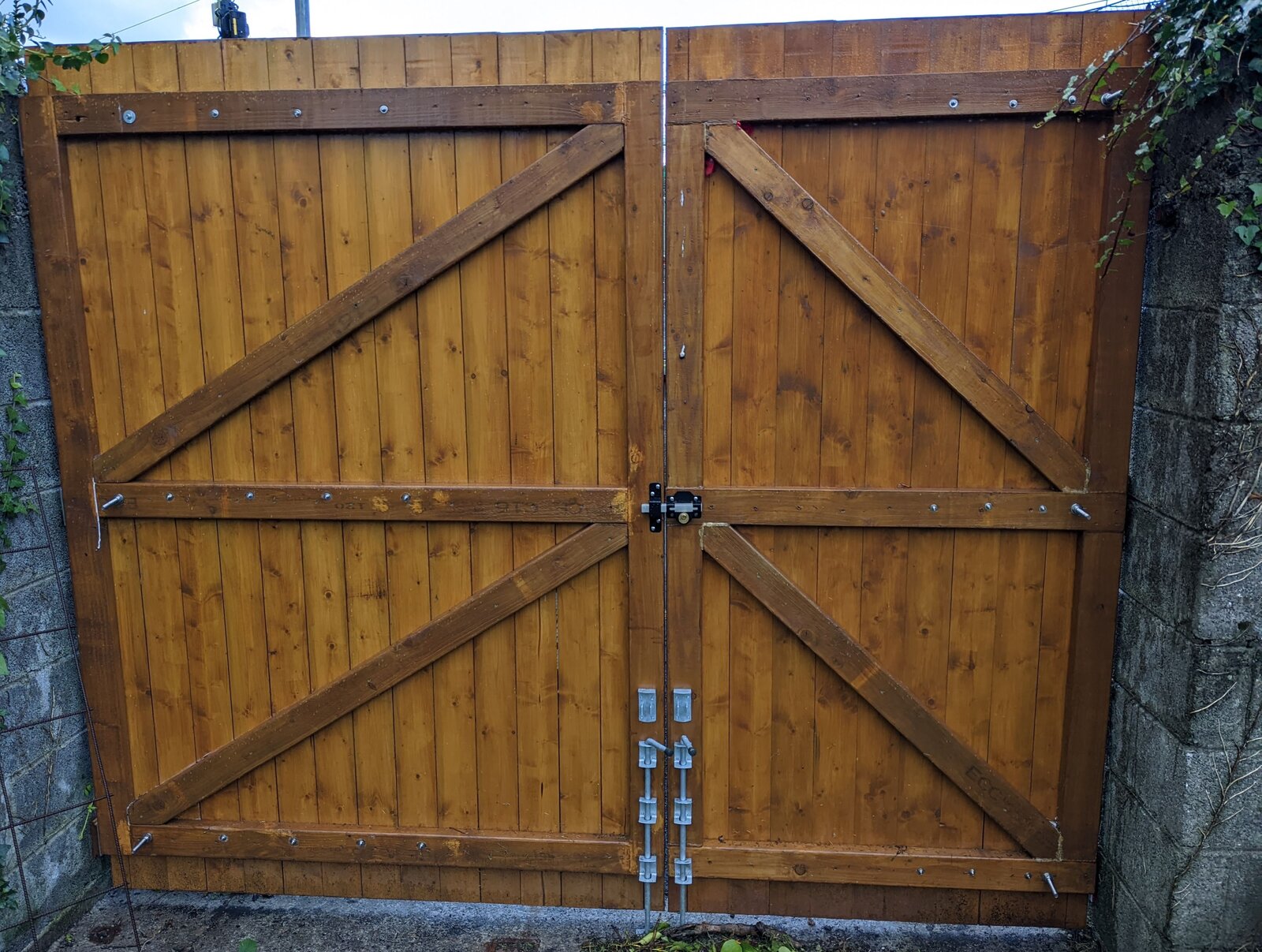

Just following up on this thread (for anyone who is interested in the future). Below are pictures I took a few months ago of the finished gate.
I used chemical anchors to fix the gates. No movement or sagging in the last 10 months despite a few storms.
In hindsight however (for anyone who's interested in a similar project), I would have used timber gateposts. My reason for fixing to masonry was that I wanted to maximise the opening. However, I now realise that gateposts (with the hinges mounted on the front side/outside of the gatepost) would have almost offered the same opening width. It would have also made hanging a bit easier.
Thanks for all the advice
