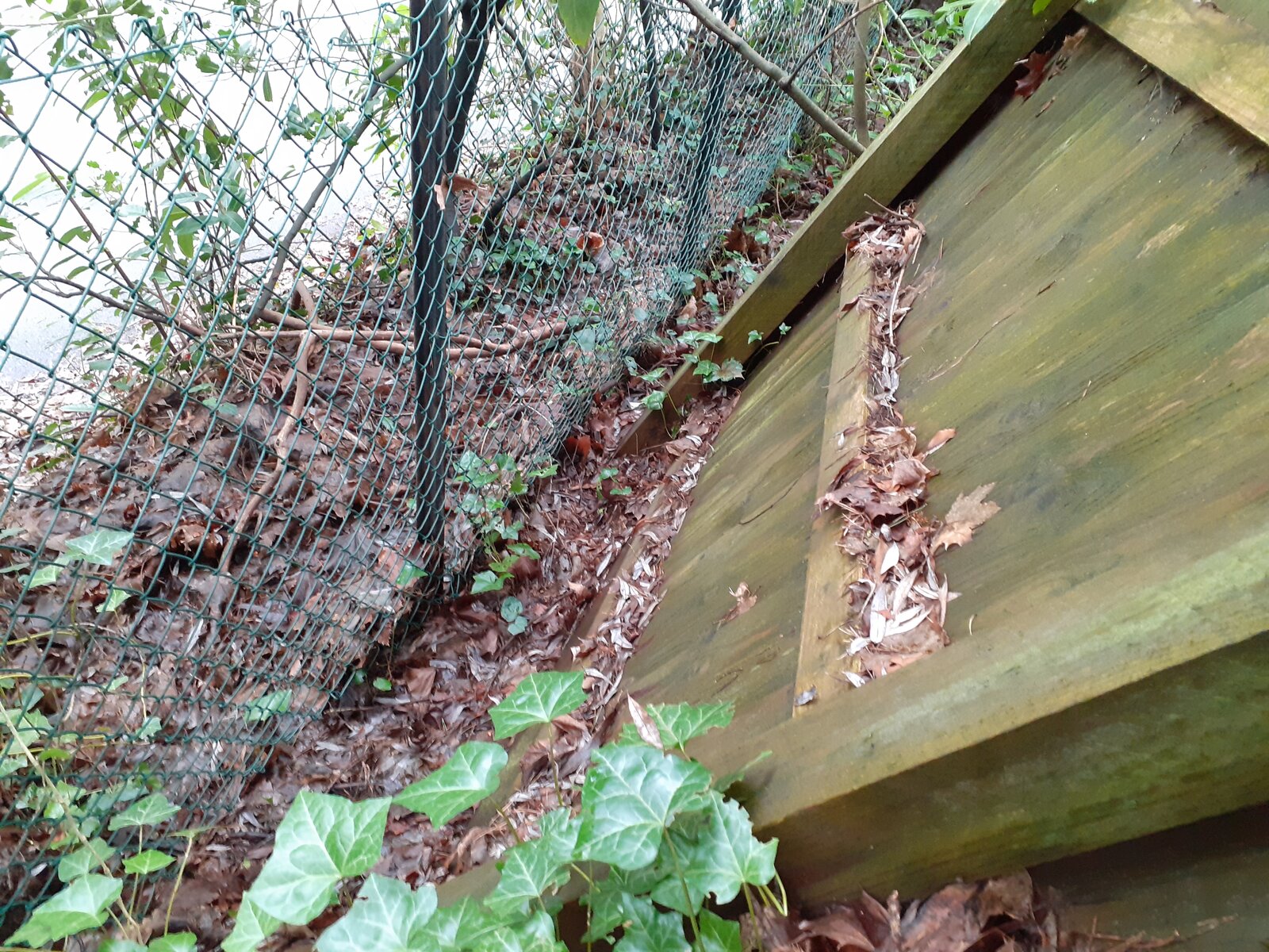

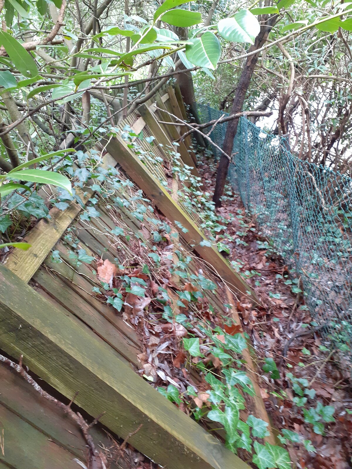

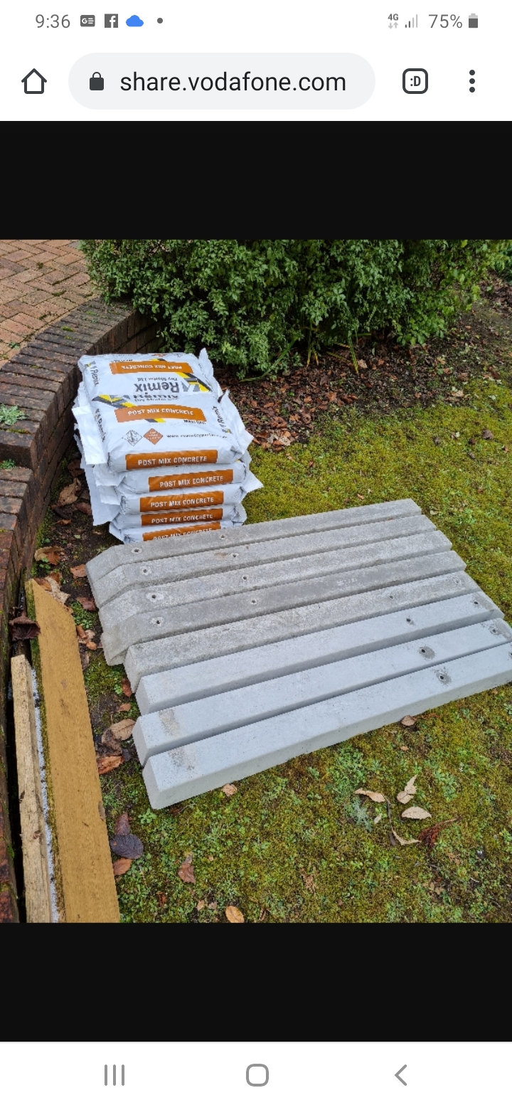

I've got eight snapped fence posts. The fencing is laying on its side. Is it best to put all the fence spurs in first then when concrete has set push fence upright and bolt it on?

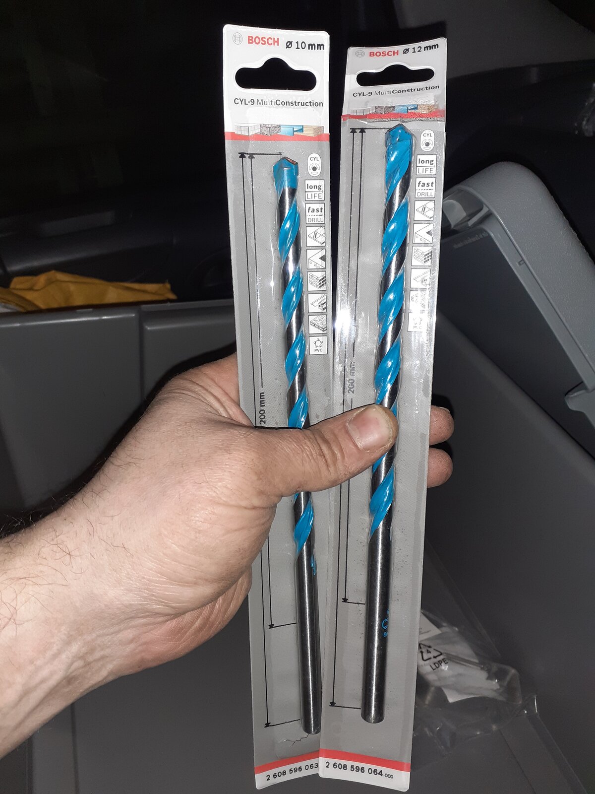

Is it worth bothering with washers or just use smallest auger possible for bolts?
ATTACH=full]222371[/ATTACH]
drill bit
Were the original posts concreted in or knocked in ?
If they have snapped just above the concrete then you will have a hell of a job on, would be better to put new posts half way between original posts.
If they were knocked in then may be they are just leaning, in which case you might stand a chance, still a big job digging a pit for each one then shoring the whole thing up until you get the new in

How do you plan on working in such a tight spot,leaving the fence in place?
I thought that. That wire fence is going to get in the way in parts. Perhaps put fence spurs back a bit ( move whole fence back a bit? What about spurs put the other side of fence?
Doing it tomorrow. Will prop up fence with rope or stakes then use breaker when fence is in correct position

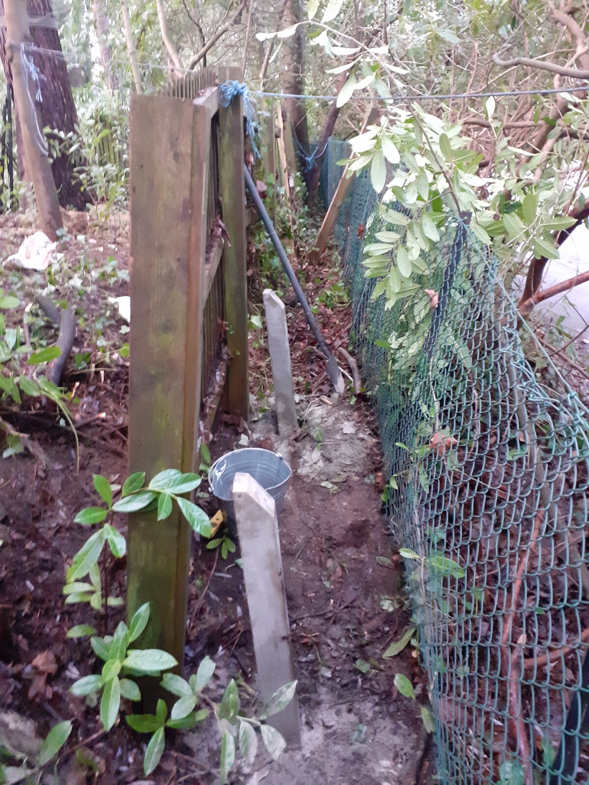

Wish I had a horse to move the fence forward. I wasn't sure if Eddie was messing around so didn't bolt them to posts all together then put in holes, asyou can see just put them in and when concrete has gone off will then bolt them in. The bolts are 10mm and hole in concrete 13mm. I bought these two long drill bits
No, it's best to bolt the concrete spurs to the posts first, then lift the whole lot into place, then concrete the spurs in. Jeez.... what do you think?
The fence wont stand upright if I was to do that posts would be pushed off plumb. It's all over the place. After watching YouTube on spurs you prop fence then bolt then cement. But these wont stand up.
consider cutting one of the panels in half. move the post holes half a panel along. concrete the spurs in and bolt the old posts back to them. Then fix the panels.
