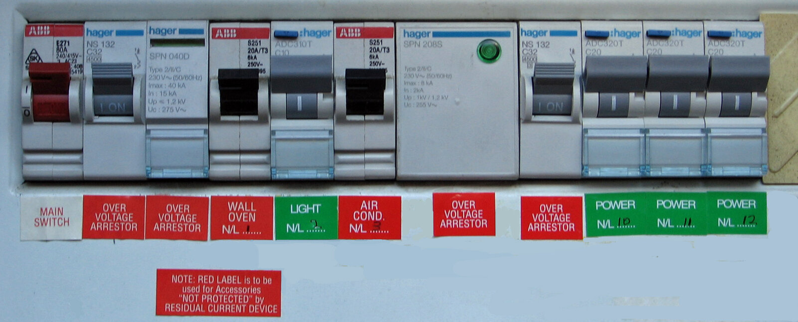

Does Australia/NZ define a "power" circuit and/or a "lighting" circuit?
"Power" Circuits. 20 A for "Socket Outlets" (2.5 mm²)
"Light" Circuits, 10 A for 'Lighting fixtures". (1 mm² or (now, often) 1.5 mm²)
(If a "luminaire" is connected to a "Power" circuit, the wiring must be rated for 20 A (2.5 mm²) and a "note" at the Circuit Breaker indicating that a "luminaire" is also connected to that "Power" circuit.)
A "not so typical" Australian "Switchboard" (CU) - since "Over Voltage Arrestors" also are installed. (Not "common" but a good precaution.)

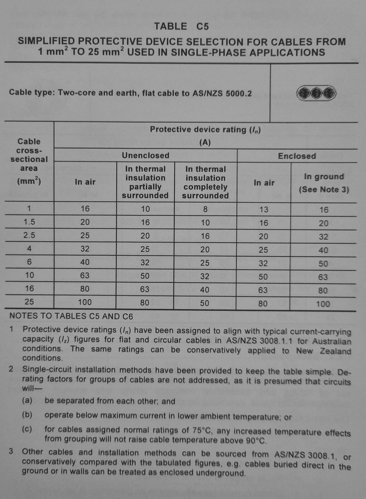

Is it forbidden; i.e. never done; to have a 16A OPD on a socket circuit?
While one wonders what an "OPD" may be (possibly an "Overload Protection Device")
16 A Circuit Breakers are available and used under certain circumstance.
The following is a Table concerning this:-
Generally, Australian Electricians just use 2.5mm² for "Power" (Socket Outlet) radial circuits rated at 20 A and 1.5mm² for "Light" Circuits rated at 10 A.
(1 mm² was used in the past, for Light Circuits - my house is wired with it - but the cost difference is now so small between 1mm² and 1.5mm² cables that it is hardly worth the effort for professional electricians to now stock/use both!
While 1mm² T&E cable is available with only Solid Line and Neutral conductors, the Earth conductor in such cable is "Stranded".
Above 1mm² - to 2.5mm² - cables with both Solid or Stranded "Line and Neutral" conductor cables are "available".
However, no "practicing electrician" buys any "solid conductor" cables - since they are more difficult to work with, bend, straighten etc.
Hence none but electrical "Supply Houses" actually stock such items!
While it may not be clear in the images shown in https://www.bunnings.com.au/search/products?q=electrical+cables&sort=BoostOrder&page=1 the "stranded" nature of the available Line and Neutral conductors is so and you can look this up on other Australian Electrical Supply sites.
