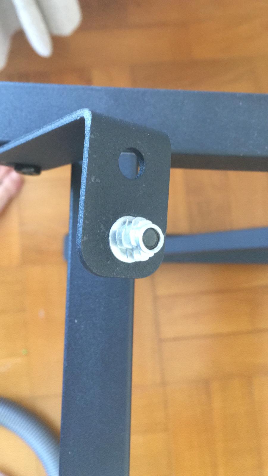

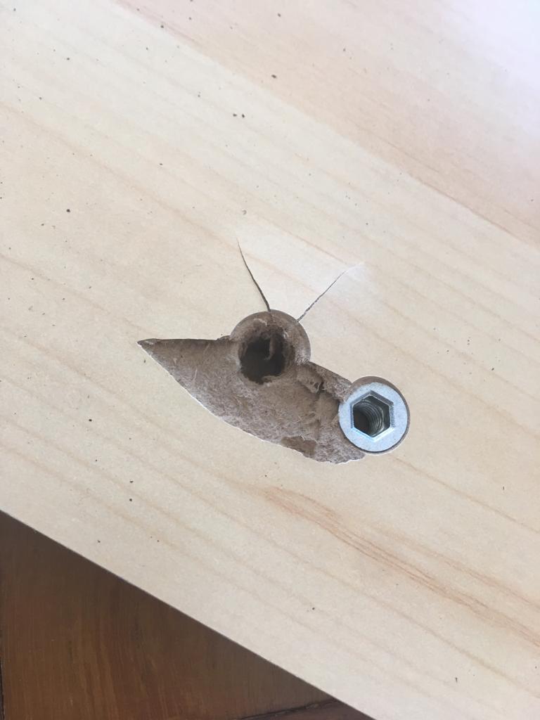

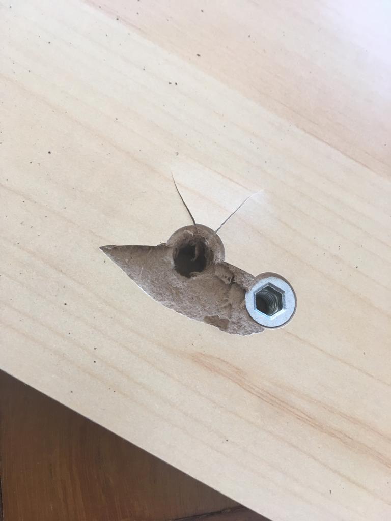

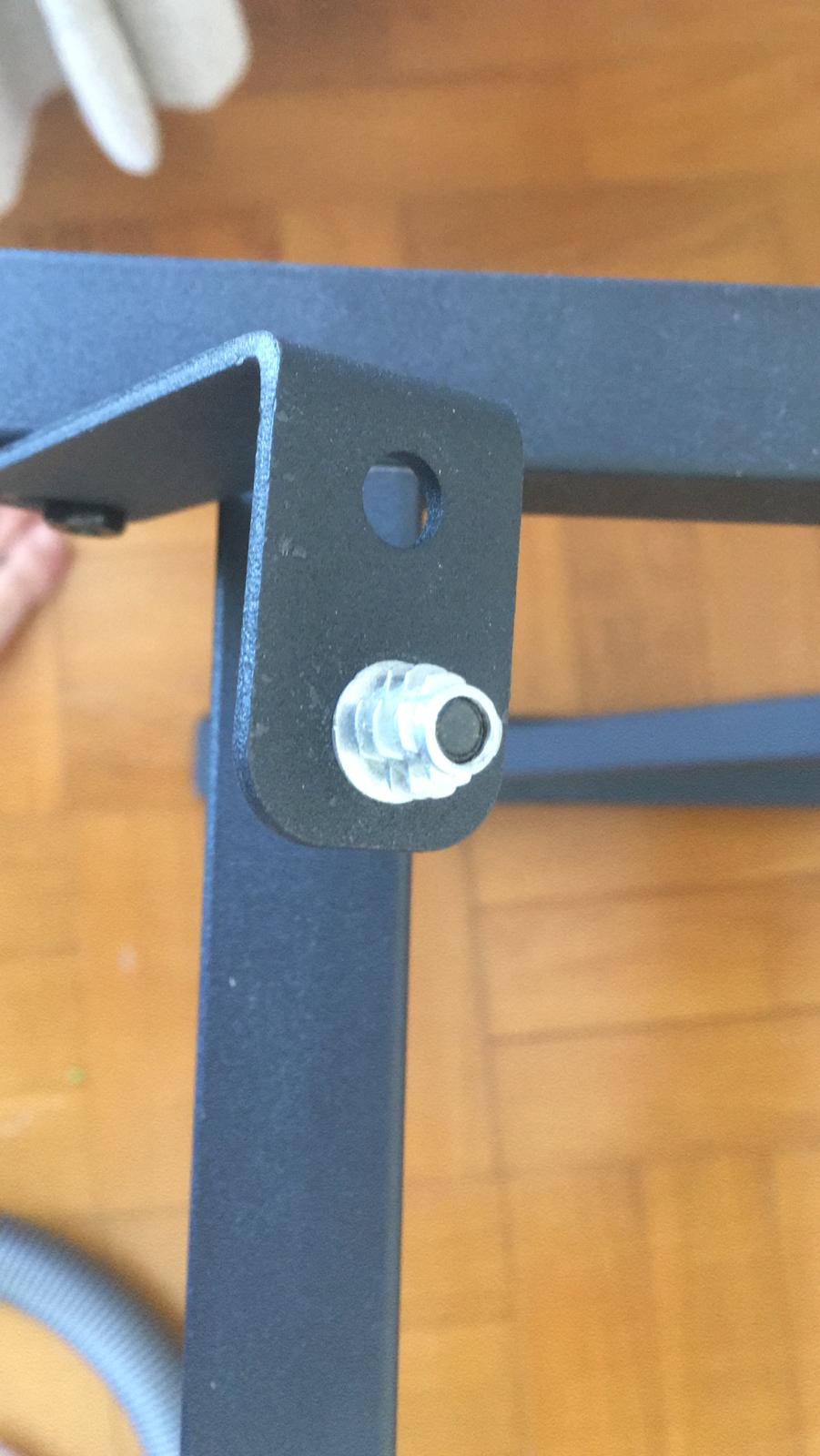

Any ideas or suggestions how to fix where this nut has ripped out of the wood? It’s only a kids art desk so won’t have much weight bearing. Photos attached.

Fixed quite a few like that , clean out hole and mix a little car filler , fill hole and push fitting in before it sets, clean any excess away before it sets.
