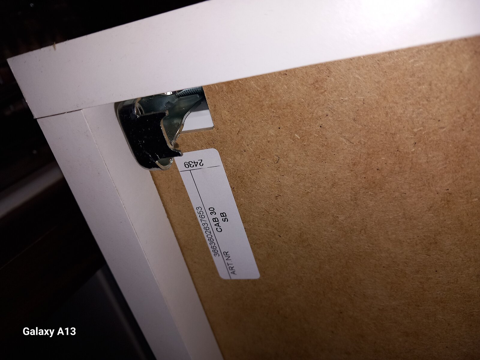

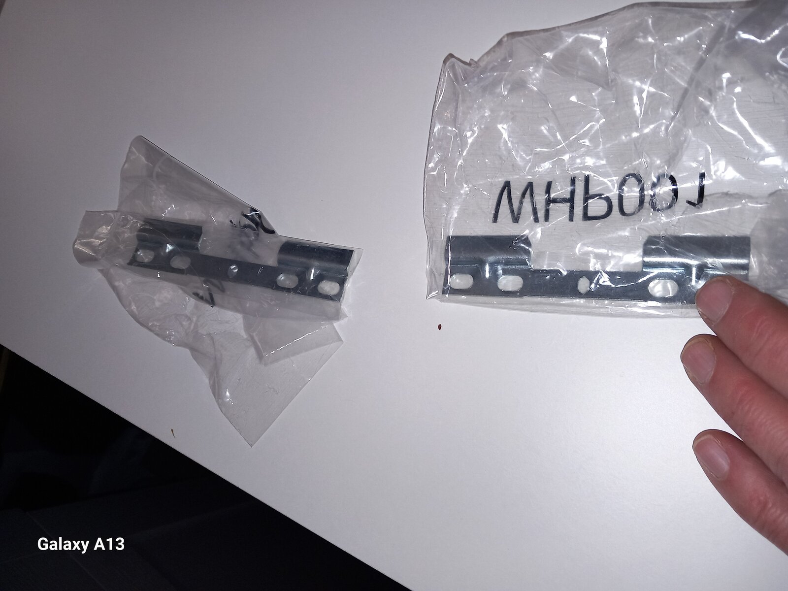

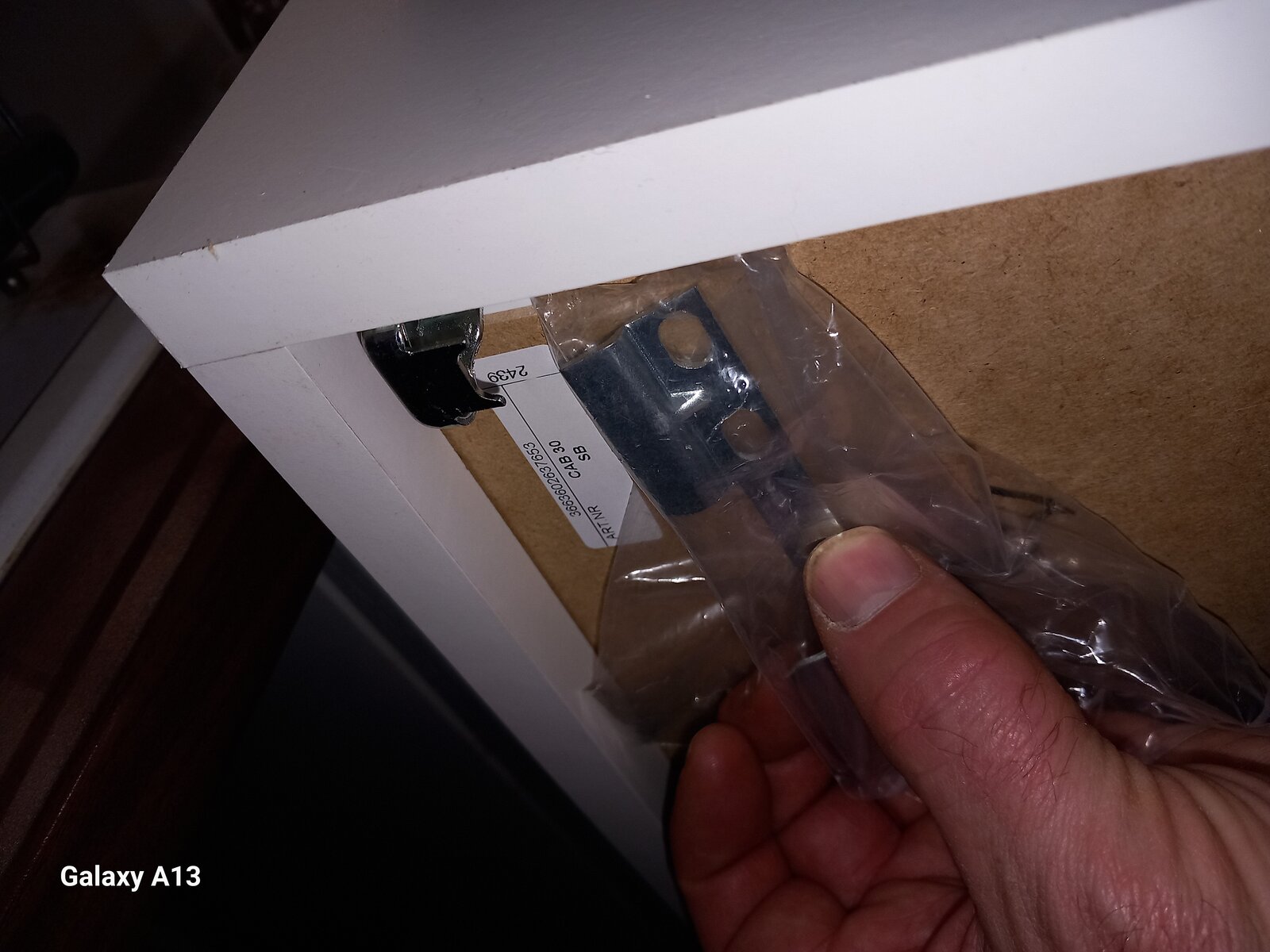

The walls hollow so I guess plasterboard. Can't find studs with magnets or stud finder but kitchen units are going up on it. What fixings? Gonna be heavy. Do the hooks go onto these plates in picture?

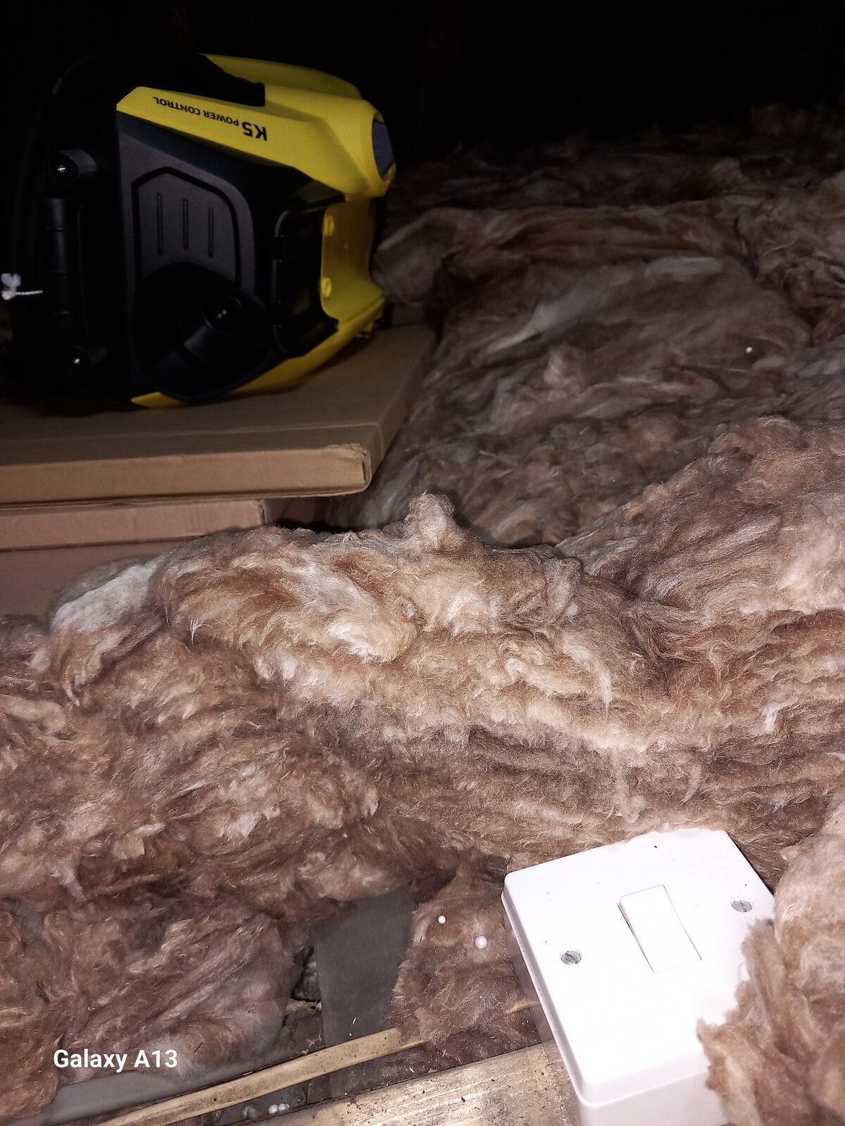

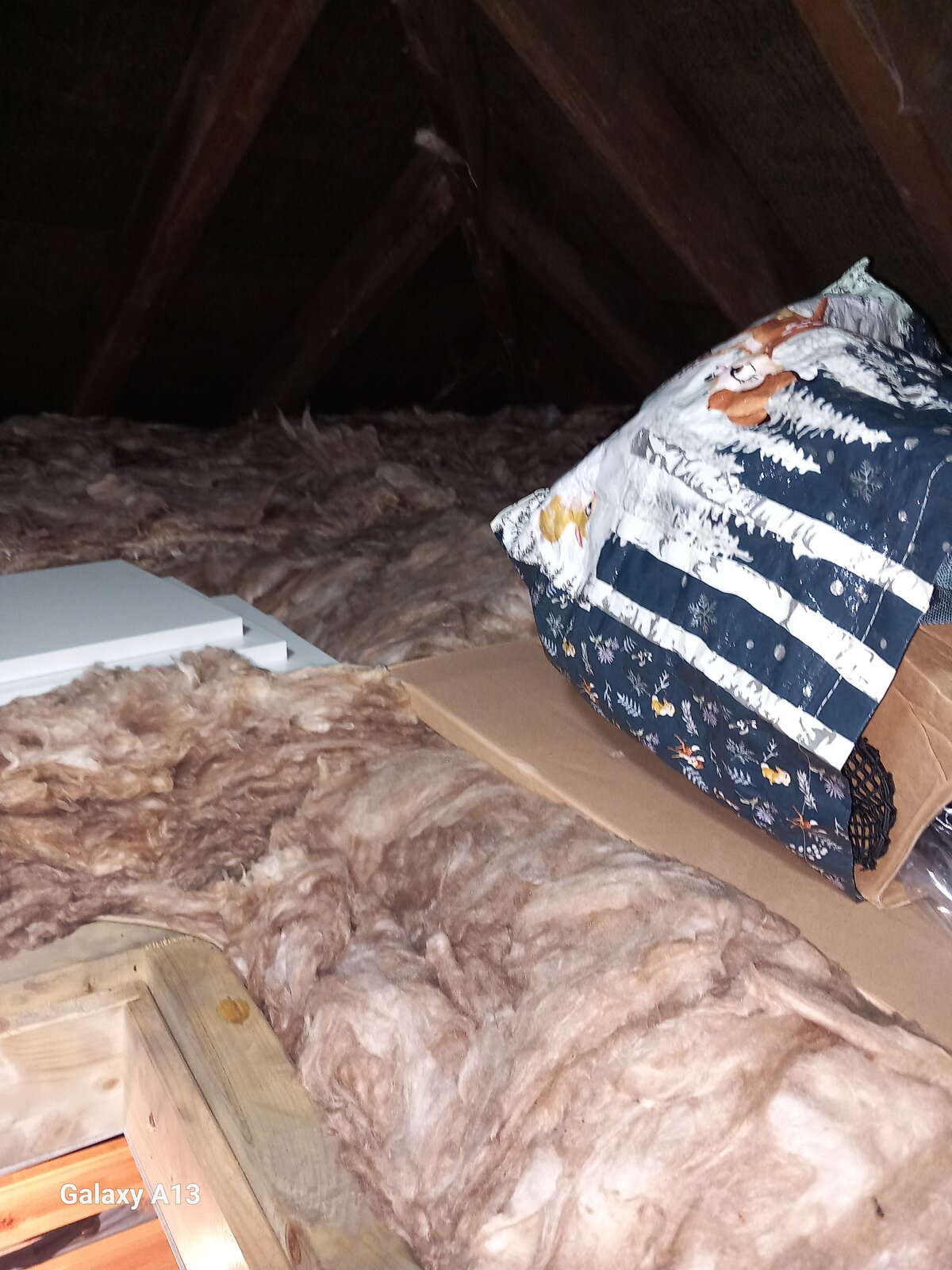

For loft can I cram down the insulation and cut osb to GP on top? What's all covered

Don't fix cabinets to plasterboard, it will fail.
You must find solid stuff (bricks behind dot & dab or studs.
Worse case you need to cut a bit of plasterboard, insert tape measure and see where studs are or go deep enough if dot & dab
The brackets on the third pic are the ones that hold the cupboards to the wall.
If the new units are going to sit on top of the existing ones then hollow wall fixings will be fine - so long as all is good on the ones below. Do find out how they are fastened though!
Remove a 100mm+ high strip of plasterboard and replace with ply at the height that will carry the fixings

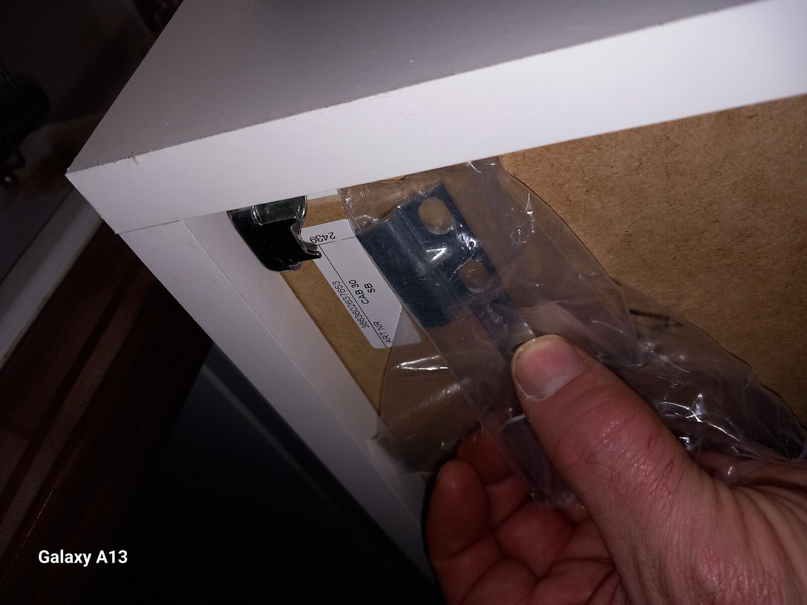

Yes but that's the wrong way round. You'll screw that bracket to the wall through the preformed holes so it will end up that the side your thumb is touching is what is against the back board of the cabinet
Dunno what GP is, maybe "go"?
No, you can't compress insulation, because it diminishes its effectiveness. You ought to be striving for 270 mm of wool up there, not compressed. Compressing insulation too much can also have a detrimental effect on your ceiling plasterboards. Consider loft legs or thickening the joists to get a void of 270mm+

So the bottom unit has been there years before moving in. The top unit won't be resting on bottom one. I think this is a stud wall as I knocked both sides and seems hollow. If it was dob and dab, it wouldn't be hollow both sides, would it? Does dot and dab have batons the plasterboard is screwed to?
Is the best solution (as suggested above) to cut out 100mm high plasterboard with plasterboard saw and replace with 100mm high ply (9mm same as plasterboard) thick as long as unit then screw into joists (which I should see when plasterboard is removed?

I'd maybe think about doubling the ply up between joists so it's 18mm to screw into, while remaining flush

On the subject of the post: You can get long brackets that th hook in the back of the cabinet fits over. It makes positioning the cabinet easier, and comes with plenty of fixing points so you might get away with multiple umbrella fixings in the PB. If there is the right gap between the back of the PB and the block wall behind that corefix fixings are good
If there are studs, and you cannot find them by tapping or viewing for shadows, drill a hole in the plasterboard where it will not be seen once the cabs are up, and insert my Special Tool, pushing it sideways in the cavity. If the end hits a stud, mark the distance on the tool. Test to both left and right.
I can sell you this Special Tool for £50 plus p&p, or you can make one by straightening out a wire coat hanger.
