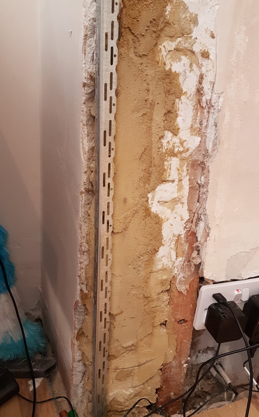

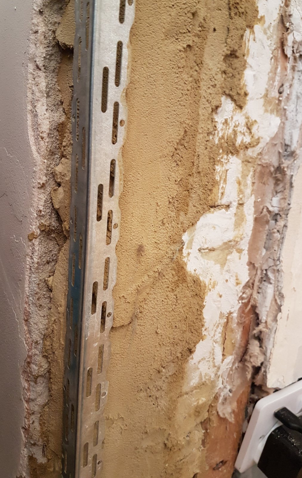

Hi, i've repaired this section of wall and built up with sand/cement.. i need to bring up as a finish filling a depth of around 2.5cm and then paint same as rest of the wall... whats the best method?
Thanks in advance!

Bonding plaster to bring near flush with existing, let it take up for a couple of hours then a skim coat of finish.
Thanks in advance!
As ker-plunk, but ensure your finish corner bead is level with the existing plaster you want to work to.
In the picture it looks a bit low.
Put a straight edge or spirit level on the existing plaster and over the bead to check
