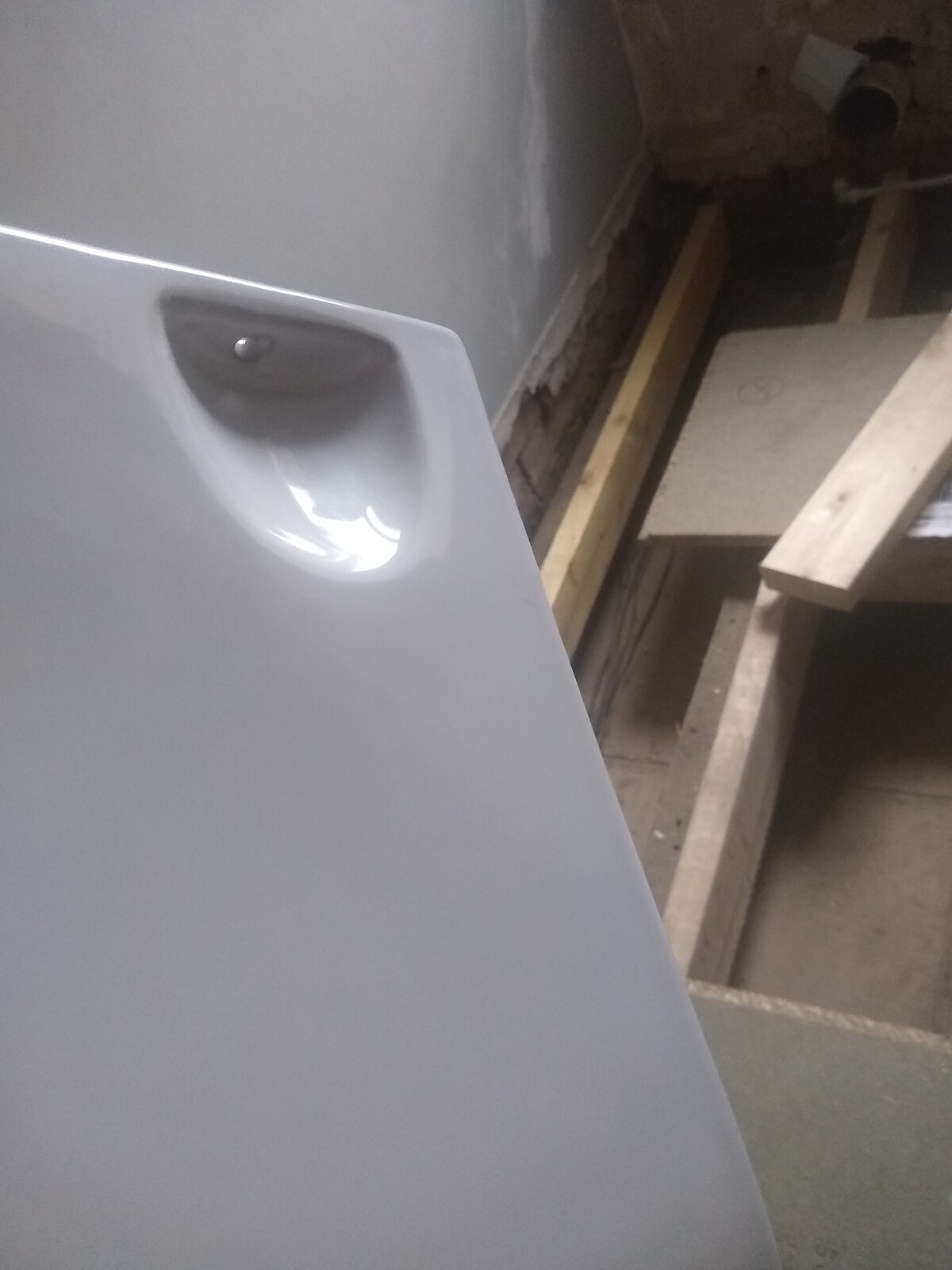

Here is a picture of the exact semi pedestal I've got.
You can see that it must fix by the screws at top of pedestal either side?

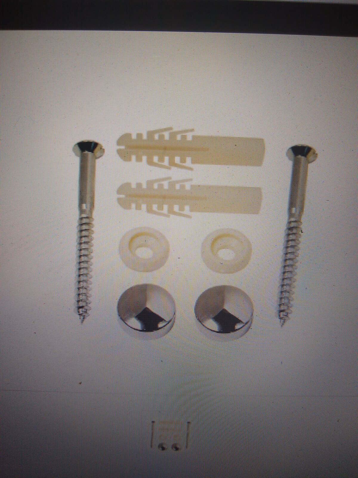

It's it's through the top then the standard pan fixing with the caps, again if the holes are large enough, would be the one's I'd use. Again though, it can't carry any weight. It's not designed to carry or level the basin.

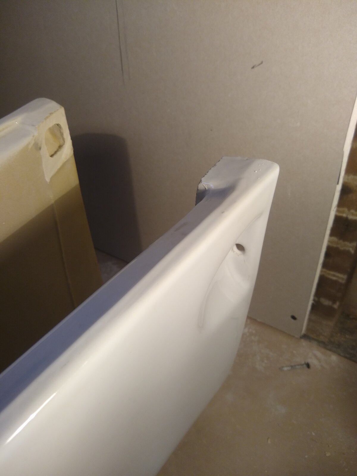

Here is a pic of the semi pedestal the scree goes on the outside top fixing, but there is a gap on the inside edge (can be seen top left) - is this for a spring?
Yup just avoid overtightening the screw when the plastic cap holder is on it otherwise it can deform/crack and you won't get the chrome covers on. You can get a kit with white covers too.
