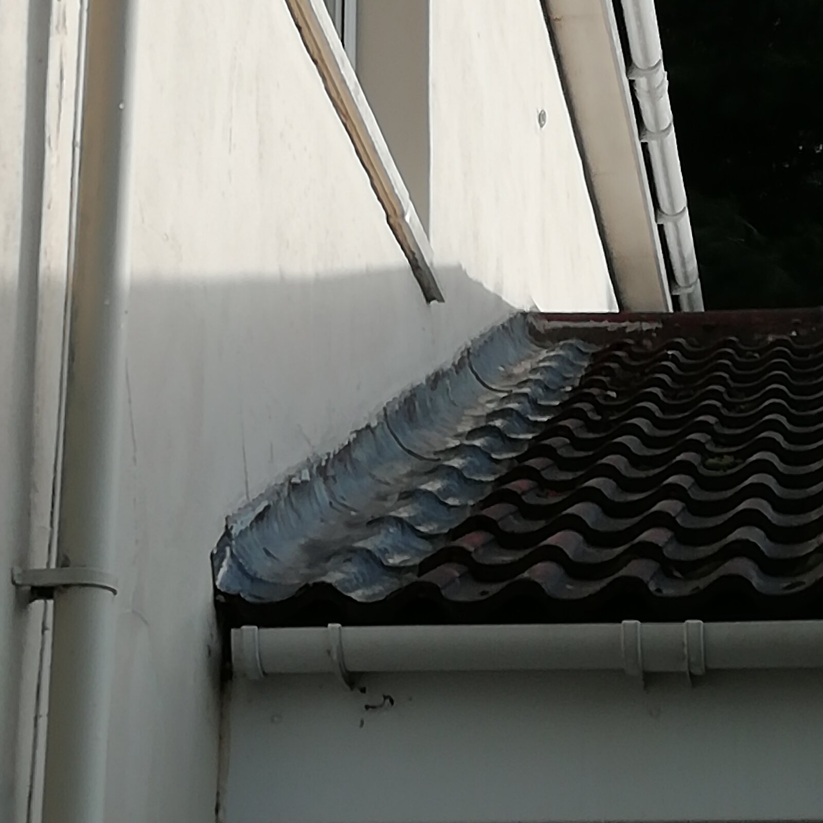

We have a conservatory (south facing) with interlocking profile tiles. A cover flashing was applied on roof construction with no soaker or hidden gutter. The lead did not extend the required min of 150mm and conservatory was suffering from water getting in whenever a southerly wind. Due to cost the length of cover flashing was increased with a Flashband type product to around 220mm. This has helped however when strong southerly winds rain is still getting in. I can extend Flashband further as at present it doesn't extend over a full interlock section - however this would be approx 300mm which might look odd. I could have soaker installed but likely need lead all replaced at same time as Flashband is now fixing it down (1k +) . As leaks only occur once or twice a year when conditions are perfect I don't particularly want to spend thousands. One option was to try expandable foam underneath the rafter... ? Any thoughts welcome. I will try to post a pic. Thanks in advance.
