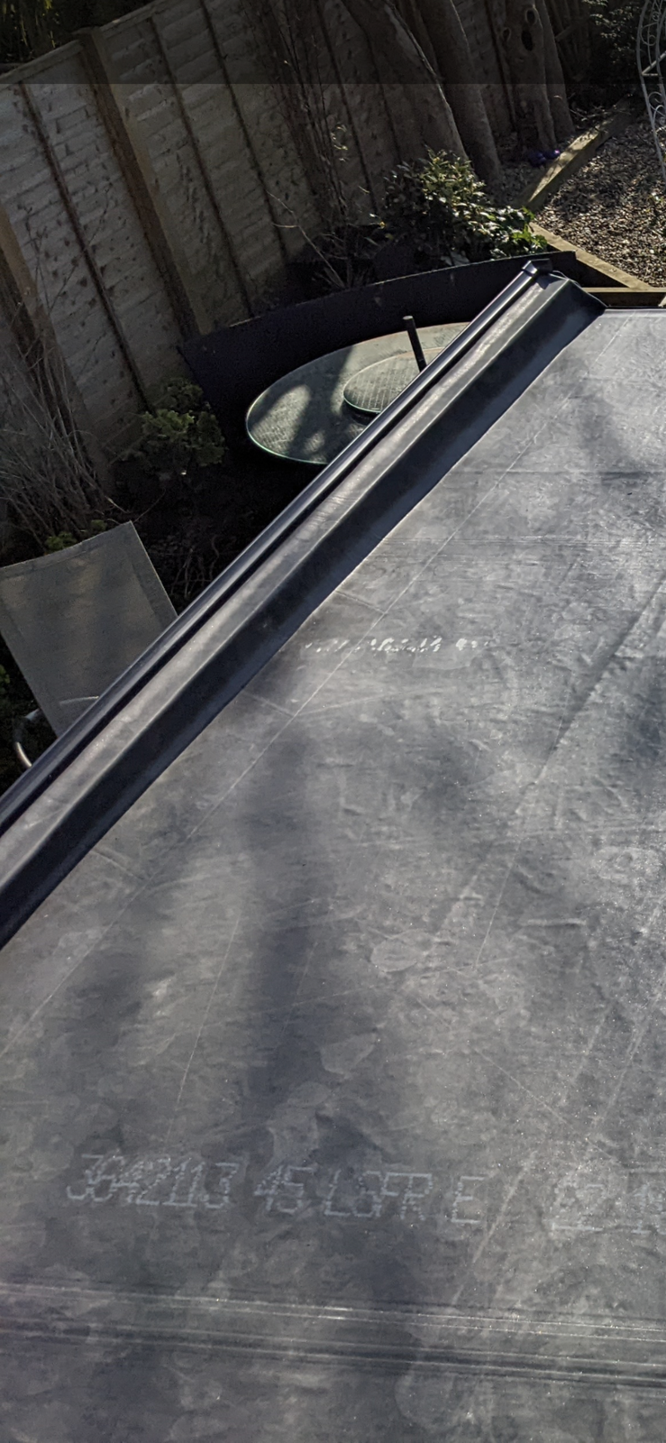

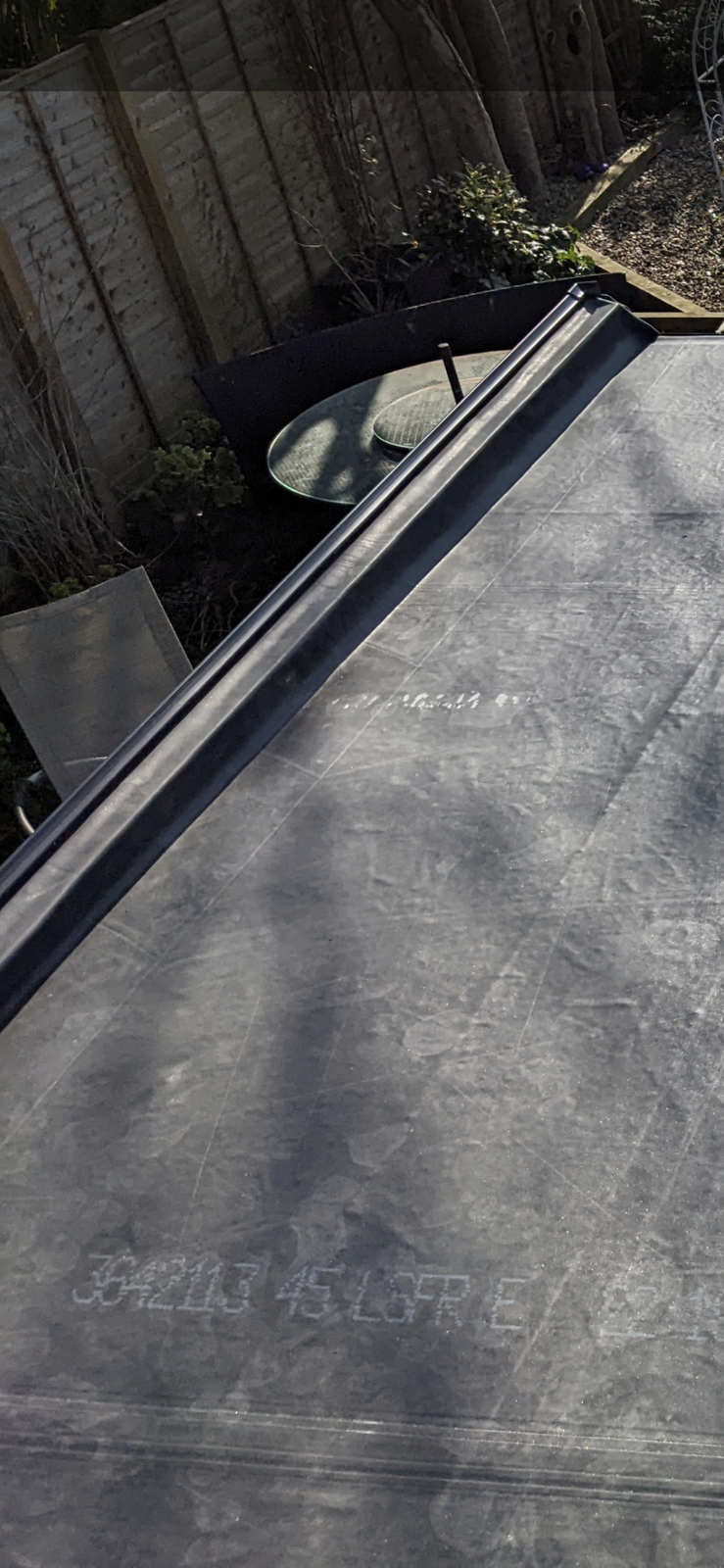

This is pretty much what I did at one edge in order to get the fascia level. I think it looks pretty neat. Sorry, not got a clear photo from below.
Yep thats looks like what I will have to do which seems silly as the whole point of the edge trim it to do away with the up-stand!
