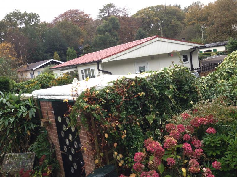

That shed has a plywood flat roof that needs to be weatherproofed

Hah- the joy of families. Is the roof actually flat or does it have a fall?
If it's truly flat then GRP might be a good bet. Easy enough to do and no worries about setting the place on fire with the blowtorch. Doing the edges would be annoyingly pricey with stock trims though.
If it's got a fall then you'd get away with shed felt from wherever, some 3/4" clout nails and some battens round the edges to stop the felt flapping in the wind and form a bit of a drip edge. If you need to join the felt, make sure the join is across the fall line (so water from the top sheet will naturally descend onto the lower sheet and away).
Cheers guys
It's about 8 ft x 6 ft with a slope. Construction is 18 mm new plywood .
I'll have a look at Epdm on google. I never considered nailing roofing felt on as I thought it would not be strong enough for a longer lasting job
I just assumed I would be fixing something with a blowtorch like I've seen on extensions or small sites
Where in staffs? Our supplier is in North Birmingham and they have an EPDM fitter not far from staffs, we've used him 80 a day cash and he could do that roof piece of cake.
