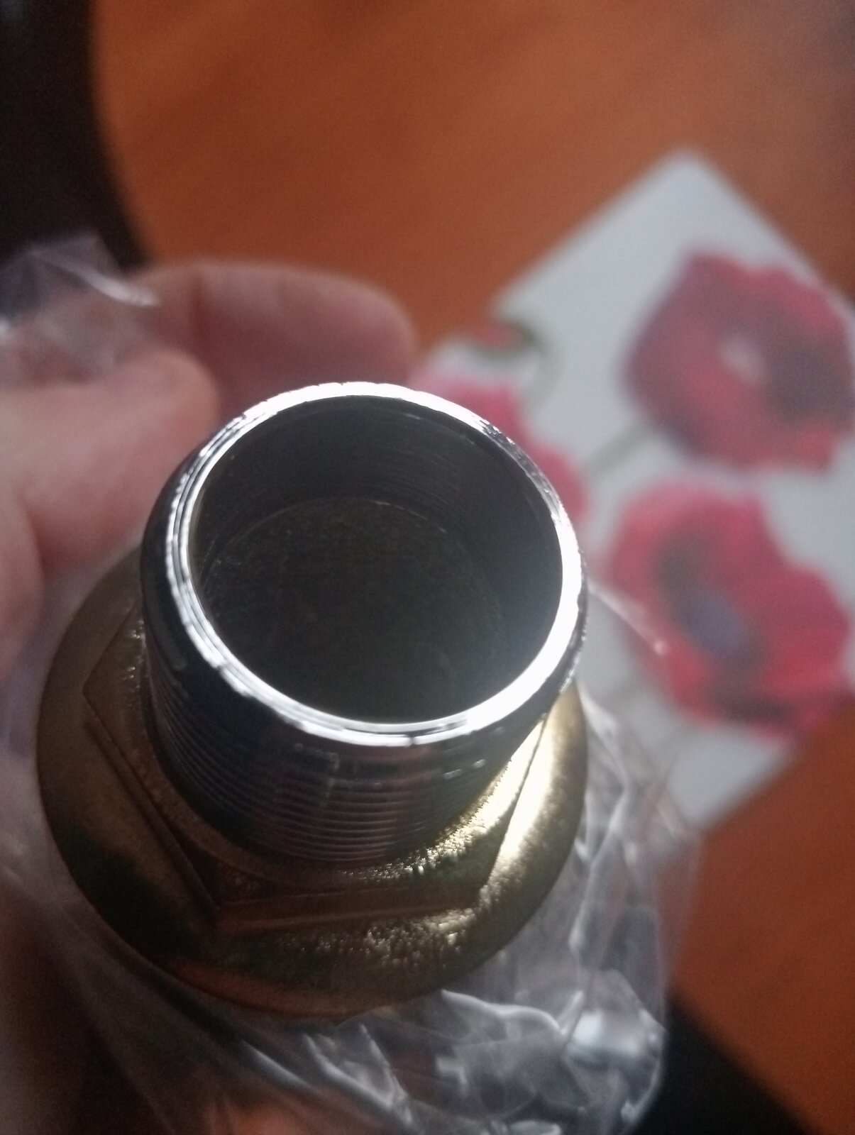

If using Hep2o plastic tap connectors, do you use the flat washer or concaved one that comes with it.
This type
Guess it depends if the tap face is flat, then id if the flat washer. If it tapered, alot of taps seem to be now. Id fit the concaved washer?
Some tap legs have with a fluted end, like a compression fitting, they would take the angled washer, where some are just square and they would use the flat washer. In real terms though, both would probably work just as well.
Thanks yes alot of taps now have a fluted end so you could connect on with a nut and olive? Though be hard to get enough force to tighten with a tap spanner
That's flat so would be flat washer?
