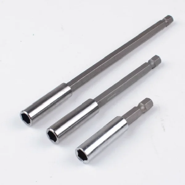

I needed to drill a hole in a worktop right up against a corner. 10mm hole that is 10mm away from each wall. 18mm chipboard. I tried with my drillbit, angling it slightly but it's made marks on the walls, much to the chagrin of the missus.
Is there a reliable or good quality flexible shaft that I could use with wood drill bits and a cordless drill?

Flexible drill shafts are really designed to either hold screwdriver bits or small burrs for detailed grinding, so I don't really think that they are suitable for the purpose you want to put them and at too high a speed they might be a bit dangerous (as they don't really have a proper grip and might therefore slip sideways in use). They also lack thrust bearings as a rule. Whatever else you do need to punch a starter in the laminate using something like an awl (or possibly s hammer and centre punch) to give the drill bit point somewhere to locate and so avoid the bit skating across the top. Having tried this sort of thing in the past I'd have to say that you are probably better off moving the hole slightly out from the wall so that you can get your drill in and use a long bit or bit and extender. The alternative solutions of, say, a Makita angle impact driver or a Bosch/Milwaukee/Festool cordless drill with an offset drive head would work, but are prohibitively expensive for one-off jobs

10mm spade bit in 300mm extension bar will get you high enough to avoid damage with drill.
Drill from below if you have a void .
