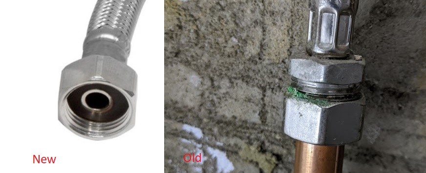

Fitting a new tap but the new flexible connector is a screw on with silicon seal , like the ones that go into a washing machine etc, rather than the old flexible one that sealed to the pipe with a nut and copper olive. Any idea of what adapter I can get, did think of maybe using an isolator valve but they have olives for their seals so probably not correct.
Just came across these and assume they'd be fine to connect to a 15mm copper pipe and my new connectors? https://www.amazon.co.uk/Pipestation®-Bolofix-Faced-Isolating-Connector/dp/B06WRQDWNC
Fine ,as long as the thread on the flexi is 1/2 in BSP and not 3/8in BSP.
