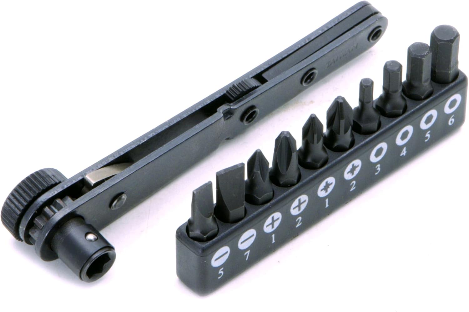

Use one of these, much better. surprisingly good bit of kit.

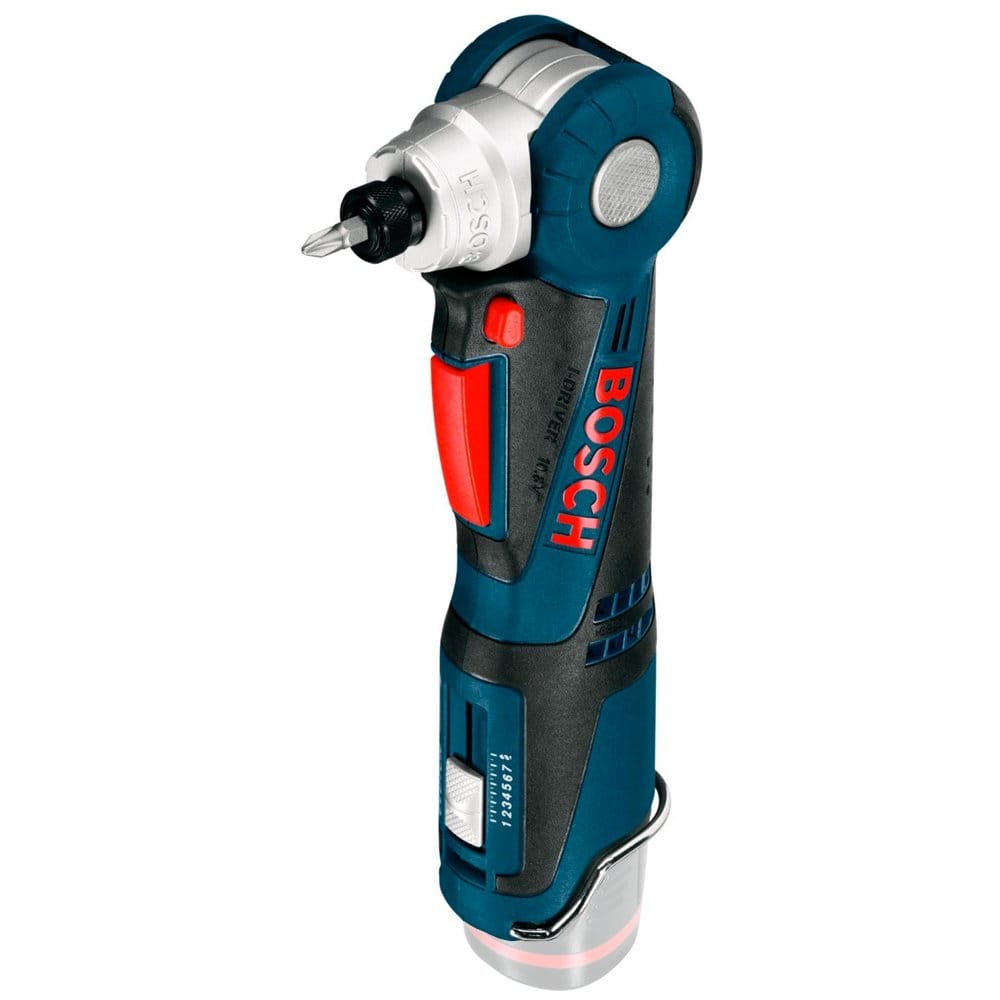

had this on my list for a while now

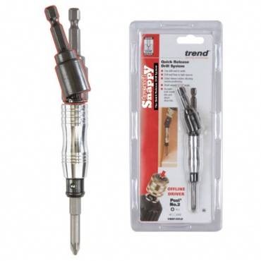

I have something similar to the one the OP is talking about, it rarely gets used because it is a PIA to use. Mine is a Trend Snappy one and cost less than the OP's one (about £15). I doubt it was worth it

I also have a couple of extra long screwdrivers (CK brand, PZD#1 and PZD#2). Next, I have a Trend Snappy offser driver - a sort of bit holder with a universal joint in it.

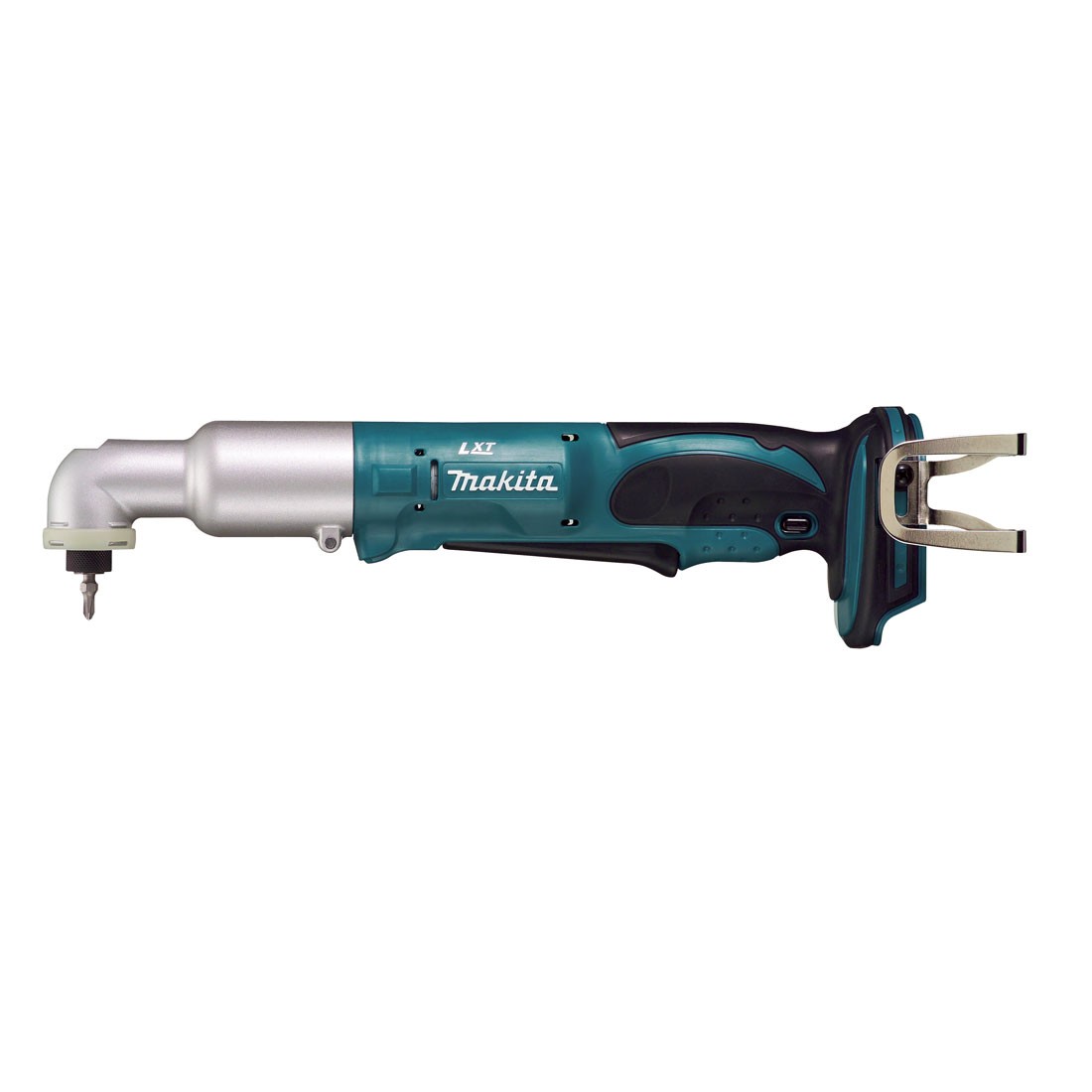

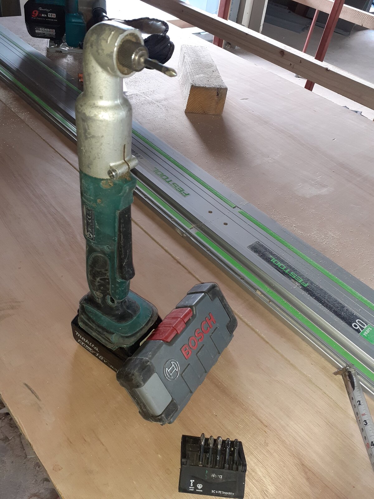

Then, if that doesn't work, I have a Makita angle impact driver, generally used with 50mm long bits.

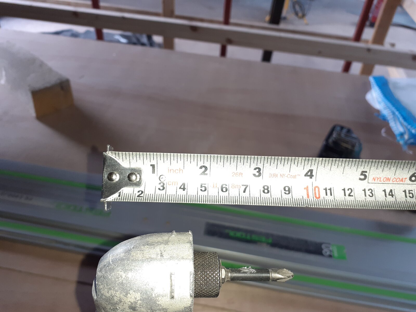

Whilst mine (above) is hardly pristine, the fact that with a 50mm bit in it I can get it into an 85 to 90mm deep space (below) is very handy at times. With a 32mm bit you'd get another 18mm to play with (72 to 80mm gap)
