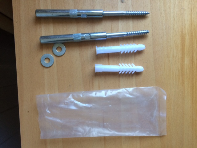

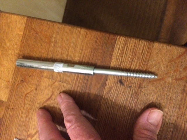

Floating oak beam - bent supporting screws
Looks like a resin anchor to me (including some resin still on the threads, so it wasn't well installed IMHO - and BTW it was installed wrong way round because the square should be at the outer end so you can get an adjustable spanner onto it). Best replaced, although for non-structural work threaded metric rod will do the job just as well. Needs the holes on the wall to be redrilled (2mm bigger diameter than the threaded bar) and new resin squirted in
I think that is plaster they dropped on the thread, I could be wrong though.
So I'm clear, I can straighten up the bolts, drill new holes and then fix it in place with with the resin?
Don't attempt to straighten them - it rarely works - just replace. Other than that, yes, but please note what I wrote above. It isn't complex, but you do need to avoid being slipshod when you do these things.
Thanks JobAndKnock. I'm just using the fittings that are supplied with the shelves, this is what they send you :
They're only small shelves, won't hold any weight so should be ok.

You don’t use rail plugs with resin.
Rawl plugs expand as the screw goes in
Resin “glues” the rod in place
drill the hole and vacuum the dust out. You need a good hole for the resin to soak in and then be squished out as the rod goes in
