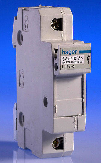

Adam_151 said:
I reckon thats an ELFI of about 1.8 ohms , well in for a C6 or B10, but I wouldn't use a C10 without a direct measurement, also definatly well in for a 5A BS1362
I was reading this just now, thinking "wouldn't a cartridge fuse holder handle these surges better?"
Ditto.
Thats why I suggested using a 5A Switched Fused Spur in my previous post!
I did'nt suggest the HRC carrier as it was not specified what consumer unit the person had , other that Wylex. I'm assuming its one of the newer NH type (which use NB MCB's).
As far as I am aware I think the HRC carriers only fit the older NS type units but somebody will probably misquote me on that.
Please note not all consumer units have compatible fuseholders available instead of breakers.
