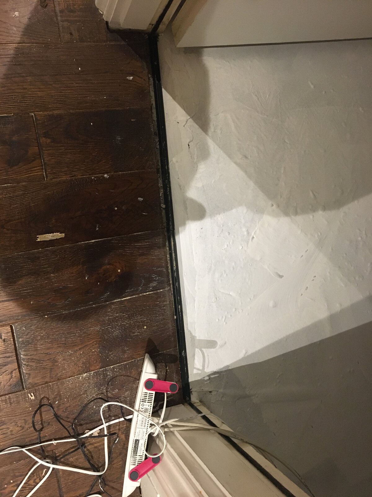

Because of the slightly wonky layout of my old flat, the wood flooring in my hallway meets the door to my study at a bit of an angle. I’m going to be fitting the same wood flooring in my study next week (hopefully). Is it best to have the pieces of flooring aligned with those in the hallway (which will mean it’s not straight with the study walls), or vice versa ie straight with the walls but then at a slight angle to the hallway? Or should I do something different, eg have the flooring in my study at 90 degrees, parallel to the door threshold?
(see attached photo)
thank you
In the hallway you should have laid it length ways and straight down the centre so any wonkiness would cut into the walls. this will mean it would have been straight at the threshold.
Multiple thresholds, all of which are wonky in slightly different ways. It would be mathematically impossible to do what you suggested.
