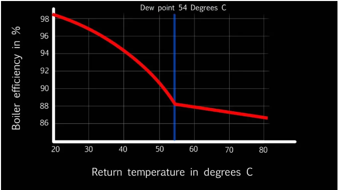

As regards efficiency, the science is pretty straight forward. The lower the return, the more efficient.
But the best temperature for your needs may be different in practice, and you may have to sacrifice some efficiency.
I don't know whether you have seen one of these type of graphs before?

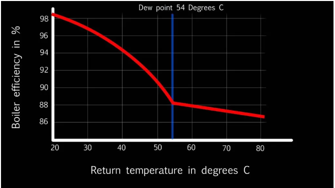

So, if I have 65 degrees on the flow as it's set by the engineer, and below 54 on the return I should be ok, correct?
Or should I aim for the 20 degree drop by better balancing the radiators lockshields?

It would be useful to know what the current return temperature is. Some Logic combis have a built in menu where you can check the return temperature. Do you know if your boiler is either a Logic Max or a Logic+?
For the best efficiency, you want to get the return as far below 54 as possible. At 54 there will be almost no condensing. Better balancing might reduce the return temperature. But older radiator systems can't always achieve that. Do you know how old your radiators are?
You could also try reducing the flow temperature to see whether you can cope, because that will definitely reduce the return temperature. There have been a couple of posters, however, who had Ideal Logics where at lower flow temperatures they got a lot of very quick cycling.
