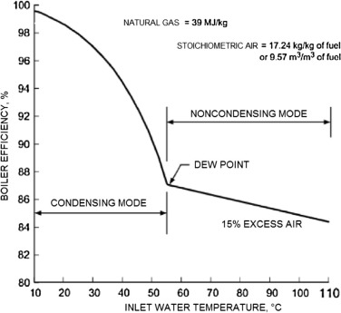

You can see the effect of low boiler return temperature on boiler efficiency, below. Condensing only just begins at a boiler return temp of 55C.

As johntheo5 said, that is true with regards to oil. Net/Gross figures which are the difference between heat of burning the fuel vs heat of burning + latent heat of water produced by combustion products are where condensing appliances get their additional efficiency from if running at optimum temperatures. The likes of burning Hydrodgen directly (which the main combustion product is water) gives around a potential for 18% additional energy if its fully condensing.

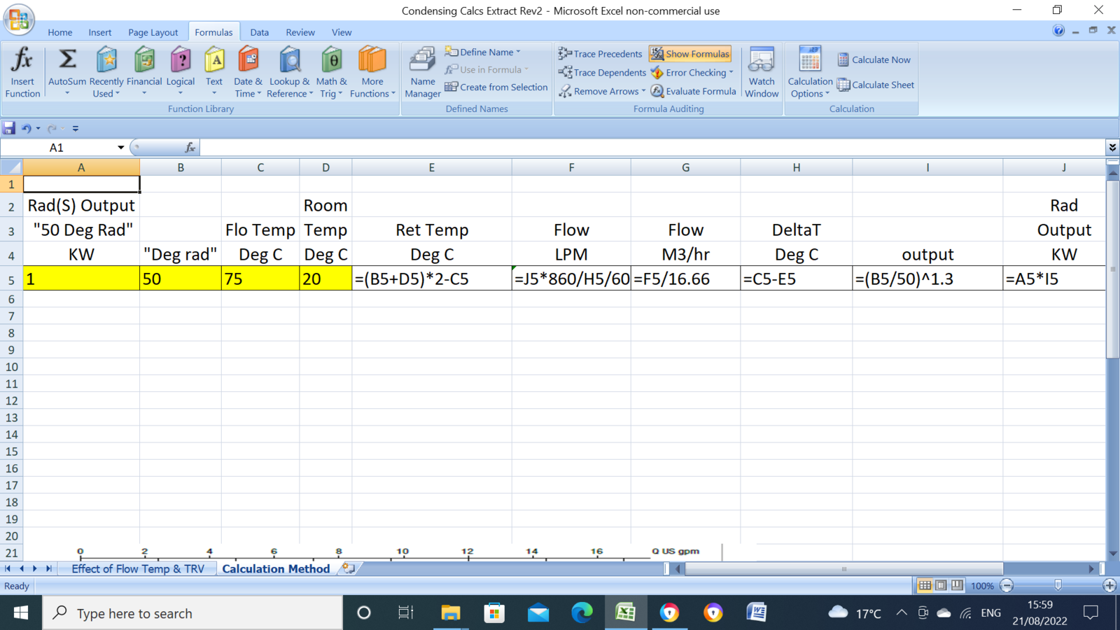

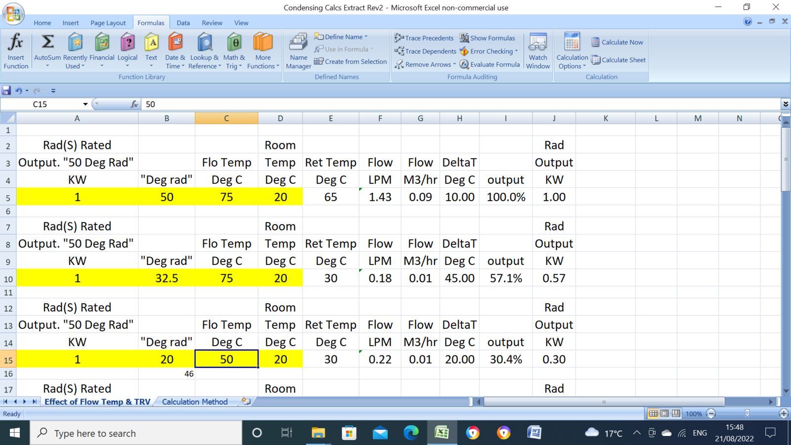

All very interesting, the effect of different flow temps, return temps, flow rates can be seen on here, calculation method also included, if interested. Outside temperature compensation + TRVs can give good results IMO as the TRVs will do the flow control.
