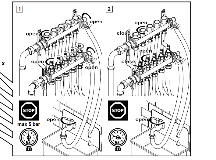

Flow meters all at zero on Uponor Vario S UFH manifold.
Hose pipe in the top from tap - drain from bottom into bucket.
as per this .
Its shown with the hose pipe in from the bottom and drain from the top but cant see this working if the flowmeters are still installed?
No air bleeds anywhere. Thats the closest I can get for pics as the unvented cylinder is in the way.
And you connected the hose from the tap to the top manifold and not to the bottom, as shown?, (incorrectly IMO, if the flow meters are installed, as they might act as non return valves when the water tries to flow upwards through them?)
If you refer to my previous photo you will see that the flow meters (where i attach the tap hose) are at the top, and return vaves are at the bottom, which is where I am attaching the drain hose.

Think I have solved this. The T ball valves are not completely closing. Big job so will probably leave it till after Xmas
