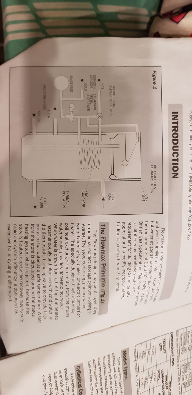

I have a 180l flowmax thermal store on my first floor, water heated by my boiler on the ground floor and returned to storage where it is also used to heat radiators when required and provide mains pressure hot water via an internal coil and blender valve, open vented system.
I've read lots of posts and I'm now confused is my system classed as direct or indirect?
I've attached an image of my exact set up, no other f&e tanks or header tanks anywhere.
Thanks.

it is a
180 Litre - Range Flowmax Copper Direct Vented Thermal Store Combination Unit
The F&E tank is the little tank on top of the unit, why do you ask
Yeah I understand the f&e is on top was just putting as much detail into post as possible.
Reason for asking is I've been advised to flush my system with sentinel x400 and it says on bottle can be used on all indirect systems.
Wasn't sure if that meant you couldn't use it on direct systems?
yes you can use it on your system, the word direct is confusing in that context, traditionally a direct HW system was something completely different, why have you been advised to flush the system ? what problems are you having ?

FYI, your system is indirect. Direct and InDirect reffer to how the Hot Water is heated, although your thermal store is directly heated with circulating boiler water, the Hot Water for the taps is InDirectly heated via a coil in the store so its ok to use chemicals.
