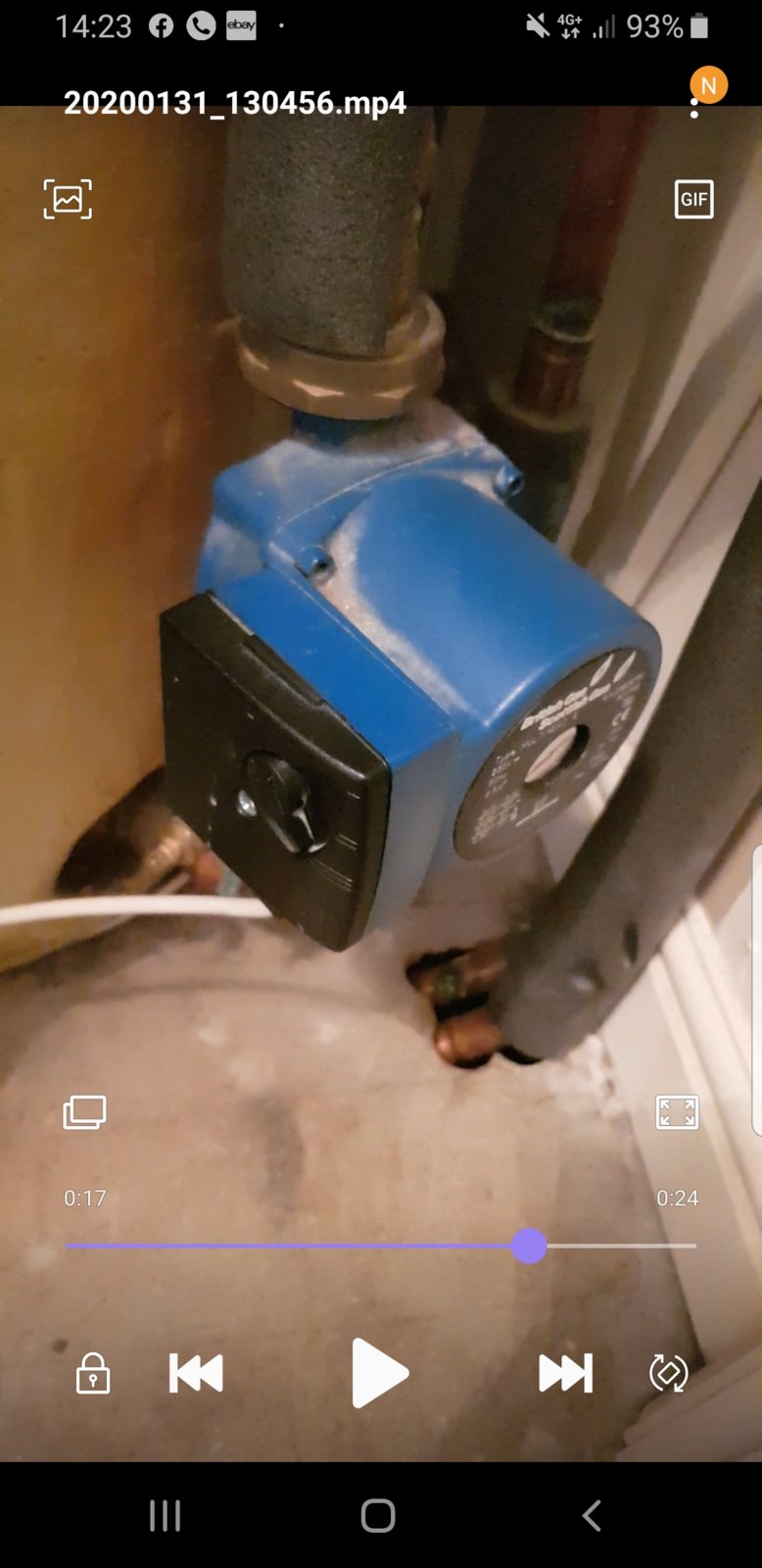

Cleaner is in, cleaned filter yesterday small amount of sludge. Noise is obviously still there wasn't expecting it to go over night but when I drain it next I'm wondering if its worth chaging circ pump, if that's possible problem before I spend money on inhibitor and wasting it draining after.
Noise is once again only when demand is high and what I'm guessing is full flame. If I reduce temp set point and bring it up along with the tank temp, no noise it's only when there's a large difference and boiler is trying to achieve tank temperature as per set point on boiler.
If the pump was the problem why would this only make the noise when on full flame as once boiler throttles back noise is gone and everything ticks over quietly.
When the noise is heard if I slow the pump down it get worse?
when you have the system drained remove the pump head , it is simply 4 x Allen bolts and will pull off, check for debris in the impeller and pump body
Great idea, I've attached an image of my pump so just pull off front and check, after electrically isolating and draining of course.
yes exactly that ,your pump also has isolating valves either end for removing without draining but I think you have ballofix ones and not gate valves, if you do have ballofix ones dont touch them or likely they will leak, your pump is stamped BG but is actually grundfoss
Cheers again, I'll give that a look at. If it was pump related any idea why it goes quiet once upto temp?

As the system heats up the boiler modulates down, so producing a lot less heat so the boiler will be quieter
Ok yeah when I think about it if the boiler is noisey this will be emphasised by the pump? So sounds more boiler related than pump but I'll check them all the same.
the pump circulates the heat out of the boiler so if the pump is not set correctly and running correctly the heat cant get out of the boiler fast enough so the boiler gets noisy
