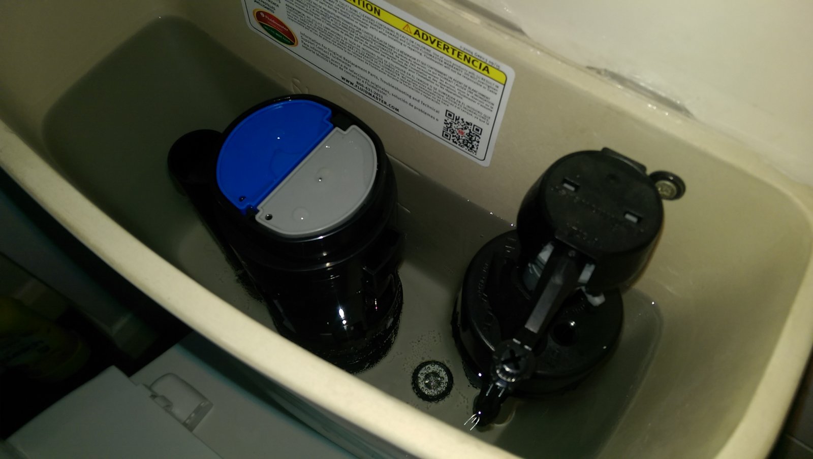

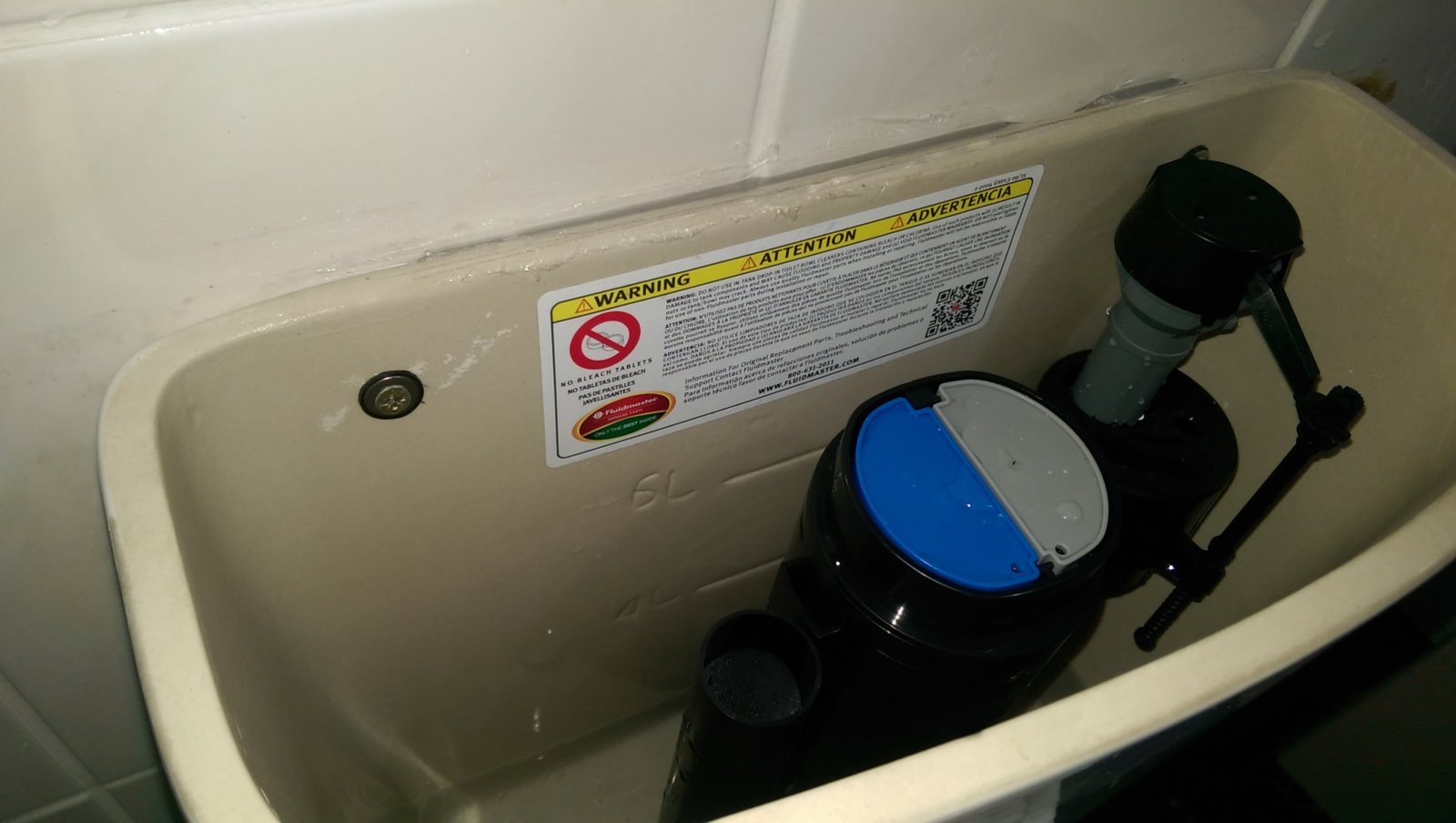

photos may help
including inside the cistern
before and after flush
I'll take a pic if that's the only way, but before the flush the water level is at the 6Litre line on the tank and after a full flush, the cistern is nearly empty. If I press the "small flush button/4l" it dumps about 2/3 of the water only but again very fast.

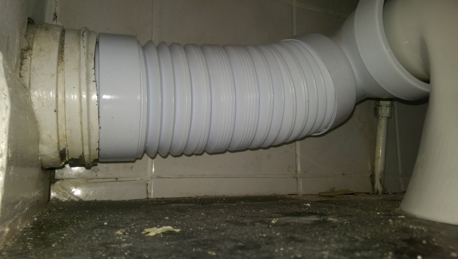

it will be interesting to see the route of the flexi pipe.
Pics uploaded. The toilet was admittedly a cheap one from screwfix but I was surprised to get a branded fluidmaster flush and fill valve for that money. Shame it just blasts the water out into the pan !

Nope, it can be adjusted for volume (how much) but not for flow (how quickly). The drop valve opens and lets a given flow out of the valve into the pan. You could cover up one of the slots I guess with a piece of plastic carton or something. Anything like that is just a bodge though.
I _think_ this is one of those rare cases where a "bodge" is the hopefully the right solution. Well, I suppose the ideal solution would be to fit a different valve but given the below took all of 30 seconds I'm very happy and thanks for the idea of using a piece of plastic.
I took a plastic bottle with a smaller diameter than the flush valve. Cut the top/bottom off then cut it lengthways. It hugged the valve quite nicely around 75% of the diameter and the flush now comes out at about the right speed and lasts for longer!

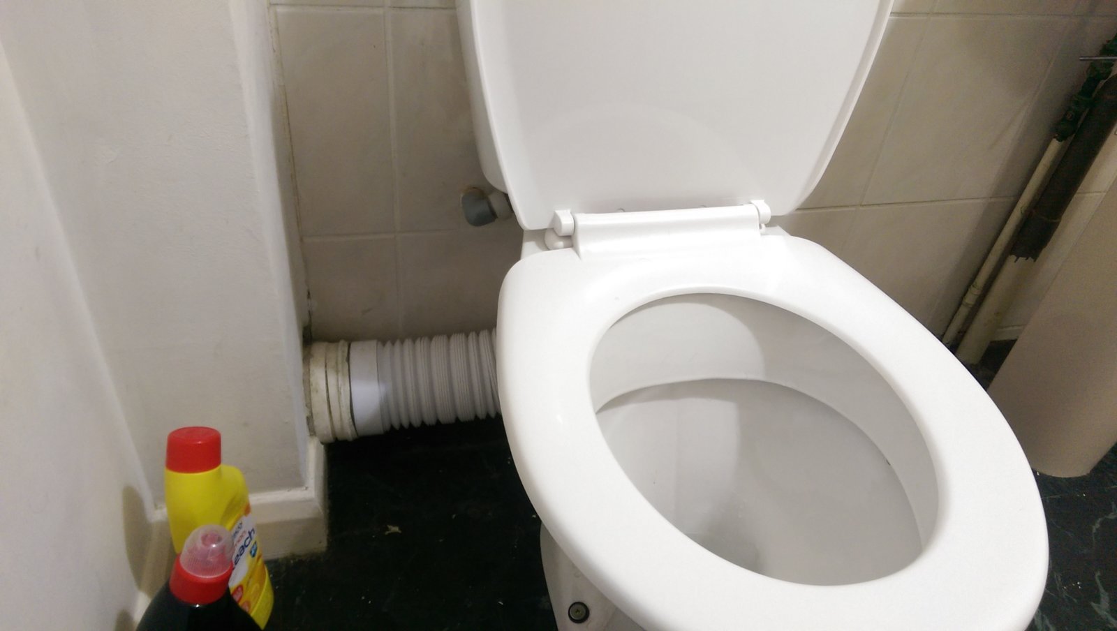

round the back, showing the slope starting at the pan.
btw flexi pipes are not as good for flow and trapped detritus.
Pinch off a pipe choker and upload a video of trying to flush it away! :LOL:
I’d say badly designed/moulded pan and poor waste pipework.
Dump valve is doing what it’s supposed to.
Agree, sounds like the flush is doing exactly what it should be, but the waste isn't coping properly.
You should be able to dump much more water than the cistern holds and not really see any significant rise in water level. 4" pipe can carry a lot of water!
Another pic attached. Taken with a phone resting horizantally on the floor. The water level doesn't rise in the pan.
