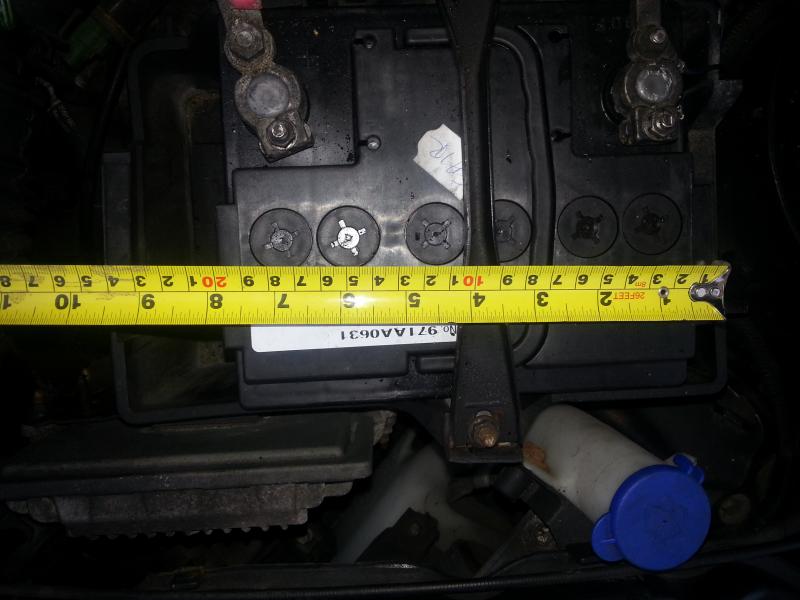

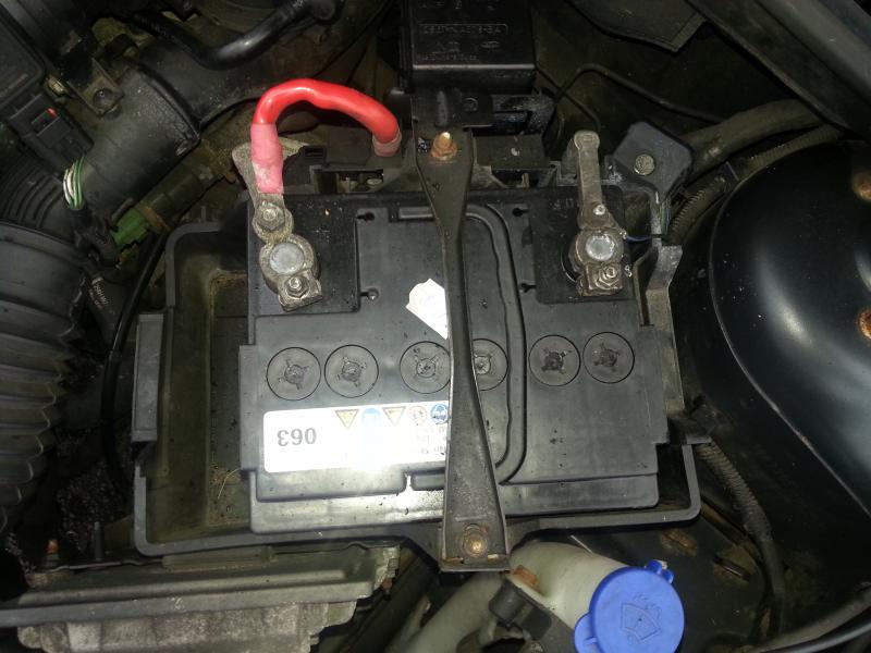

Come to think of it my battery does look new and a tad to small for the tray it sits on so ill check it out
Iv posted a photo tell me what you think?
Doesn't look right to me Berty. Aftermarket cheapo...? It might help to eliminate the battery by seeing if it still happens using another car's battery via jump leads, the donor car keeping the revs up.
