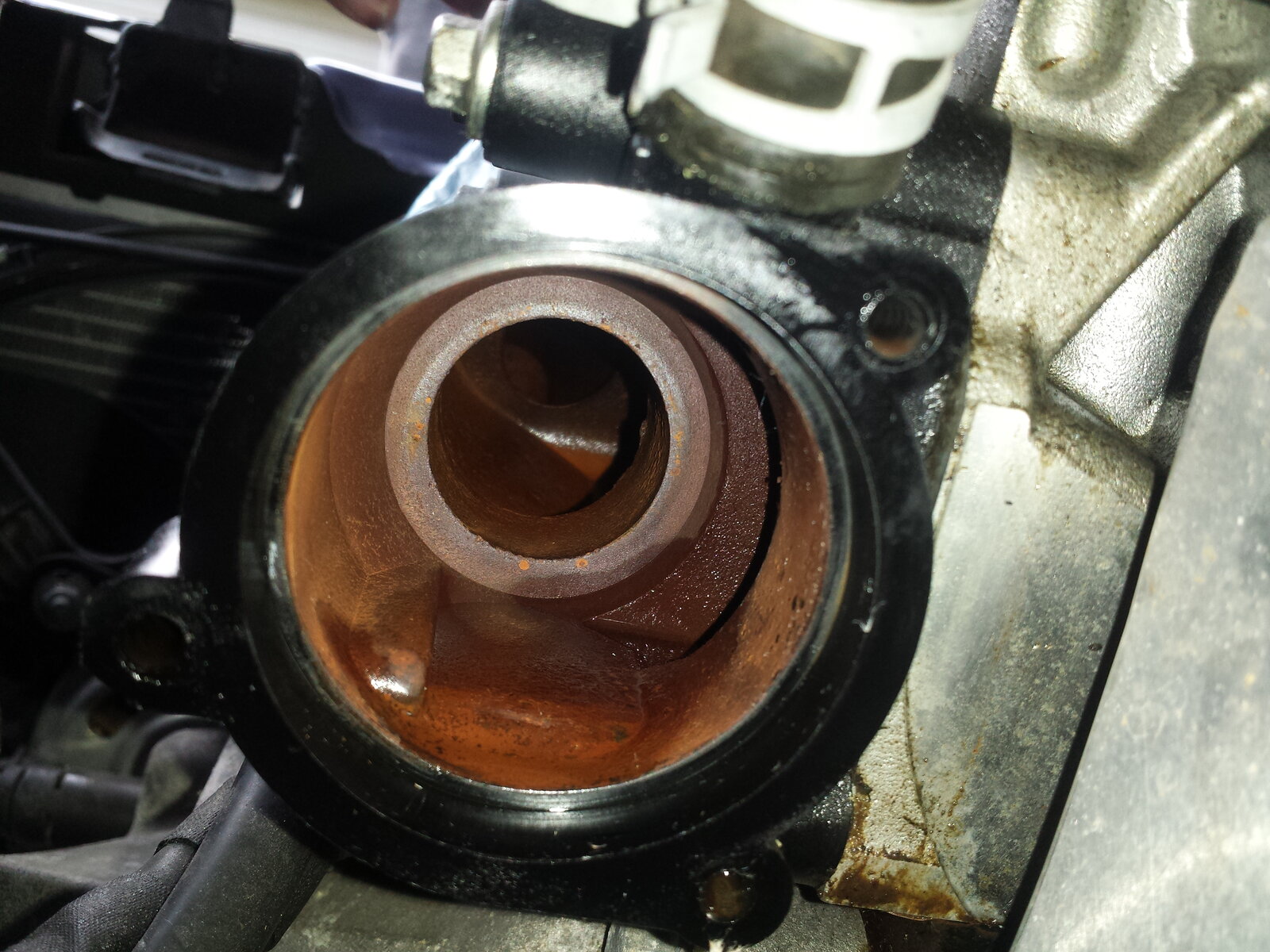

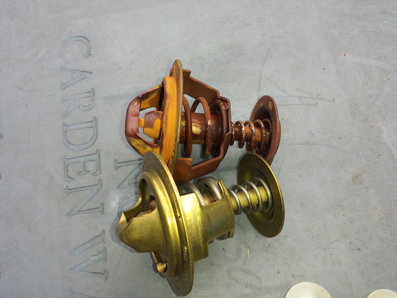

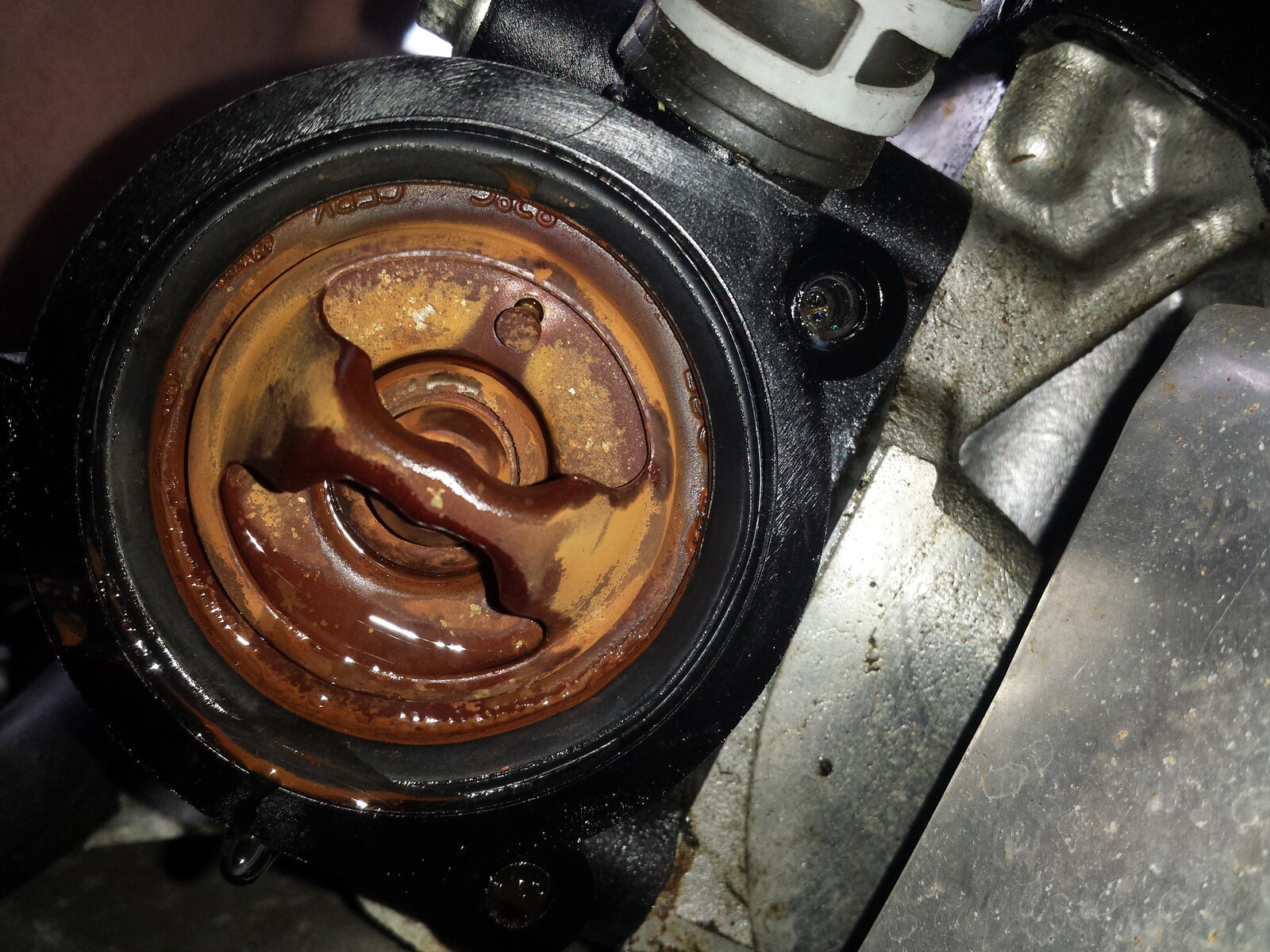

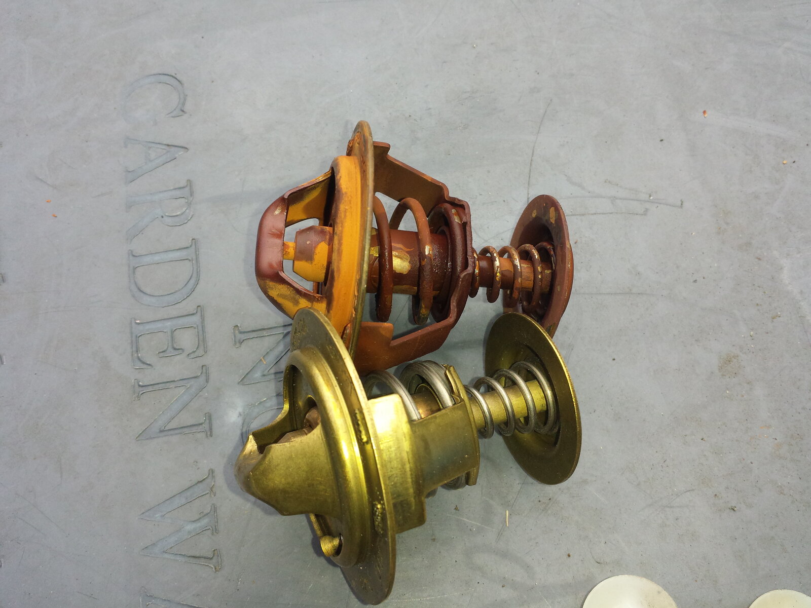

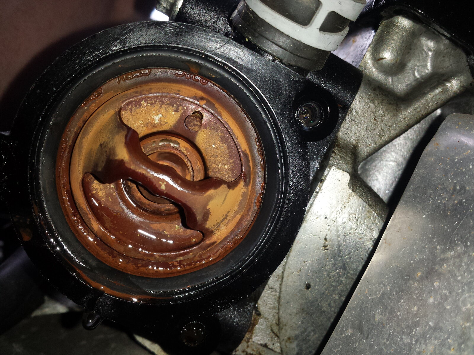

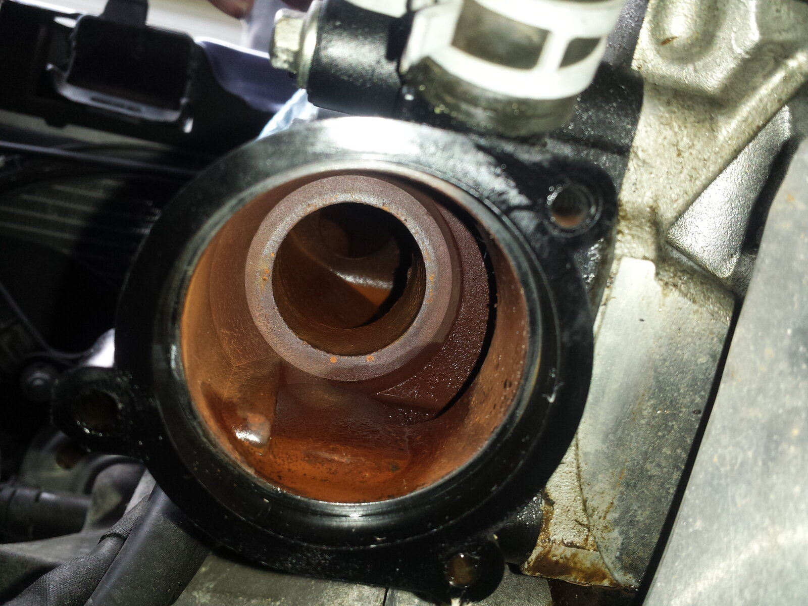

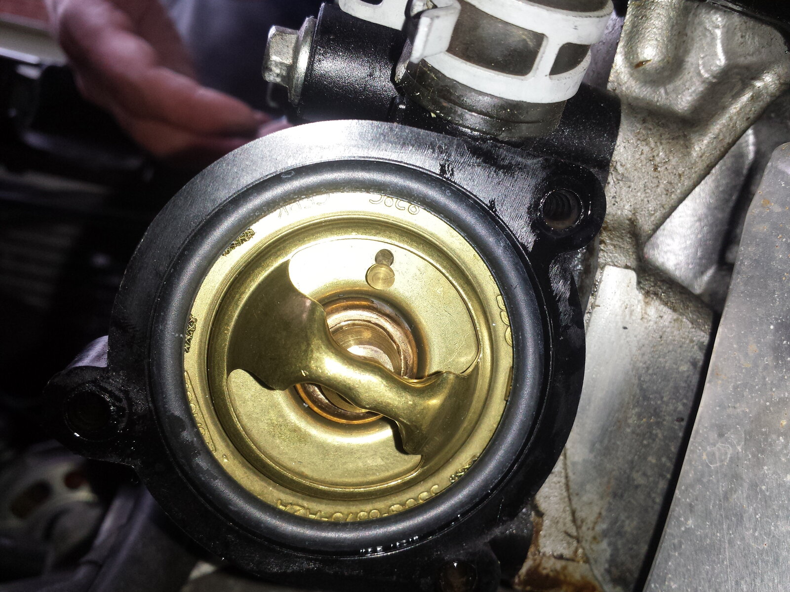

I then decided to do the thermostat, even though the old one was working. I was in two minds as to whether it was worth it, or whether I'd be opening a can of worms.
The retaining screws for the thermostat cap are horrible little things. They are metal screws (that are more like wood screws) and screw into a plastic thread/housing. Feels nice and secure but I was very paranoid about cross threading the plastic.
But, no leaks. Thermostat works.

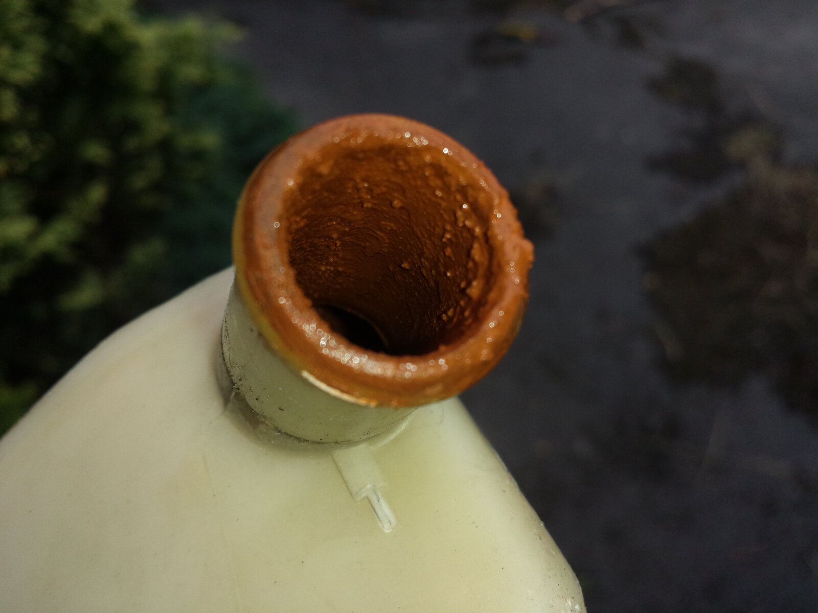

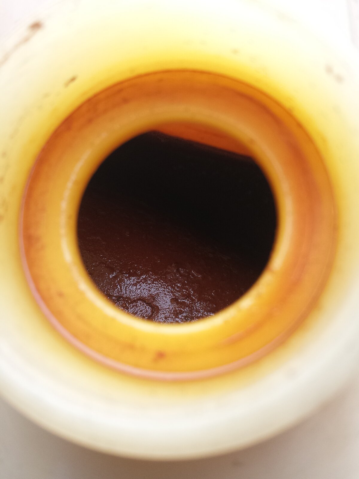

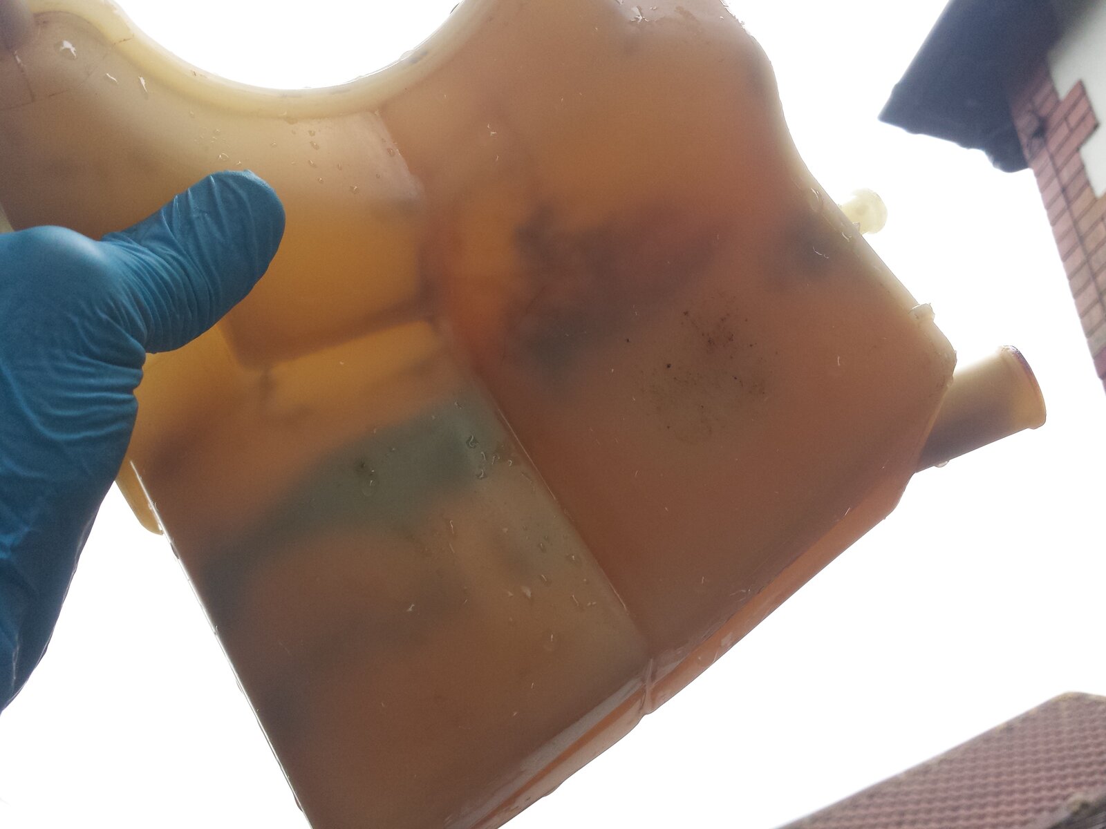

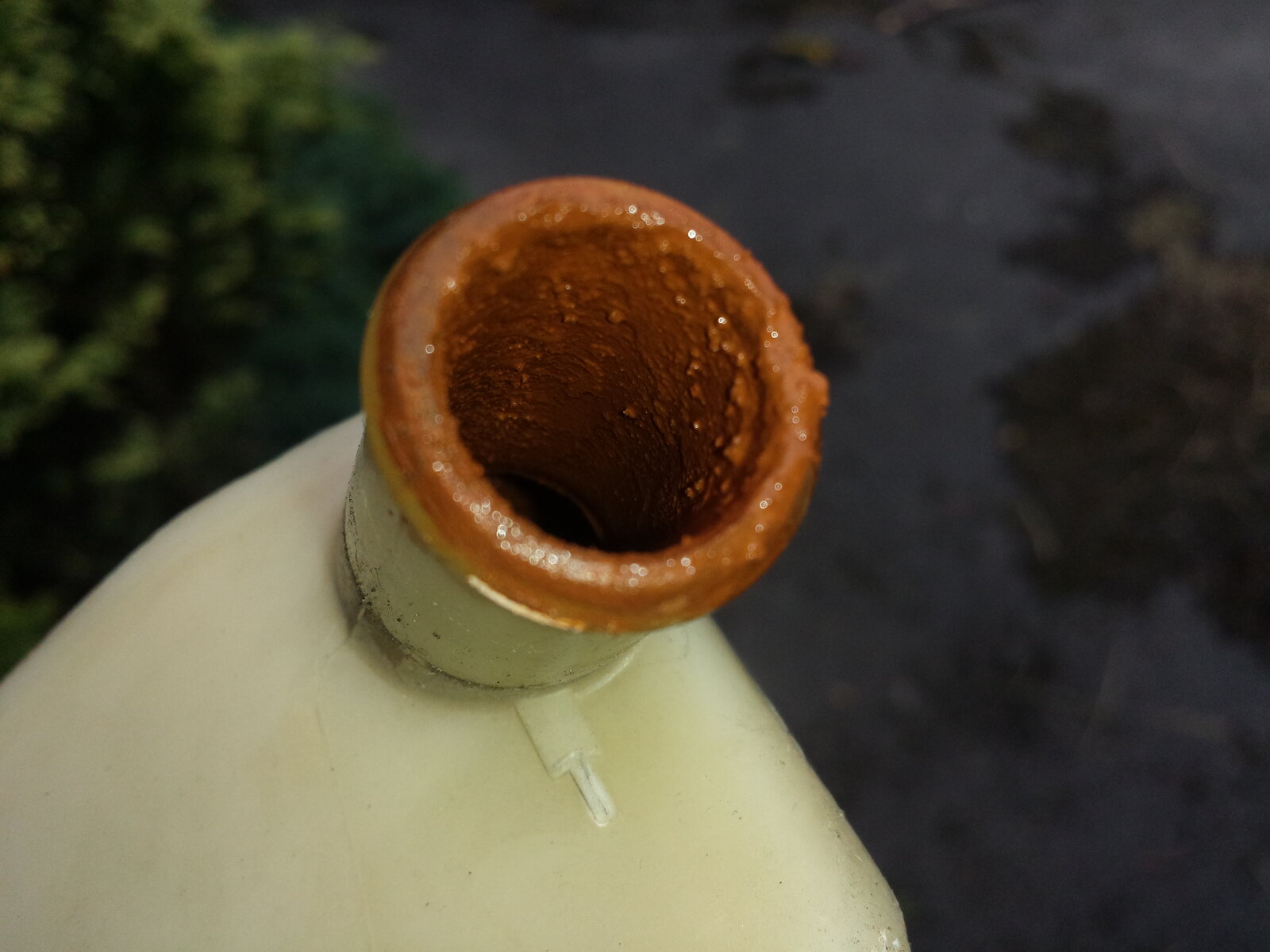

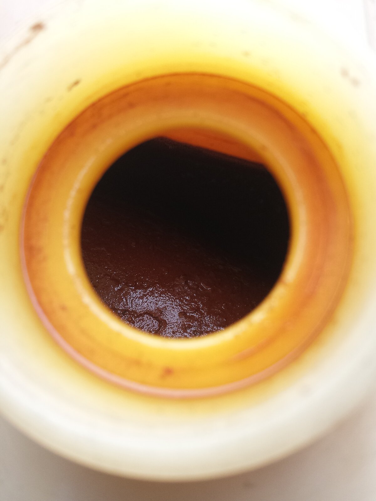

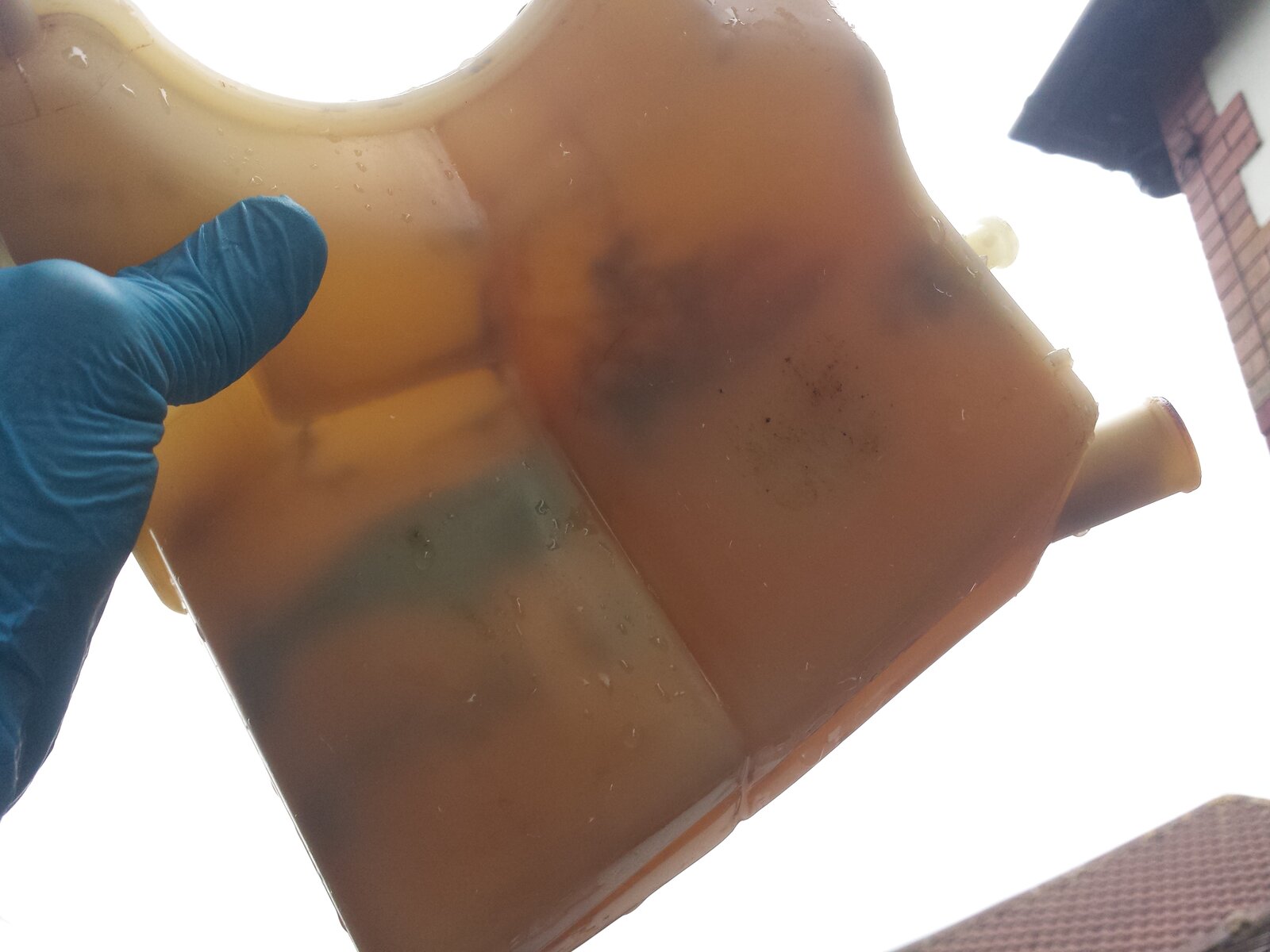

While I wait on the gasket to arrive. Thought I would post these pictures of how bad the coolant system was before I flushed it. Specifically the header tank.
Before
You can see how much limescale and debris seems to have built up over the years.
My best guess is that this car may not have had new coolant since 2012, and potentially only topped up with tap water since. You can see what looks like a solid amount of limescale inside that header tank, to the point where it is opaque when held up to the sun.

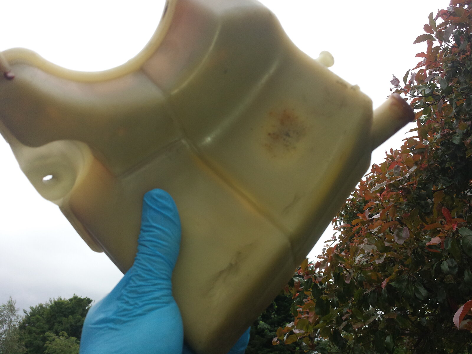

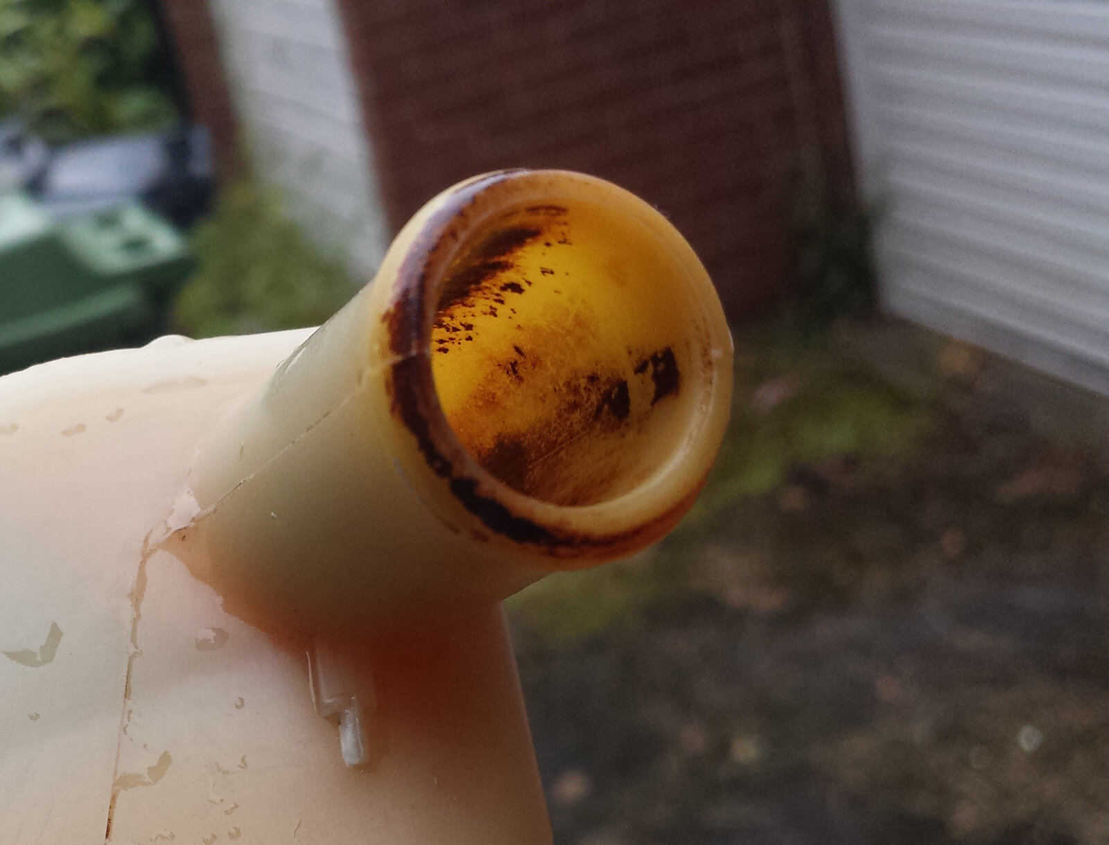

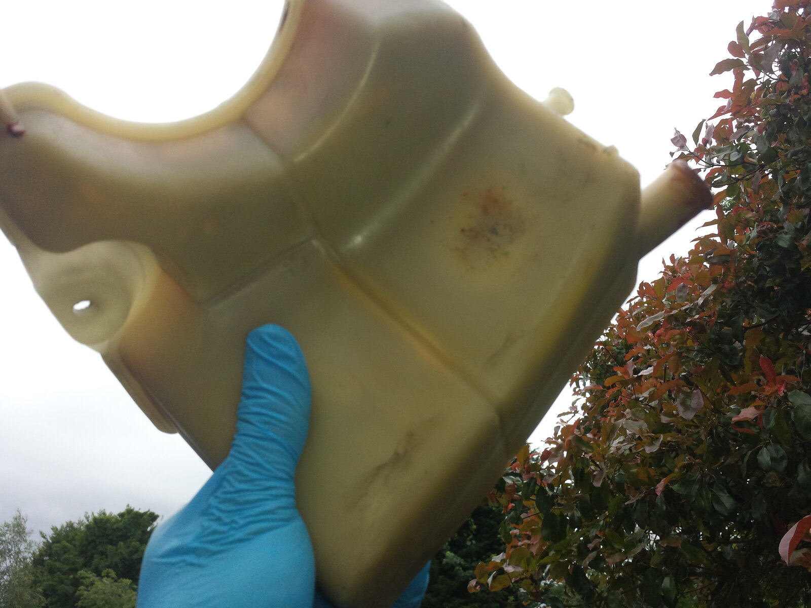

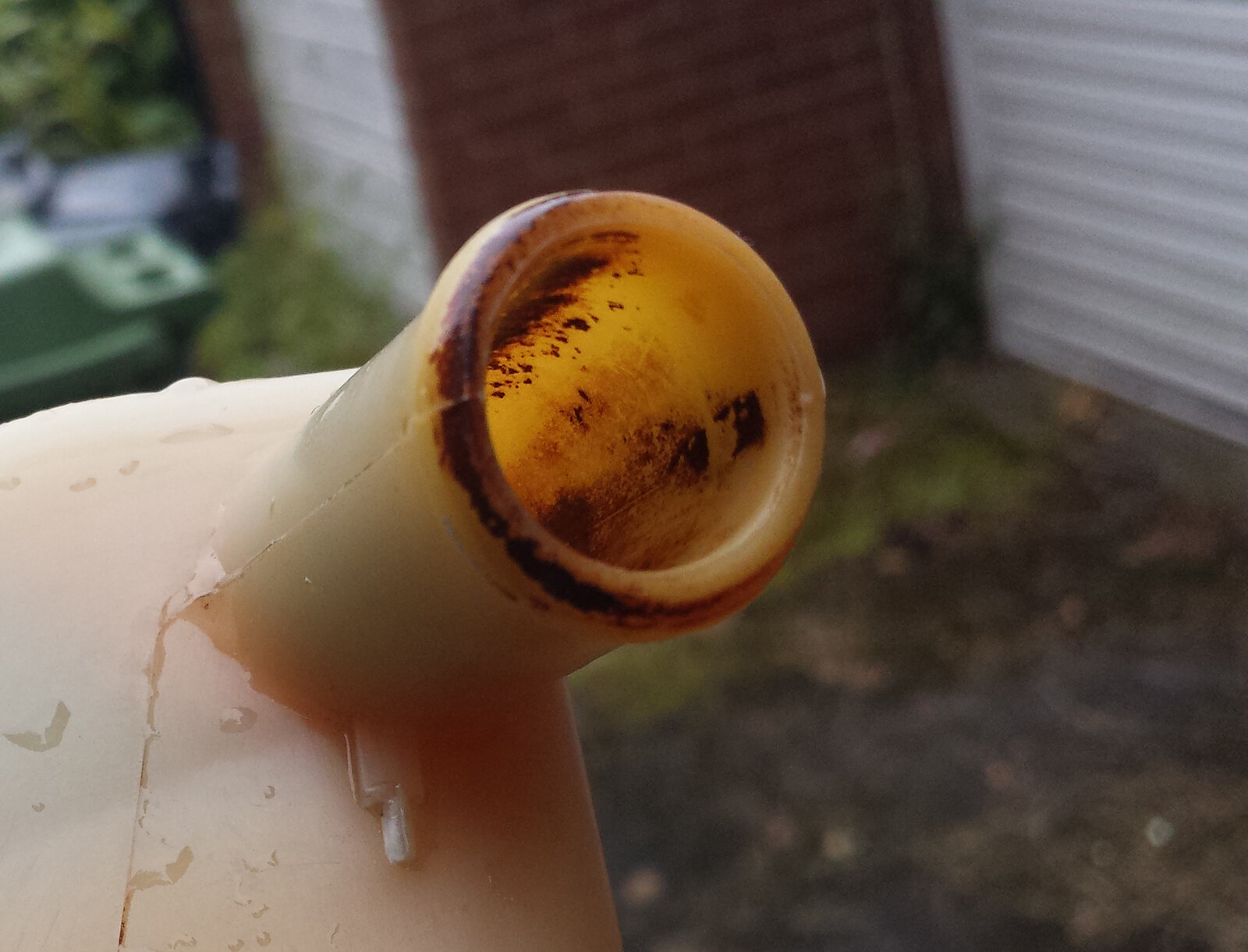

After:
I used the method of putting some gravel in and shaking it to get all the solid crap out. It took a while, but I think worth it.
After all that, I'm sure the car is much better at cooling. It seems to take longer before the fan comes on when coming up to temperature. Which seems to suggest the radiator is being more efficient. The fan also seems to use half speed more often. But I did not take any measurements so it could be psychosomatic.
Ye gods, the cooling system should never get as bad as that.....I’d guess there hasn’t been any antifreeze in there for years!
