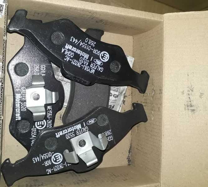

The next thing is the front brakes. Thanks to a really good ford deal I ordered some OEM pads and discs for much cheaper then OEM equivalents at any of the usual stores.
They arrived today and I was slightly miffed how the pads were packaged, but....having not ordered parts like this before, I was not sure what to expect in terms of packaging.

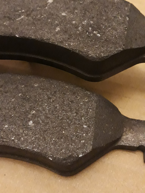

They came in a box like this, I assumed they would all be packaged a bit more cushioned and protected....but no.

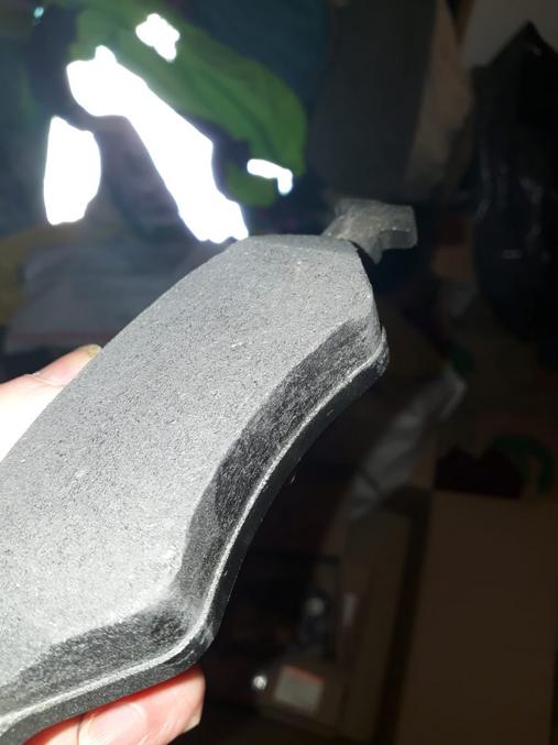

My only concern is that some of the edges looked, perhaps, slightly chipped.
You can see here the bottom edge of the lower pad seems like it has a bit of a edge chip.

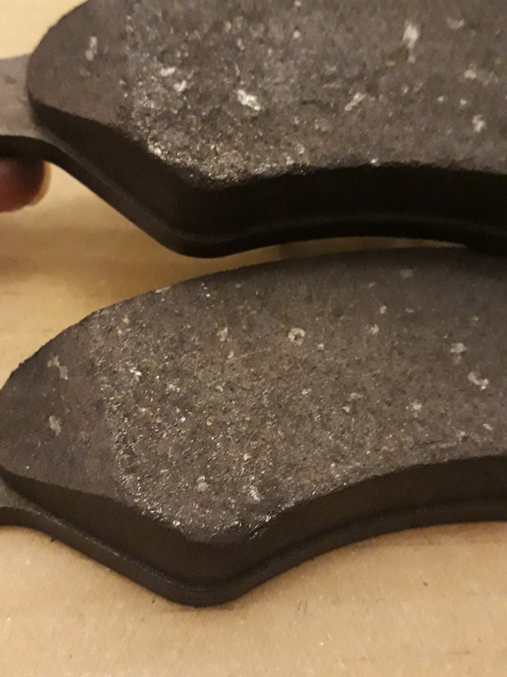

A few other pictures, but the one above shows the issue best I think.
Screenshot 2026-02-07 at 00-01-12 WhatsApp.pngScreenshot 2026-02-06 at 22-04-13 WhatsApp.png
My guess is that they are fine, as long as the main pad surface is not damaged. Thought I'd check though.
I wouldn’t be worried about fitting them. I grind much more than that off of them if fitting to used discs to clear the lip.
Fairly unorthodox packaging but so long as they are genuine Motorcraft the chipping can be ignored. Did they come from a Ford dealer?
Has your Ka the single solid front disc?
John :)
yes, genuine motorcraft, direct from the ford shop. It was the full front kit. This Ka actually has vented front discs. So do most of the examples i've seen on youtube how to videos for this model.
It has drums on the rear though.
Seems odd they were not packaged better, you have to be careful these days as there are lots of counterfeit parts around online.

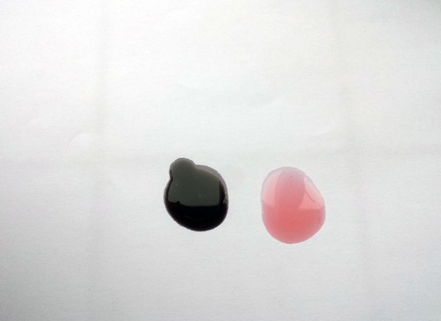

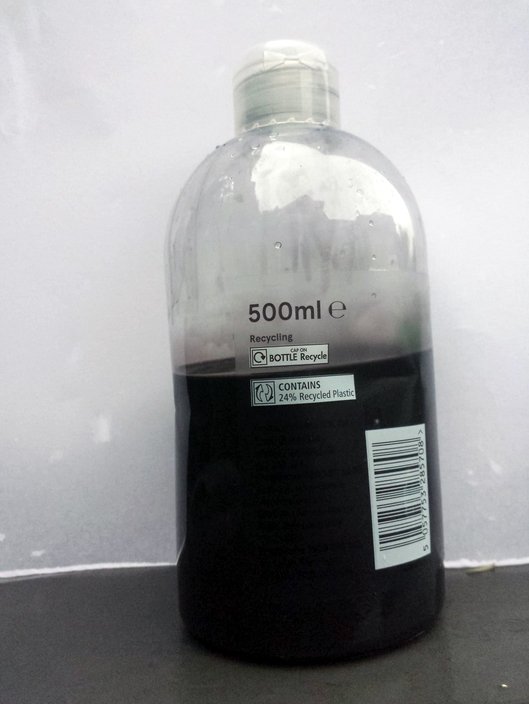

Finally got round to doing the power steering fluid.....and it looked very old.
Jet black, smelled bad.

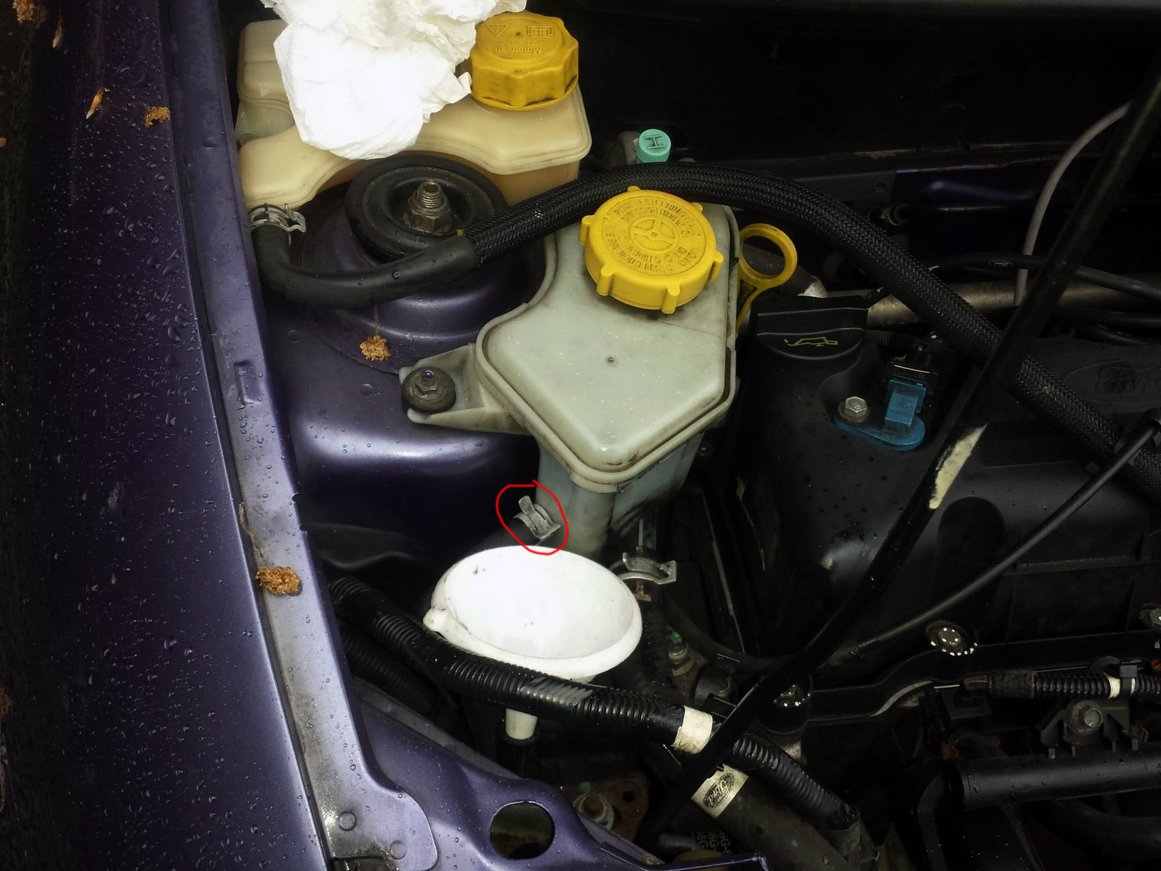

I used the manual method and disconnected the return pipe to the hopper and manually turned the wheels on jacks while adding fresh.
It took nearly 2 litres before it started coming through mostly red.
Probably not the most comprehensive method, but it got the job done.
Yeh, the colour was bad.
It was a bit more of faff (as it always ends up being), as I was basing the procedure on similar era fords (mk5 fiesta etc). They all seemed to have a point on the return feed that could be easily split with a lot of flex and play.
This was not the case on this KA. It was all very fixed in place, no slack. The only point I could see that had some kind of connection did not look like it would be easy to split.
So, option B was to disconnect the return at the hopper. But even then, there was pretty much zero space or flex in the hose.
So at that point it all got bit heath robinson, and I connected a funnel to some washing machine hose, fed that through the engine bay to a container, jammed the funnel in as close as I could and then just....just had enough bend on the return hose to guide it into the funnel.
I had to enlist someone to physically bend and keep the hose pointing into the funnel.
I emptied a lot out of the hopper first using a clean soap dispenser, filled it with fresh and then kept turning the wheel lock to lock until it ran red (ish).
As you can see, the fluid extracted from the hopper was jet black.
Old and new fluid. Even the smallest drop is still jet black, no translucency at all.
I flushed through nearly 2 litres. But, I have a feeling I could have done lot more. After since running the car the fluid looks more like a dark red. But, it's still maybe 90% flushed with fresh fluid, so much better than it was.
I'm sure the steering feels lighter too.
They’re going to spend their life being covered in water, salt, baking at several hundred degrees and being banged around a brake caliper bringing a couple of tons of metal to rest; they don’t need mollycoddling in the box, don’t worry
Every set of boards I’ve bought recently has been shrink wrapped in plastic and roaming loose in the box- the shrink wrap doesn’t add much
Even OEM are purchased from a pad/disc manufacturer, usually who the car brand can get a good deal from.

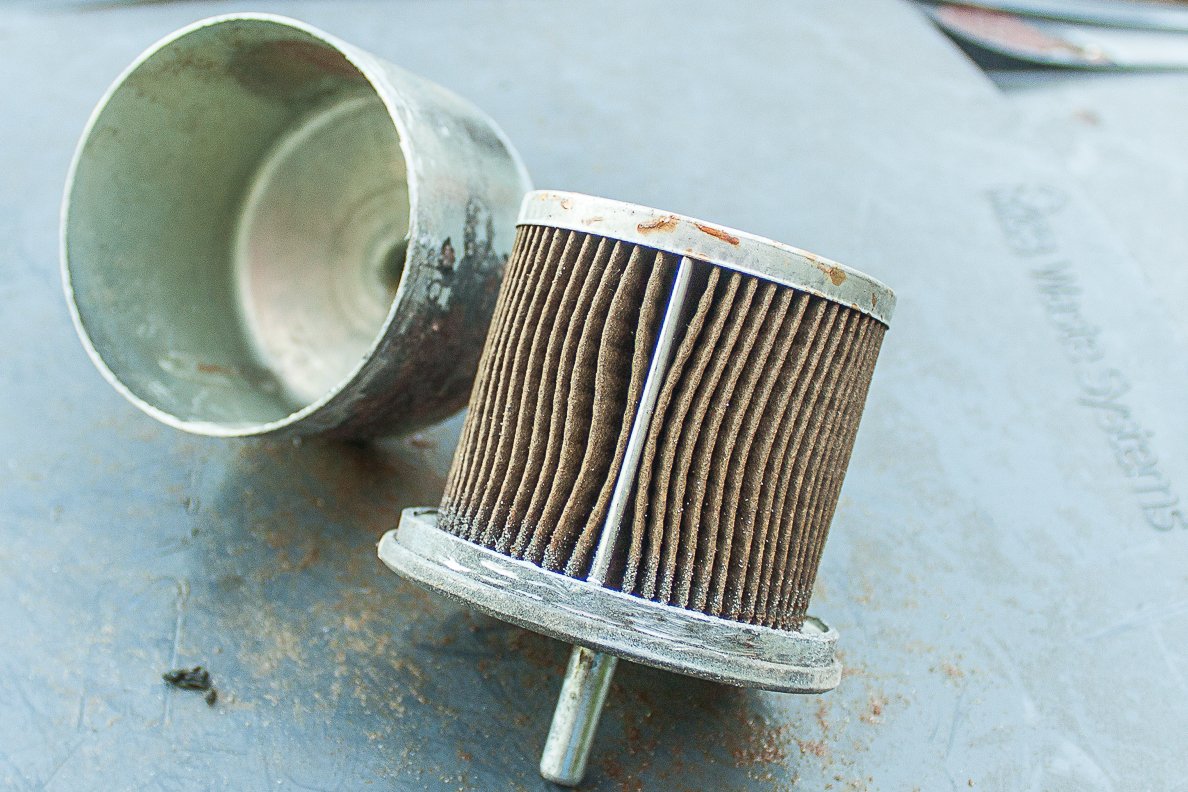

Changed the fuel filter next.
Pretty easy plug and play on this car.
From my guess, this is the original filter (although I can't see a date code), so it is about 17 years old and 50k miles. Once I have flushed it a tiny bit I am going to crack it open and see what it looks like.
Disagree. All parts labelled as o.e. or with the company's brand will have been tested and approved by the company which takes months and a lot of cost. Technical depts will not test "new" compoinents for old models simply at request of spares division because of cost and time, plus they are working on up-coming developments. They would need an existing supplier to stop supply - or a massive cost/quality problem - to undertake this.

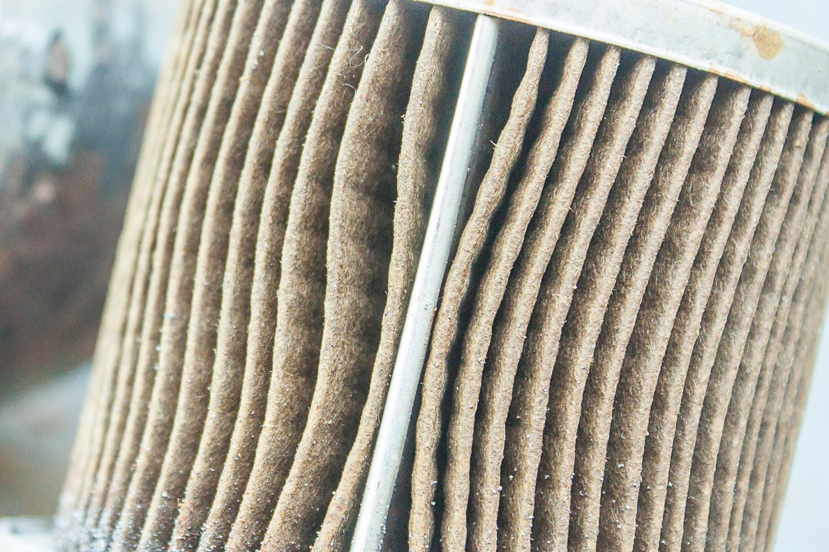

Cut the filter open, and was pleasantly surprised.
Filter seemed to be in pretty good shape for (potentially) 17 years and 50k miles.
It looked dark/black initially, but has lightened somewhat now it had dried out a bit.
I have also increased the exposure somewhat to see more detail, so it looks much lighter than it does to the eye.
I might unfold the pleats to see in the light, as it might be more dirty than I think it is.
But still interesting. I imagine it was still doing a good job at filtering. The material is still very much intact after 17 years.
This car did get to 9 years of it's life with ford garage servicing, but nothing to indicate the fuel filter was changed in that time. But considering the condition, it's a possibility.
edit: According to ford serving for this car, the standard interval is 4 years. So in theory it's had at least one change. With another chance to change perhaps 8 years ago.
I’ve had filters look OK but seemingly cause problems by breaking up and having filter fibres block other aspects of the system. These were online filters from 2 stroke engines in power tools, subject to a far worse time, mind— a trench wacker being the first that springs to mind, the inline filter fibres completely blocking a fine mesh screen within the carb
Perhaps change intervals for filters are intended not solely to remove dirt from the system but to also ensure the filter doesn’t degrade to a point where it becomes a problem itself
