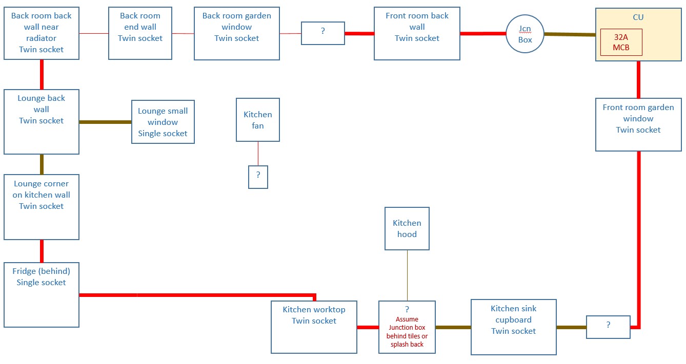

Found 1.5mm wire in my ring :(

If your outbuilding CU has spare ways, and it's easy to get MCB's for it. Have a ponder if its worth having 2 radials instead. (break the ring).
16A MCB for your circuit which contains 1.5mm
20A MCB for 2.5mm circuit.
Only worth it, if you would have high loads off the 2.5mm connected sockets.

Some of the 2.5mm sockets are running through a kitchen space, microwave, oven fridge. (Hob is on a separate feed) so I think this needs to be kept as a ring if possible with 2.5.

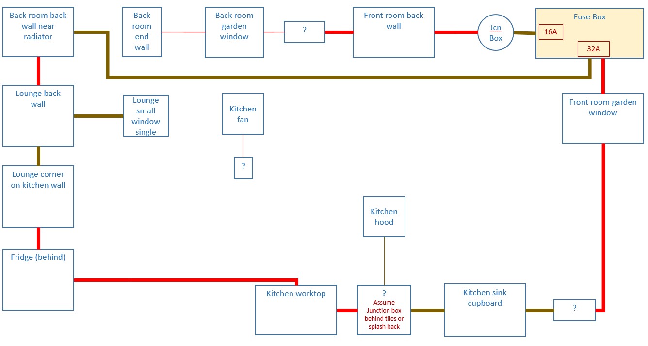

So this might be a good solution- I could split the ring into two halves, the side with 1.5mm can have a 16a MCB. With the current infrastructure it would end up with 1 x twin socket on 2.5, after which 2 x twin sockets on the 1.5. (low load sockets, in all probability lamps, phone, chargers, perhaps the odd laptop)
The other half I could run a new 2.5mm back to the CU (there is a relatively easy route for this), and make it into a 32A ring to carry the rest of the sockets including the kitchen appliances.
Is this plan allowed/acceptable?
Sounds like a studio appartment to me. can you do a rough sketch and post it here?

I see. More of a house, than an outbuilding. (I was thinking it was more of a shed/summer house)
For 19 years it has been a granny annexe. Granny no longer needs it, so I'm reworking it into 2 bedsits with shared lounge, kitchen and wetroom.
I've added 2 x partition walls which contain new wiring and ring. But I've only just discovered the issue with the old ring.
Hello, I made a diagram of the wiring. Colours and thickness are used to portray old/new cabling and difference between 2.5mm and 1.5mm.

Replacing two of the lengths is proving to be difficult without a lot of collateral damage.

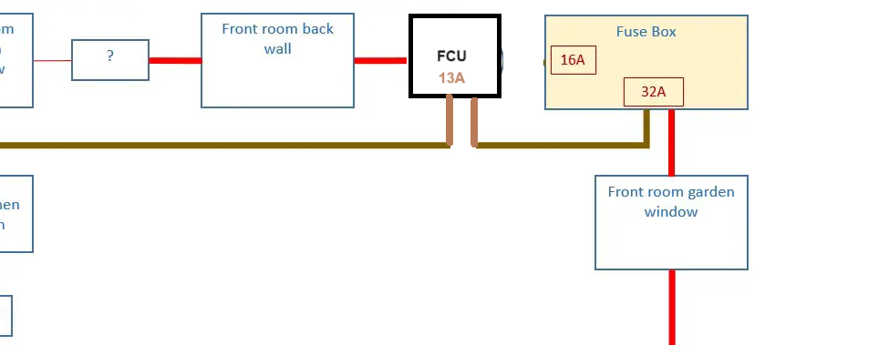

Current best suggestion from AndyPRK I think is to convert to a 16a spur for the thin wires I cant replace, and add a new return to make the rest of it a proper 2.5mm ring.

For you, best option seems a 20 amp MCB,
You wished to retain the spare way Would this work
