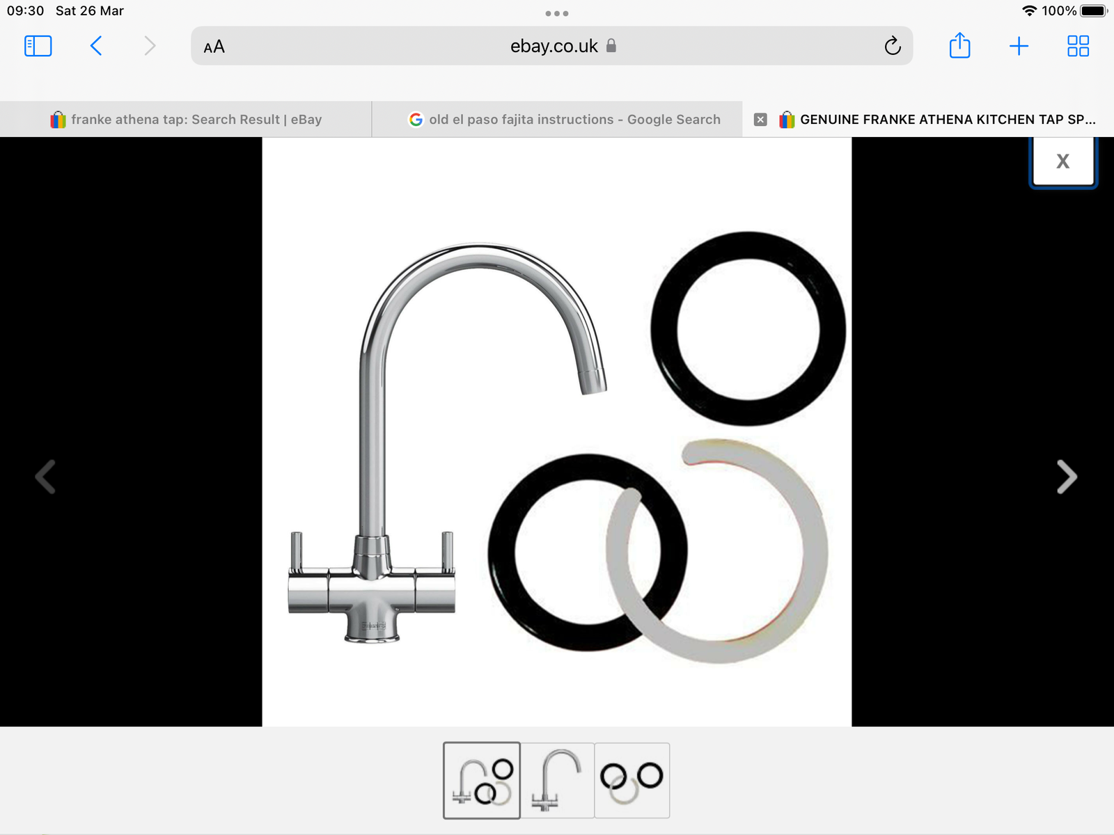

Hi, The spout has become so stiff to turn that it sometimes turns the main pillar with it. I have undone the securing ring and tried to pull the spout out to clean and replace the o rings (which I understand is the procedure) but it seems firmly stuck. Is it just a case of more brute force or is there some other trick.

Oops... You are correct, it does say that.
It looks like the plastic ring is at the top, above the two o-rings. I wonder why a grub screw isn't mentioned in the parts list?
Edit------
I can still not find anything else that mentions a grub screw...
https://www.amazon.co.uk/Franke-Ath...prefix=franke+athena+tap+oring,aps,251&sr=8-1
In the above, they recommend removing the retaining nut and simply lifting the spout out- as per the video that I linked to.
I suspect that the official instructions are wrong. I can't recall seeing a tap with a retaining nut AND a grub screw.
I guess the OP can use a mirror or their phone to see if their is a screw at the back of the body.
Thanks for all the replies, I’m sure there’s no grub screw as I have looked all around and other web sources confirm no screw on this type - there’s even a YouTube on it. I think I need something to get rid of limescale etc. inside the housing and am trying to drip some de-scaler in. Let me know if this is a bad idea!!

For anyone experiencing the above issue with removing the spout from an Athena model Franke tap, it has already been said on this thread but for clarity here is what I found.
It's true that it seems like there is a retaining screw, as even with pressure the spout does not seem to pull out. However it is DOES just pull directly up and out! This is not because of limescale or anything other than the lowest rubber o ring rolls out of its groove and gets jammed as you try to pull the spout upwards. I had to stand up on the work top and pull directly upwards with all my strength to get it out.
Once out, you can replace with new o rings and ideally apply a tiny amount of silicon grease to the them, which will mean the tap moves nicely and doesn't churn up the lowest o ring so easily (plus it's easier then to remove the spout next time).
