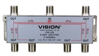

Well done on your choice of ATV for the aerial gear. They're good guys. I like too that you've bought decent cable. If I understand correctly, your splitter is passive (no mains power) and maybe looks something like this, would that be correct? If so, the advice with all passive splitters is to locate them as close to a mid point between all the TVs as possible. IOW, long lead from the aerial to the passive splitter, then shortest possible lead lengths from the passive splitter to the TVs. This will give you the strongest signal travelling down the long line, so better able to cope with the reduction in strength. You'll then have the weaker signals (reduced by 12dB from the splitter) travelling along shorter length of cable which means they won't lose quite as much due to the cable losses.

Thanks for your kind words and awesome explanation, Yes that is the very splitter I have bought, I will give this splitter a go first and put it as close in the attic as possible before the cables all go their different directions, I will then monitor each tv in turn, If I get problems with the picture or miss a lot of channels, I will try the masthead amp as suggested, I will keep you posted, thanks:), I was trying to find a more accurate signal meter. like the analyser types as I'm sure you guys use, but they are all very expensive, in the high hundreds up to a grand in price!, not a good investment for a job I am most likely only going to do once I think:LOL:.

Hi all, one last thing, Forgive me if its a daft question, but I noticed on the 6 way splitter it has two screw terminals on each side,what exactly are these for?, Earth bonding maybe? I have a cold storage tank in the loft with copper pipes that are all bonded, so I could bond the splitter to this (if that's what the terminals are for?), what exactly will this achieve, is there any point?

Where a splitter is used in a block of flats or some other multi-dweller building then earth bonding is a legal requirement. It helps to protect the residents/users from any potential stupid act by one of the other users.
In a domestic setting the benefits have to be weighed against the risks.
Your home's electrical supply is protected by a fuse box. Maybe it has RCDs. Chances are then if 240V mains did find its way up an aerial cable then that whole circuit would trip out. That would protect each room in the house from the others. I don't know if Earth Bonding would offer any extra protection in that situation.
The con is the increased risk of a lightning strike. A bit of metal sticking up at potentially the highest point on a house is a risk on it's own. Most electrical items are now double earthed, so theres no direct path to earth via a mains plug. Adding a juicy fat route to earth via Earth Bonding a domestic aerial system might be just what an electrical storm is looking for as a discharge point. If there's no other structure higher that is also earthed then there's a risk you could be looking at fried electricals, building damage, or worse.
Personally, I wouldn't earth bond a domestic aerial system without a very good reason to do so.
I disagree. With a multiway splitter feeding several sets there is quite likely quite a bit of leakage which can cause a nasty tingle.
I don't think it would encourage lightning either, lightning is such a high voltage that the insulation provided by an unearthed aerial is neither then or there. But to be safe fit a lightning arrester, earth the aerial via a heavy lead to an earth rod.
In many countries it is mandatory to earth aerial systems.
