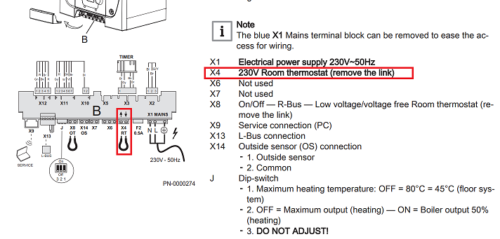

hi all
just a quickie, baxi 224,
i need a RF room stat with timer /clock a 24 hr or 7 day timer,
what connections will i need to make, the old RF room stat we had on our old baxi 24he
it is a 2 wire type,
also i have notice the DHW takes a while to come through hot,
i have the install guide and the user guide, it sort of contradicts itself,
thanks ,

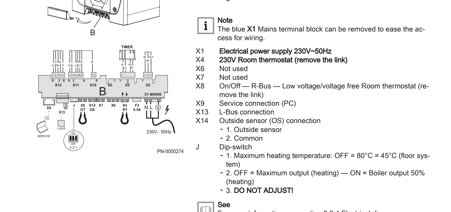

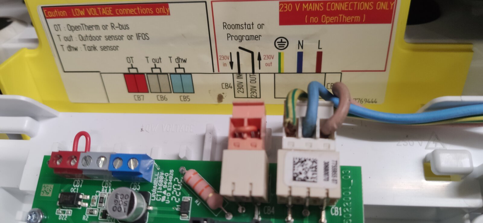

The little red link in X4 is removed and the two thermostat wires connect to the two vacant terminals. The little drawing on the boiler shows the switch of a remote thermostat.
Some thermostats are battery operated in which case the two wires are all you need, but if the thermostat requires a 230V mains supply to provide it with operating power then that comes from the same source as X1
