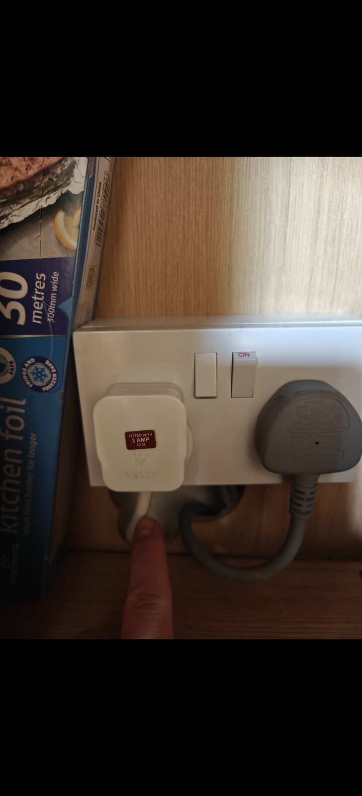

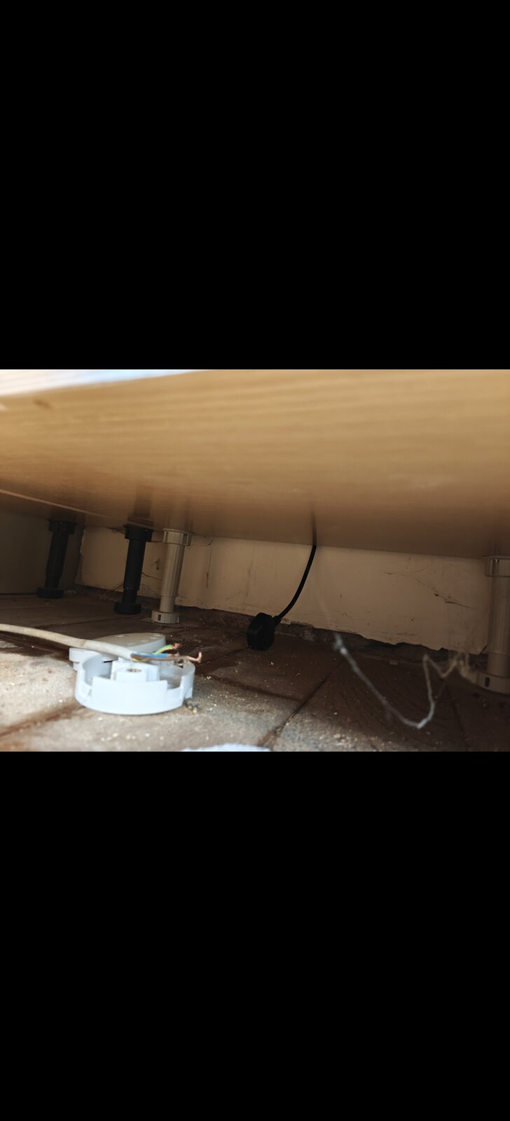

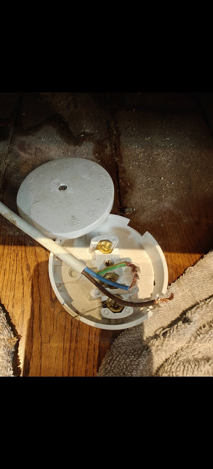

Hi All
I'm looking for some advice. I broke my old integrated fridge freezer chiseling out ice - school boy error!
The old appliance was connected into a round junction box which in turn was plugged into a double socket (pictures attached).
I understand I shouldn't cut the plug off the new appliance as this will void the warranty. From searching the web I'm unsure whether I'm ok installing a single socket with back box which I'd screw into the shelf underneath the fridge freezer. An alternative looks to be a trailing socket.
Any advice would be appreciated!
Thanks, Pete
Nonsense.
Whichever you want.
Or a modern junction box with cable restraints or another method of securing the cables.

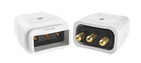

One of these 1756900034099.pngwill get around the problem of not cutting off the plug, but many refrigeration units are very voltage critical so common for them to say don't use an extension lead.
Even my inverter drive fridge/freezer and freezer still say don't use an extension lead, even when they can work with a huge volt drop.
