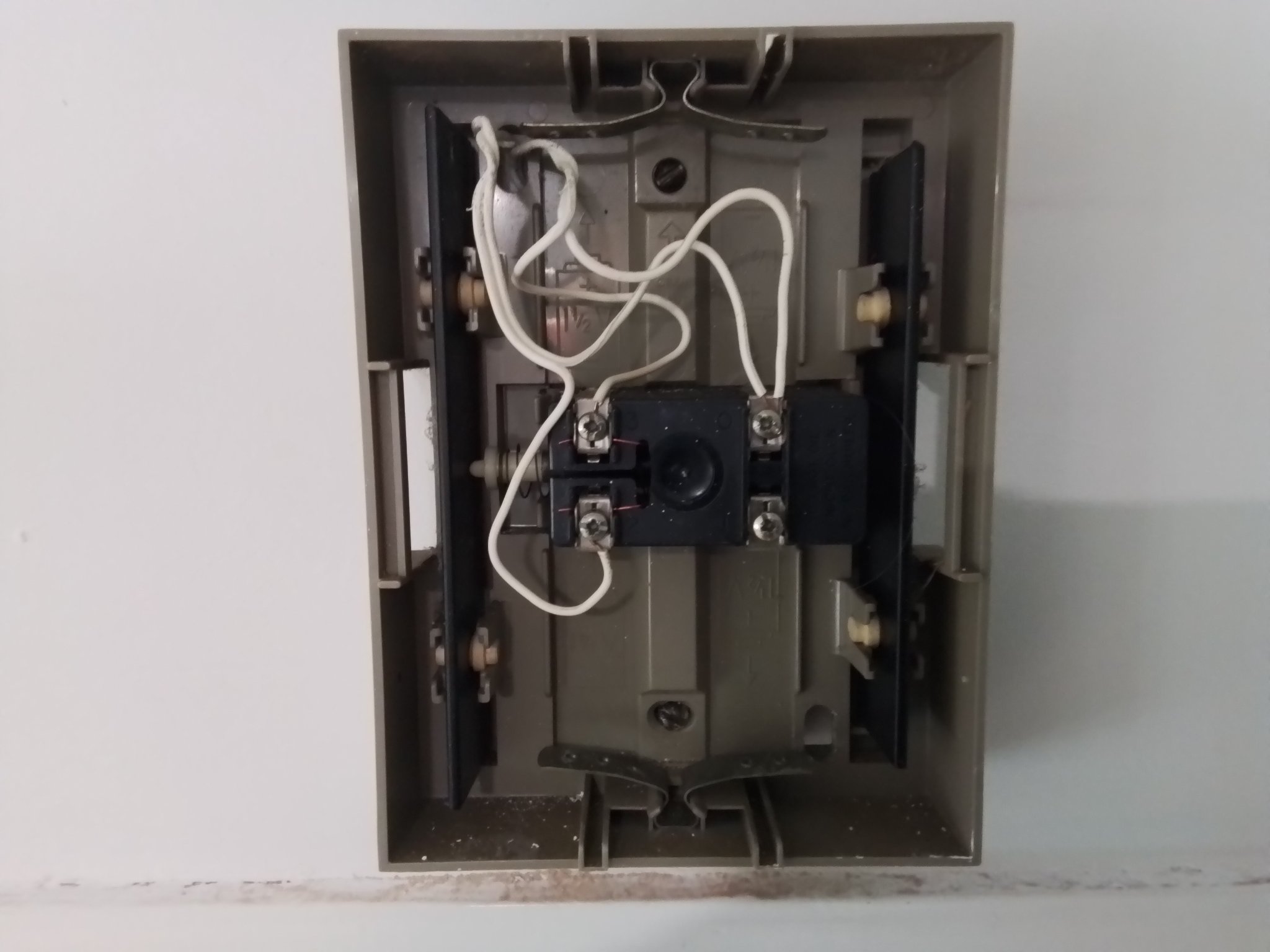

My friedland door bell, powered by a transformer in my consumer unit has stopped working. The transformer used to hum but now no sound. I'm waiting for an electrician to test.
The door bell unit has space for batteries. Can I use batteries and leave the transformer out of the loop?
I have tried connecting one of the twin wires to connection points 0 and 1 but no joy. Also tried the same with the other twin wire.
I am assuming that if I want to use batteries only, then the wiring would need to come directly from the bell push and not go via the transformer. Is that correct?
Thanks.

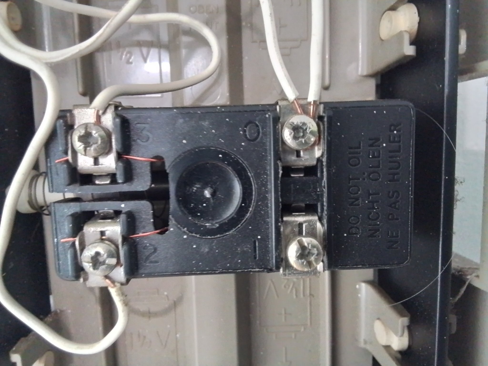

Yes, can use batteries, but you need to work out which wires are which. You have two cables, one from the bell-push, the other from the transformer, both look the same. So one pair of wires will no longer be used, and the other pair go to 0 and 1. The 2 and 3 terminals have no external wires to them when using batteries.

The 0 terminal is at the moment used to link the door push to the transformer, and either 2 or 3 goes to the door push and the other goes to transformer, and it does not matter which way around, so nothing to identify which pair is which.

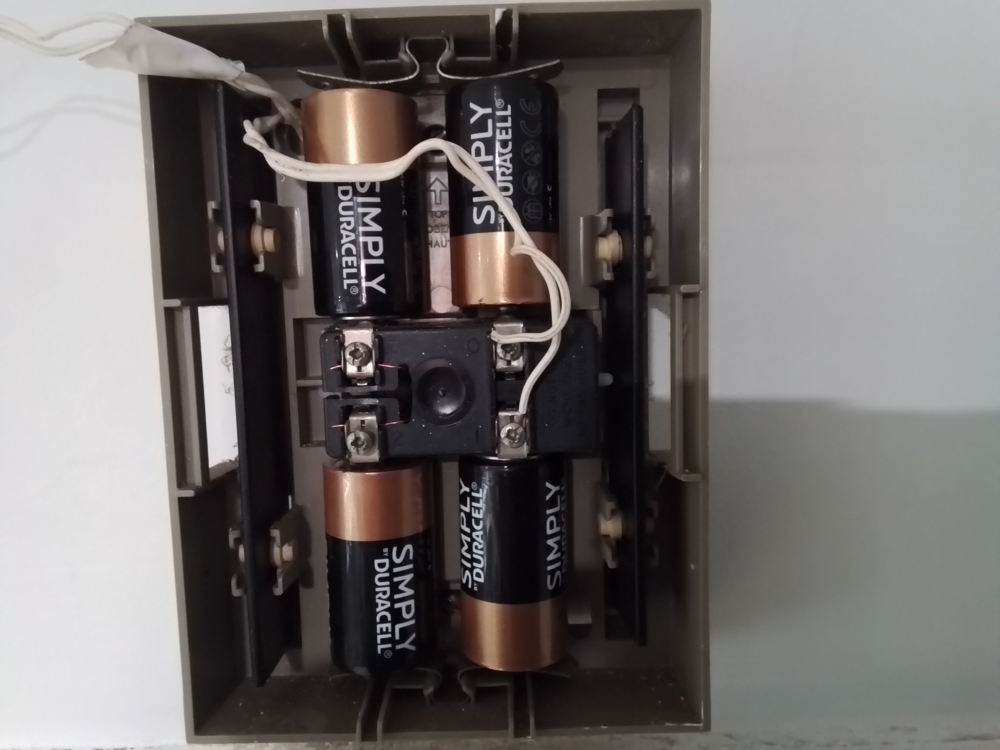

I have just tried connecting one pair to 0 and 1 (left the other pair unconnected) and then tried the other pair to 0 and 1. I guess the second pair must be from the bell pusher because the bell chimed a few times when I was wiring up.
Unfortunately though the bell pusher on the front door still does not make the bell ring.
Very confused!

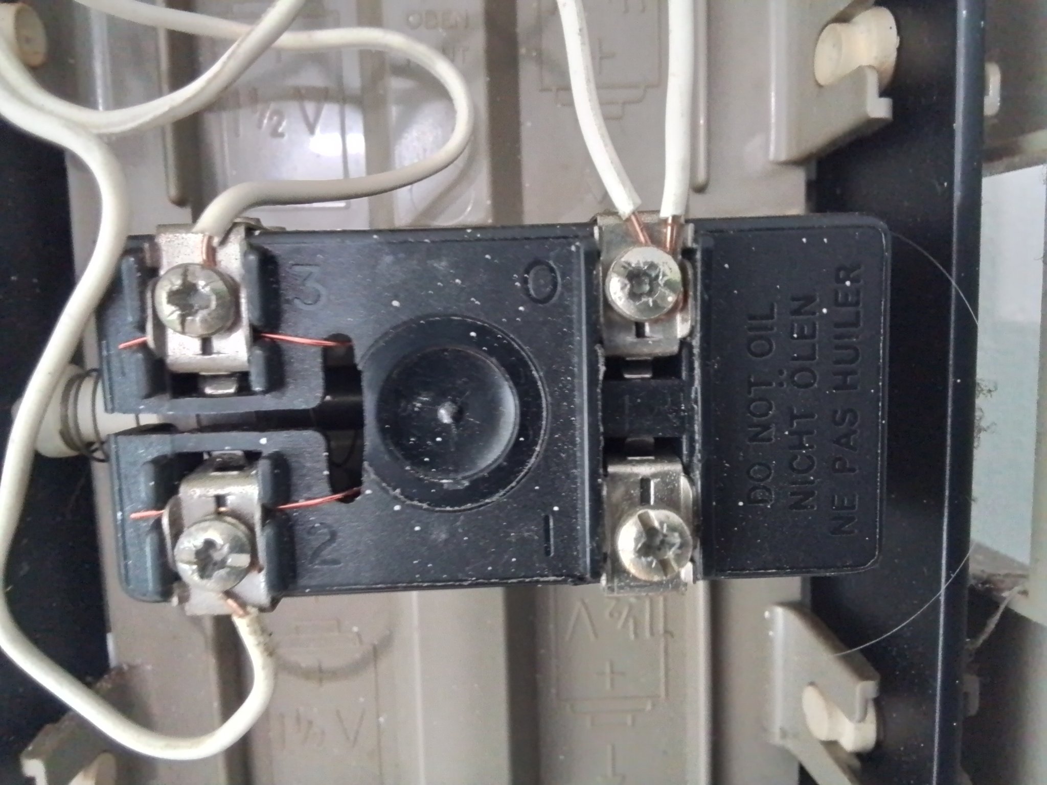

Here is the second pair (from the door bell wire I guess).
Any help greatly appreciated.

Oh my goodness!!! I have just tried to connect the pair that I thought was from the transformer to 0 and 1 again and the bell now works!!!
We have been quite a while without a bell!
Amazing, so grateful to the replies and help. THANKS!
