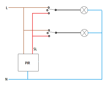

My electrian and me are still debating to go with built in pir of seperate pir sensor.
He prefers a built in sensor and im not sure and i want to lights to come on at the same time.
Can you recommend a exrernal sensor to use?
Also, he still advises for two seperate siwtch I'd need two seperate pir sensors

Thankyou, I'll show the diagram and see what he says.
So just to confirm, this set up will
Allow two seprate light circuits on two seperate switches to be to turned on all together on one pir sensor. (I'll have to turn both switches on at the switch)
And should i wish to turn off one circuit whilst keeping the second curcuit on, I'll need to do switch the it off at the switch.
The circuit shown has a three-position switch where each light can be ON, OFF or AUTO.
Your electrician has probably never used a three-position switch. He will probably put in a two-way switch. In that case, you can have ON/AUTO, or AUTO/OFF, with small modifications to the circuit.
I think the auto/off sounds ok if he was to use the two way switch, with the assumption that switching on and off multiple times will cause the lights to stay permanently on?
