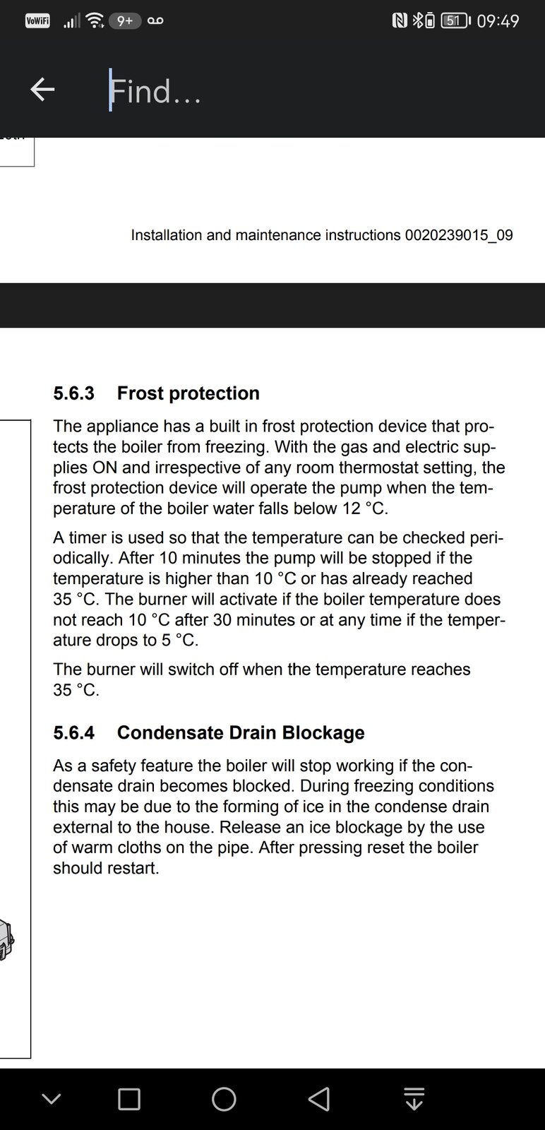

IIRC vaillant internal protection brings pump on (not flame) at <12°C

Does say minutes not seconds!
So, maybe you have another issue.
Call them up and maybe get them round.
