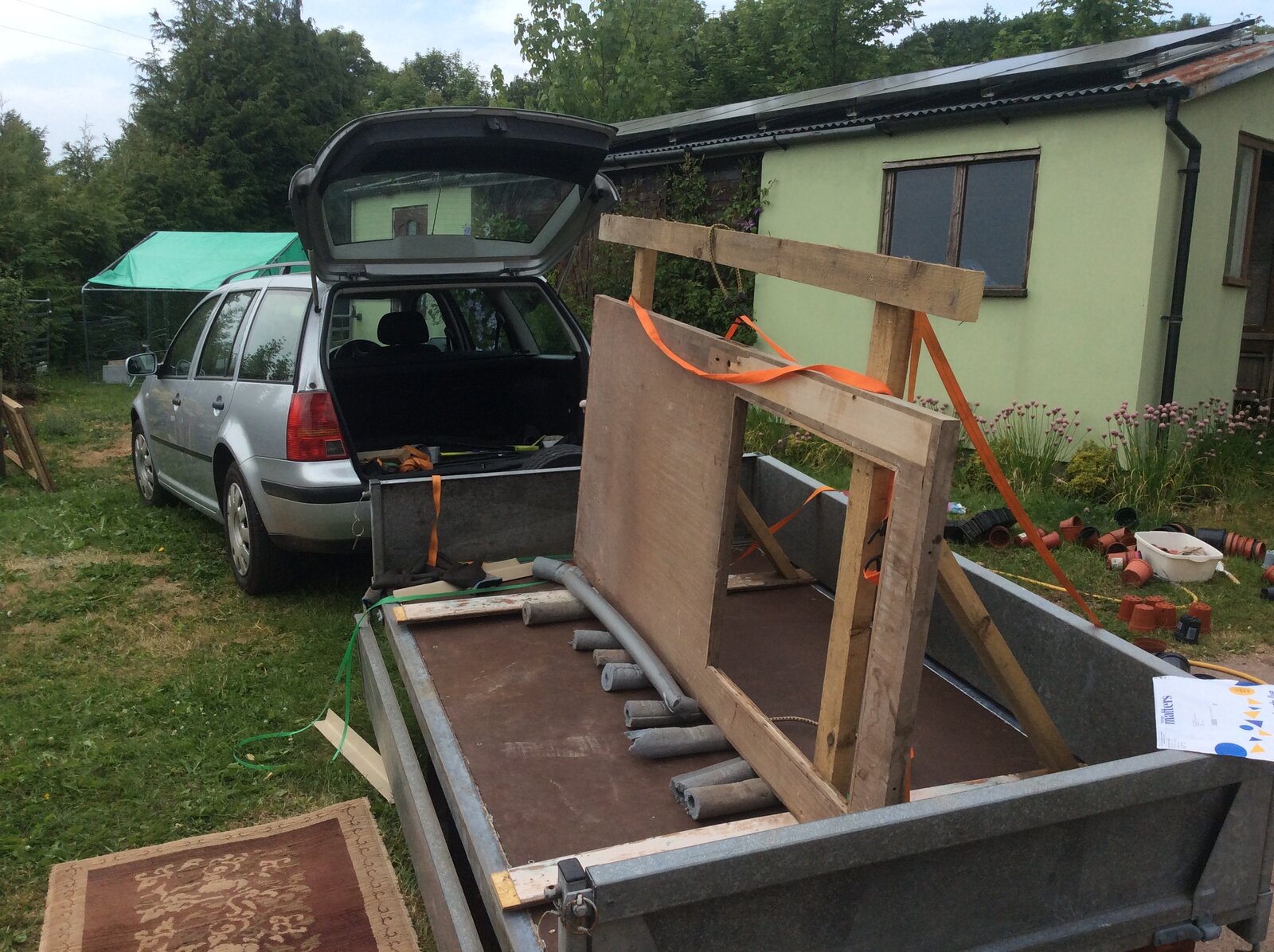

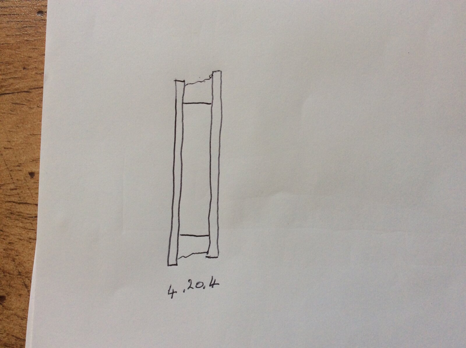

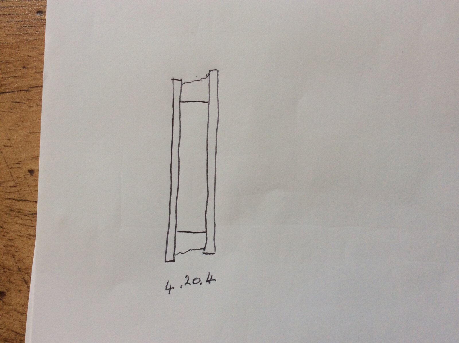

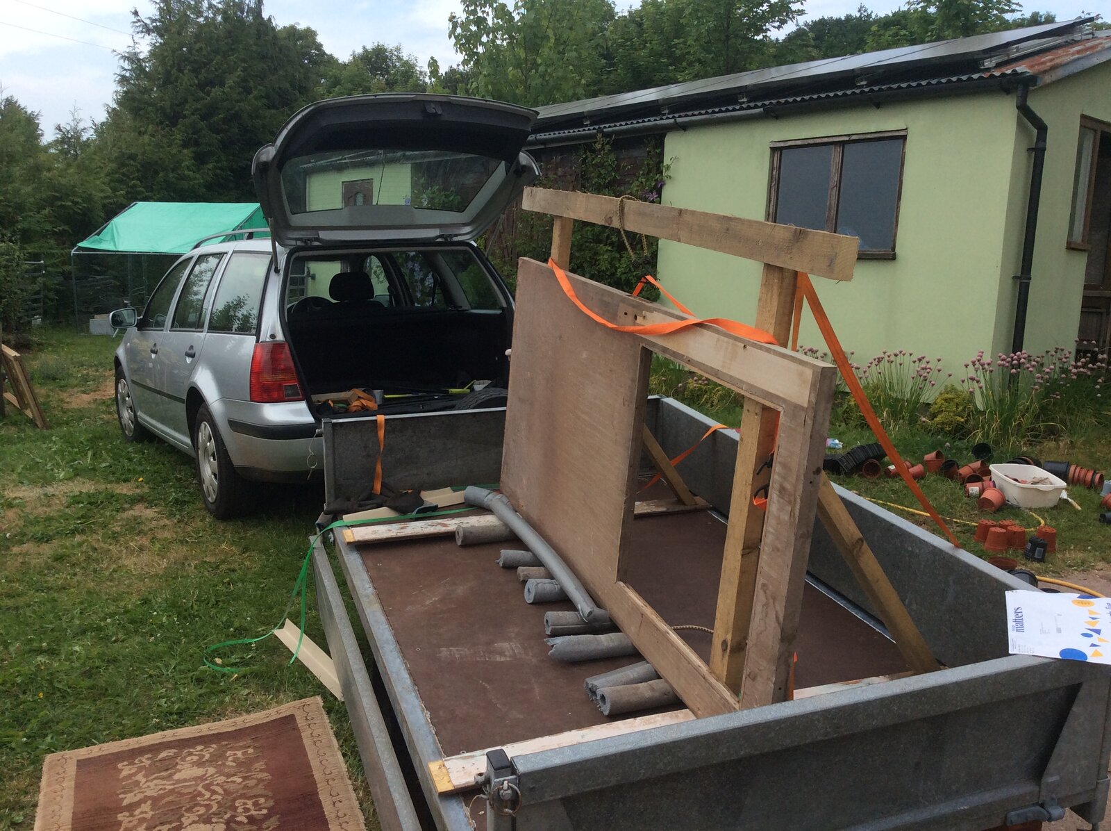

Some places its just inaccurate cutting , one I had done the one sheet was 5mm bigger both way. The last glass place told me to make a rack with a slope leaning back from 90° to transport them so I looked it up and did it at 4° . So with this heat could they slip back square on the packing or will the sealer have fully gone off.
